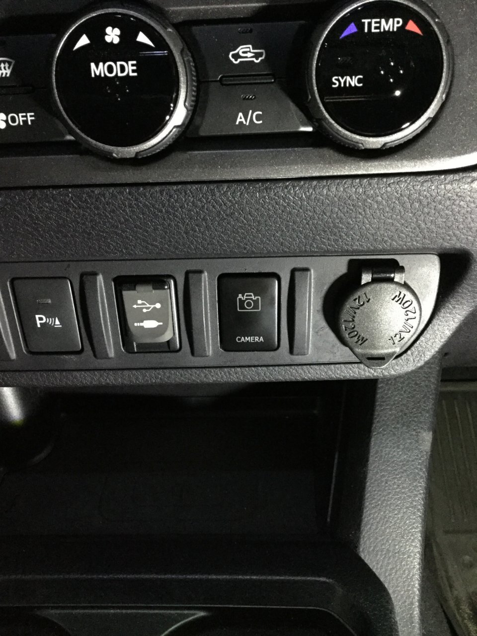

    I have the anytime backup camera and front camera on my 16.
    Love it and have no issues with the camera that came in the kit.
    I put the switch in the spot for the backup sensor that I never use.
    That puts it in the center of the switch cluster under the climate control.

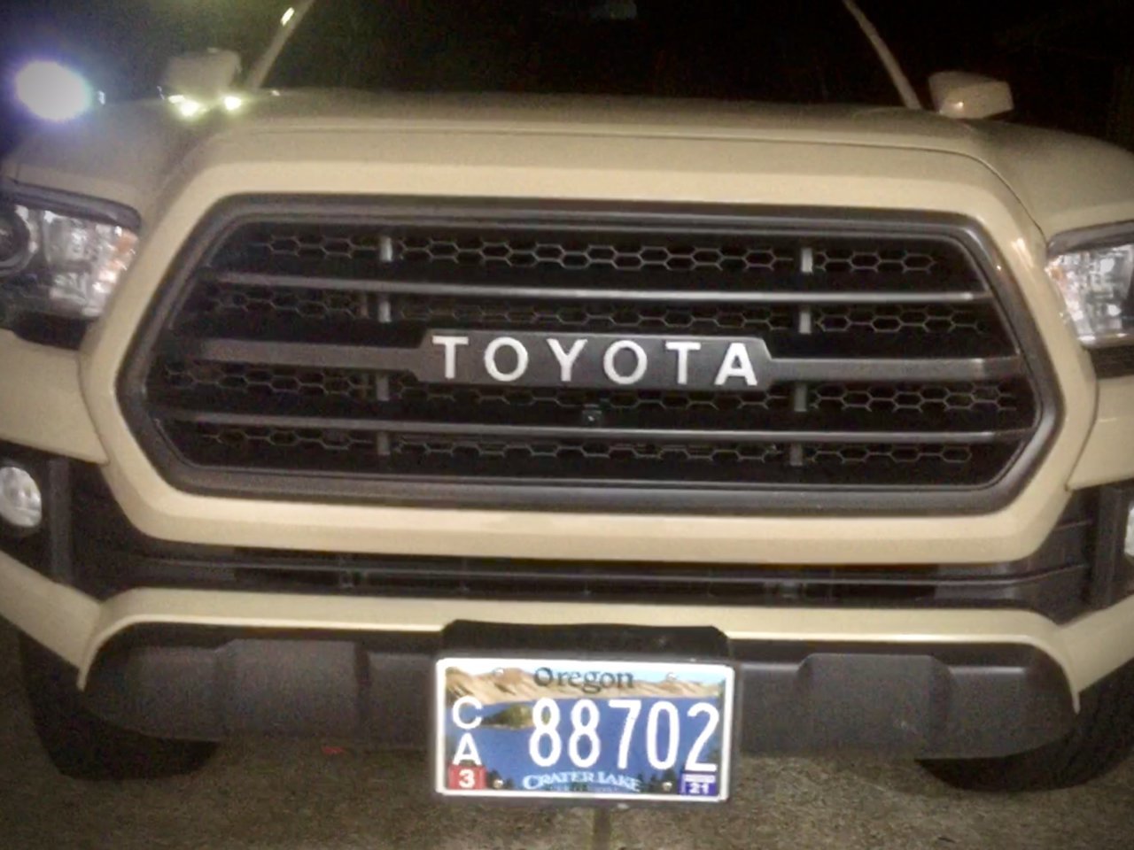

    Welcome to the forum, this is one of the easiest mods to do if you have any experience with auto wiring. The threads listed here will provide all the guidance you need. My camera is mounted below the Y and O and instead of running wires through the firewall I installed a wireless transmitter and receiver.

    where did you get this wireless transmitter and receiver?
    Eddie1958 likes this.
  9. Aug 17, 2020 at 9:27 AM
    Captqc
    Captqc Well-Known Member
    Mar 5, 2017
    #212458
    5,163
    Tigard, OR
    2017 Tacoma 4x4 TRD AC Off Road
    Fry’s Electronic
