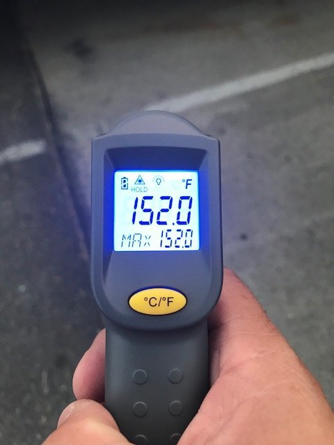

    I was searching around for normal operating temperature just now and stumbled on this thread. I just recently regeared to 4.56. Still breaking it in so I'm babying the truck for now. Here's my current temp, I was told by my installer that this is hotter than normal.

    #122158
    42,919
    That seems normal to me. I think it was @gearcruncher that had posted up a temp. chart in a thread a while back. Let me try to find it.

    harbor freight IR temp gun is needed

    Yup, that's what I'm using. I'm curious what temps people are seeing after roughly 15-20 mins of easy freeway driving to make a comparison to what I'm seeing.
