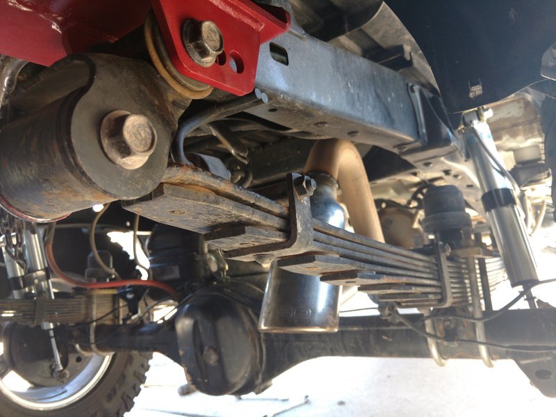

    Rear
    Ballistic Fabrication Rear Shock Relocation/Hoop and axel relocation tabs
    Bilstien 5165 (25-187762) shocks 15" stroke/36" Extension
    Collapsed Length (in.): 17.93
    Extended Length (in.): 31.02
    Travel Length (IN): 13.09
    Compression: 700
    Rebound: 2550
    Lower/Upper Mount: 5/8 inch Eye​
    SumoSprings Solo Rear Bump Stop
    ArmorTech Offroad Shackle Flip

    Rear Final Setup:
    Chevy 51" Leaf Spring
    Balistic Fab Front Hanger Relocation
    Armor Tech Offroad Rear Shackle
    Bilstien 7100 Shocks (AK7114SB05)
    Collapsed Length (in.): 19.53
    Extended Length (in.): 33.84
    Travel Length (IN): 14.31
    Compression: 780
    Rebound: 2750
    Lower/Upper Mount: 1/2 inch Heim
    Seat Covers w/ Heaters/Coolers​

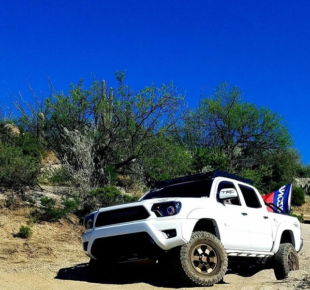

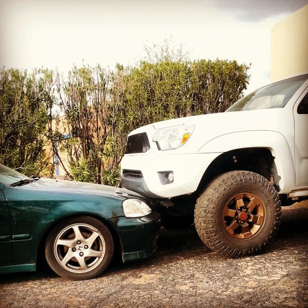

    Mod Photos as the come:
    Crushed my low hanging crossover.

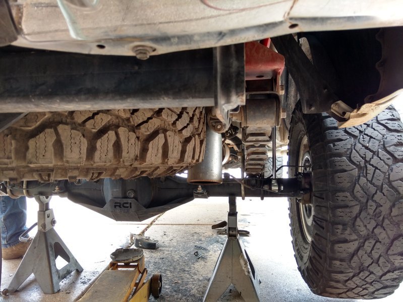

    Shackle Flip

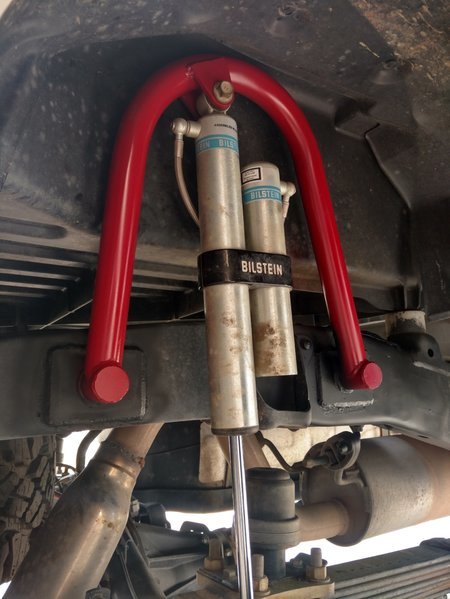

    Shock Hoop

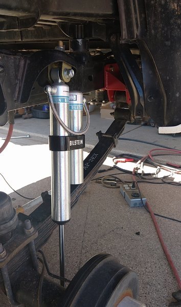

    Remote Resi Shock Install

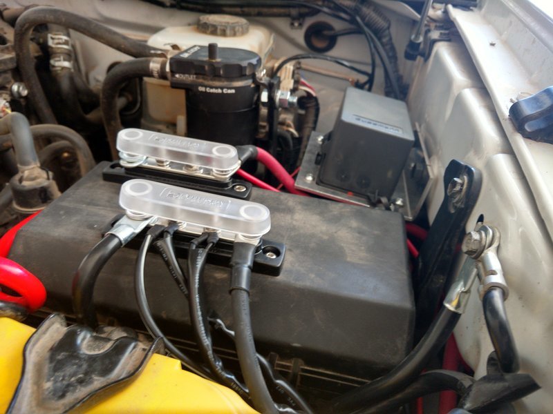

    Busssmann Fuse Bank Install with +- Terminal Blocks

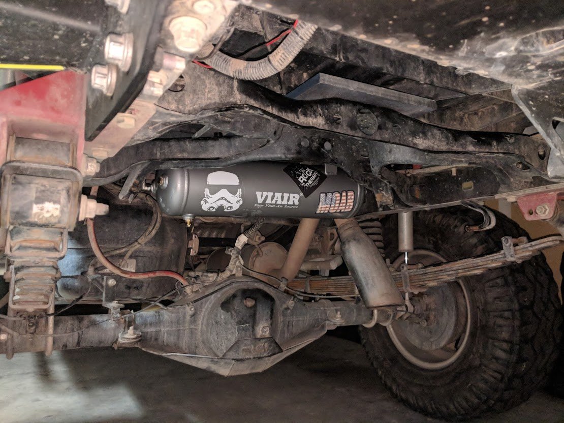

    Air Tank

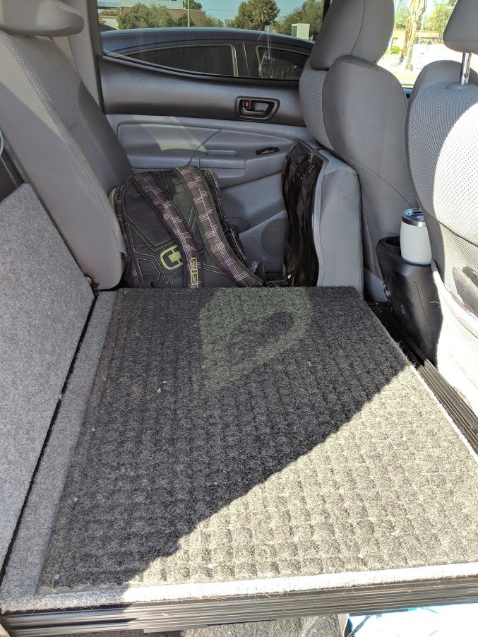

    Bench Seat Platform

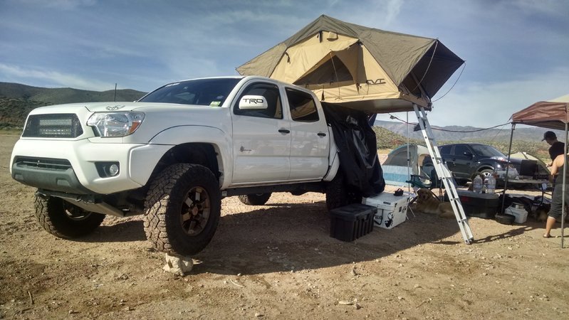

    Blow it through the roof

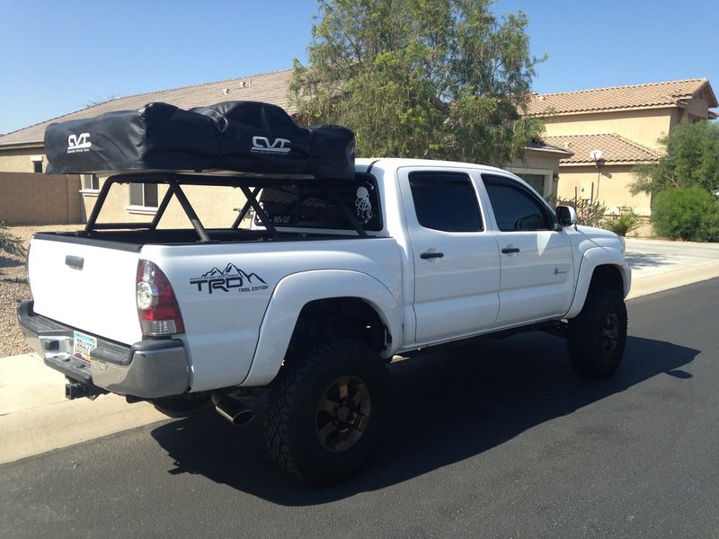

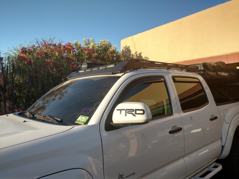

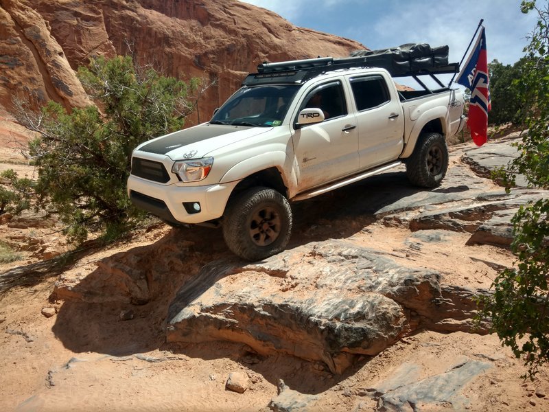

    New Bed Rack, and RTT mounted!
    Broke out the annex at country thunder
    Finally got the Prinsu Rack mounted

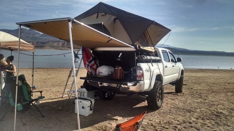

    Took trip to the lake to give the seadoos, RTT and RoadShower a workout!
    Loving this setup.

    Where did you get your bed rack from? Did you make it yourself? It looks awesome.

    Andrew @JeepAndrew (KeepersMetalFab) built it for me, I did the design and sent him the drawing with the dimensions and worked with him on building it, he did a fabulous job!

    good looking build man, why did you choose mt. batchelor over mt. cayley? Im trying to decide between the two and they seem fairly similar.

    The Batchelor is a little bit larger, I can fit 2 people plus all you gear you ever need, or 2 large dogs. The Cayley is smaller, and when I taped off the square footage on the ground to get a visual of the size, I realized just how much more room that increase in size offeres. I also dont need to over hang for the ladder entrance, in the south west, we don't get a lot of rain.

    Do you have the part number on your 5165's?
  18. Feb 23, 2016 at 1:51 PM
    #18
    WhiteNemesis
    WhiteNemesis [OP] Well-Known Member
    Apr 2, 2013
    #101165
    1,439
    Mr PattyCakes
    T-Town, AZ
    Cant get enough
    Yes sir, still haven't gotten to the shackle flip, waiting on a plasma cutter to get the bitch rivets, so I cant report on performance, yet. Should have em ready for Rock Therapy in May! But here is the list of what you need to get em mounted.
    ProComp eye to stud adapters PN: EXP 690001
    -----Amazon link Here
    Bilstein Reservoir Clamps PN: 11176015
    Bilstein 5165 Remote Resi Shocks PN: 25-187717
    -----255 Valving; Travel: 11.3" Ext Length: 27.4"; Collapsed Length: 16.14'
    ATO Shackle Flip Here
    Im running AllProExpo Leafs
    I'll post a pic of the shocks later if I can remember to grab one, they are beautiful! Still havent mounted em cuz I wanna get the shackle flip done so I'm not bottoming out the shocks, but its all sitting in a box, in garage, ready to be mounted. @JeepAndrew should be getting a plasma torch real soon and then the game will change!

    Sweet, thanks for the info man! I was wondering how you were going to run them with the shock having eyes at both ends. Looking to run expos here soon so I'll be checking in to see how yours look. Sweet build by the way!
    And I highly recommend retrofits, you'll never go stock again!
