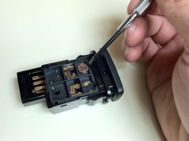

    Thanks for the help guys. I got the dash apart and now have the part in hand. There definitely is a bulb in there and now I guess I will be ordering this part as soon as the toyota online stores get back online. Everyone I go to tonight seems to be down for maintenance. I guess they all use the same system for ordering OEM toyota parts.
    In order to get the bulb out, you need a tiny screwdriver. Turn the brown plastic disc counterclockwise until it won't turn. Then use the screwdriver to gently pry the plastic disc up and the bulb is attached.

    Interesting, I bought my 2010 new and the switch has never been lit up. I will look into installing a bulb. It has always bothered me that the switch does not light up. I have already done my 4X4 switch...

    Before going through and buying the bulb, I would suggest testing the bulb first and there are two ways to do this: If you don't have a multimeter, just run two run two wires from your battery and place on the leads of the bulb (somone correct me if I'm wrong but I'm pretty sure the bulbs are 12v). If you do have a multimeter (they are cheap and save you from blowing things up, this is the smartest way to test) use this to see if there is continuity across the bulb. For those who aren't familiar with a multimeter this vid is pretty quick and painless: http://www.youtube.com/watch?v=oRhBImNYITg&feature=related Plus the accent is bad @ss. If the bulb comes back with continuity (multimeter goes to zero) the bulb is good; if once you put it back together it still doesn't light up, visually inspect to see if any part of the lead wires from the bulb are not in contact with the metal contact points of the holder...When I first took my switch apart my leads weren't touching. Hopefully this will save the trouble people buying new bulbs for not good reason. Guess it doesn't hurt to have a spare either.

    Good advice. I did the opposite though. I removed the bulb, put a jumper between the two wires that the bulb touches and checked the continuity of the switch itself. The switch is fine, and I am now in the market for a new bulb.
