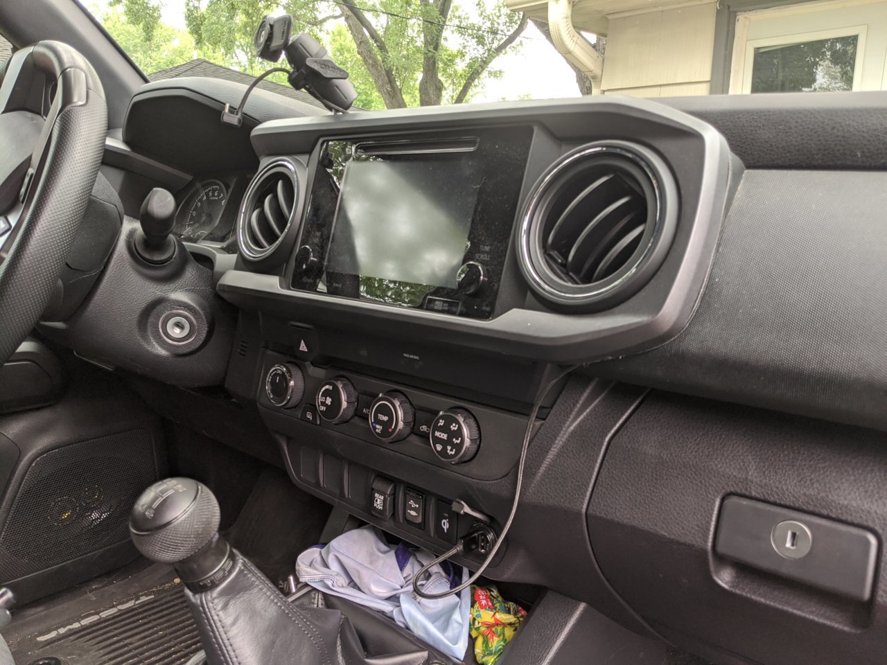

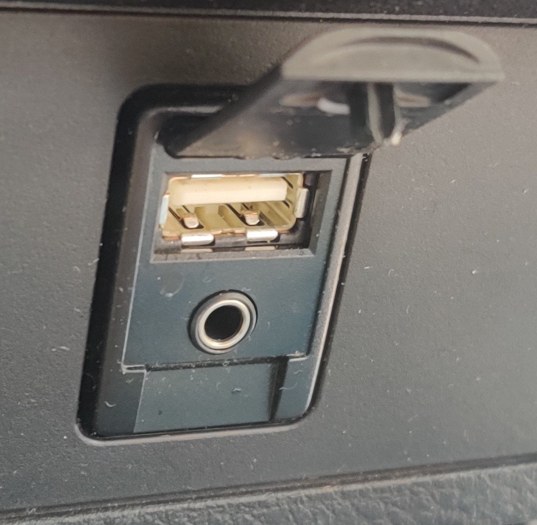

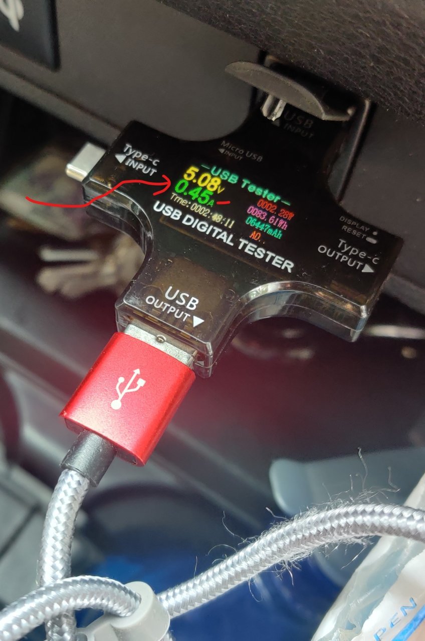

    Has anyone come across a quick replacement for this underpowered USB port on the front? I know I can "just" (four letter word) use a cig lighter unit, but it would be kind of nice to have a port that puts out more amps if you know what I mean. Like 1.5 or 2.
    See photos below of my setup and output amps into the phone.

    That USB is to connect a thumb drive or iPod for playing music through the stereo. The two in the center console are for charging.

    Not super simple, but it should do what you want.
    Remove the radio, unplug the USB from the radio and plug in this adapter
    https://www.amazon.com/PAC-USB-TY1-...4839555&sprefix=toyota+usb+ada,aps,178&sr=8-3
    The USB port will now have a normal usb end on it inside the dash.
    Next you need to get one of these
    https://www.amazon.com/Ginsco-Charg...keywords=usb+car+socket&qid=1594839624&sr=8-6
    Plug the adapter into it and wire it to 12v switched power from the fuse box.
    Your USB port will now be a 2.1 amp charge port, but it will no longer allow you to connect it to the radio.
