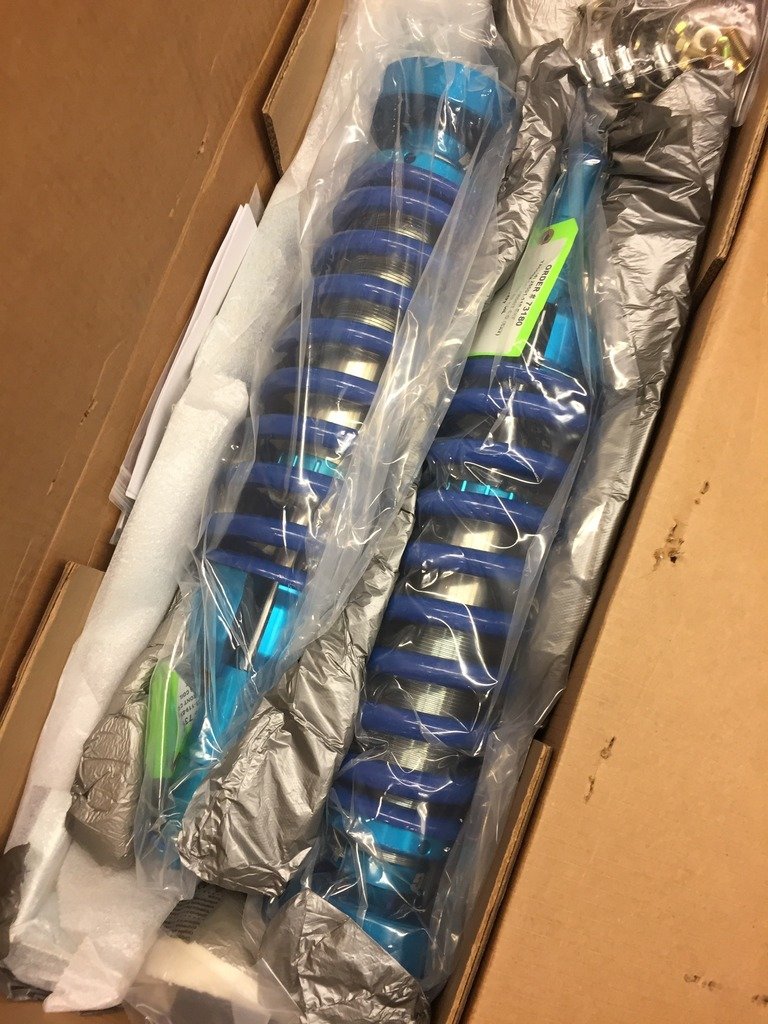

    Been searching and trying to find a good resource place for people to put their specs and actual lift achieved. Can we make a compilation of that here? Getting ready to install my King 2.5's and want to set a basic height before install. Lets throw up what your setup is (length of exposed thread)and lift height, pics if ya want for reference. Here are some other basic threads i found with random info about adjusting them.
    Include if you cranked the drivers side how much more to fix the lean.
    Thanks all

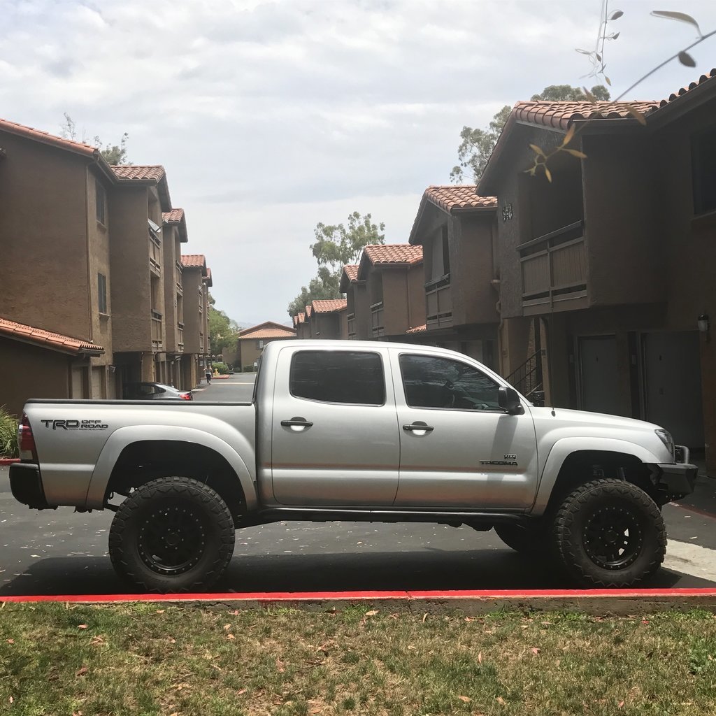

    2008 dcsb trd offroad 4wd
    700lb spring. Cranked two turns driver and 1 passenger.
    2" total lift

    Thanks for the input, we can adjust after, just looking at the first initial setup to get the big adjustment out of the way. I have 700lb springs with us offroad winch bumper & winch. Looking to shoot for about 7-10 turns over oem setting. Work at a dealership with proper tools and lift etc to make things easier. Just looking for a good base line for everyone getting into this because it seems adjusting on the truck totally SUCKS. I will post my results as well this well with pics.
    My base line oem Kings only have about 1/2" or so of threads showing. Looking to turn them up a bit then fine tune possibly on the truck or if i have more time to keep removing and changing.

    Front is kings with total chaos uca
    Rear is dakars with bilstein b110 shocks and daystar bumps
    Wheels are 17x8.5 4.75 bs with a .75 spacer
    Tires are 315/70/17 hankook rt03
