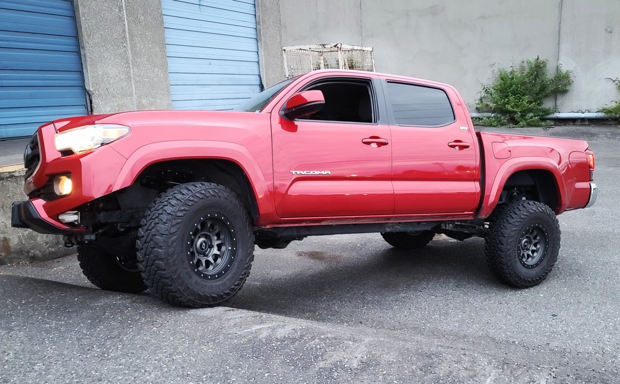

    @HeadStrong Off-Road is thee best. 2in lift with 5100s, ome 887 and a Deaver aal. Best bang due the buck. Then do a cmc, ucas and 33s and be done. We all get there eventually. IMG_20200608_211930_273.jpg

    That looks awesome and would probably look amazing in voodoo blue. But can you translate what you just said into "new guy" so my slower brain an understand it
