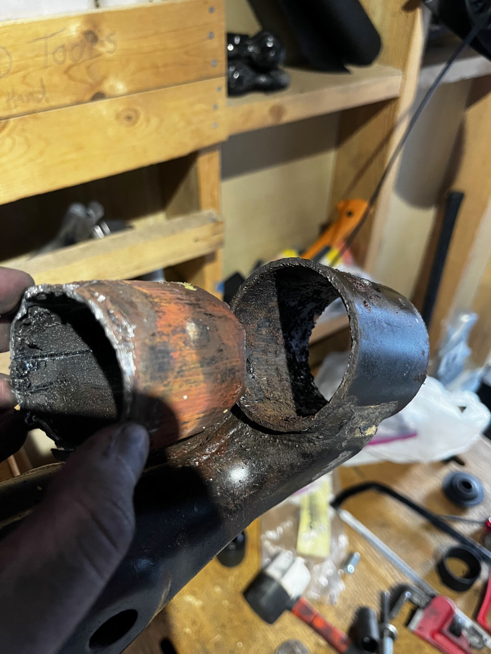

    Alright, so I tackled this in the last few days. I figured I'd provide an update since it was a hell of a dirty job and I relied heavily on guidance from this and other threads. I've seen a lot of people say they wouldn't do it twice and would just buy new LCAs. While I don't completely agree, it was one of those where the first bushing took me 3 hours, and the second took 20 min, etc. Would 100% attempt this a second time with my new found knowledge of how to make it work in my garage. I used a combination of a bunch of different methods I've seen here and on Youtube.
    Sawzall with a Diablo 6" blade was the perfect size to work around the frame and took care of both LCAs with just one blade. After unbolting the lower shock mount and the LBJ from the knuckle, I used a ratchet strap under the truck to pull the LCAs down further and to a better angle. I was able to get the forward bolt out, but had to cut through the cam sleeve and the bolt in the back on both sides. I made 4 cuts on each LCA, in around 10 minutes per side.
    My bushings were in good shape, but the truck spent 4 years in VT and the outer sleeves were seized badly. If you're lucky enough to get the rubber bushings to pop out with the outer sleeve, you'll save a lot of time, but that wasn't the case for me. I used a MAP gas torch to heat up the LCA eyelet while applying pressure through various methods and it ended up pushing the rubber out and leaving the outer sleeves orphaned on all 4 bushings.
    I used a rented basic ball joint press from Autozone, my stock bottle jack, then later a rented 23 piece ball joint press from Advance (which did the trick). The ball joint presses are the most controlled, but the flared end of the outer bushing sleeve prevents you from being able to get the press aligned on the LCA eyelet, so you'd be pushing the sleeve into itself.
    For the smaller bushings, on the inboard side, I was able to collapse the sleeve inward to create something for my bottle jack to press against. I did this by making 8 small cuts in the sleeve and bending these small sections of the sleeve inward one at a time with heat, a chisel and hammer. I then put the bottle jack between two ends of the LCA and pushed the sleeve out. Continue to apply lots of heat as you expand the jack.
    For the larger bushing sleeves, no dice with the above method. They were locked in there. Again, I used my sawzall to carefully create small cuts in the outer lip/flange of the bushing sleeve (it will end up looking sort of like a gear) and then used hand-held vice grips/heat to bend them inward, exposing the hidden outter edge of the LCA eyelet. With this new real estate, I was able to align a ring from the ball joint press directly on the eyelet, and push the sleeve into it using a TON of heat and a big pipe wrench on the press.
    Here's what I was up against:
    I then wire wheeled the inside of the eyelets, filed the edges where I had roughed them up and sprayed the LCAs with rust reformer after cleaning rust and grease off.
    Today I'm planning on pressing in Whiteline W53312 bushings ($80 open box on Amazon - screaming deal) using the 23 piece ball joint press. Then using a cam eliminator kit (I've heard good things about the 333 kit, only $100) to reinstall. Lastly I'll see about having a buddy lay down a bead on the cam tabs for some reinforcement. Should enough for my purposes.
