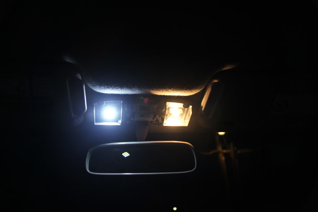

  8. Feb 18, 2012 at 3:44 PM
    #28
    JSFoster75
    JSFoster75 [OP] Well-Known Member
    Jan 24, 2012
    #71311
    1,543
    Scott
    Bluff City, TN
    2018 Wrangler JLU Sahara
    Too many to list.

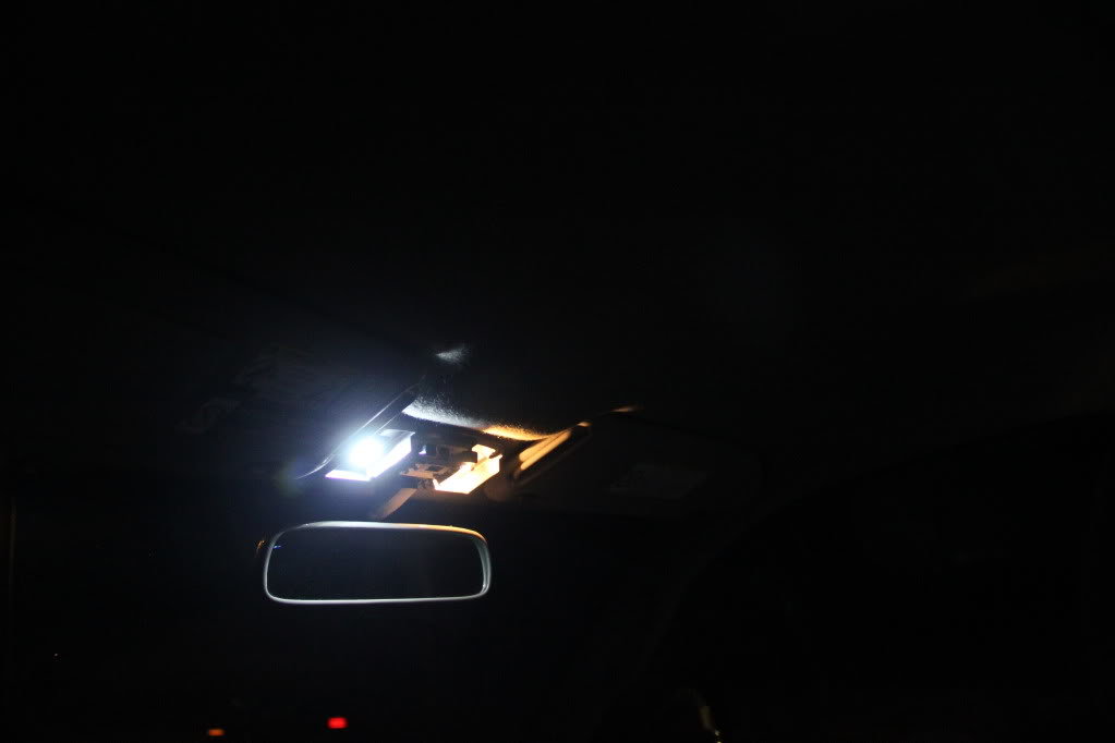

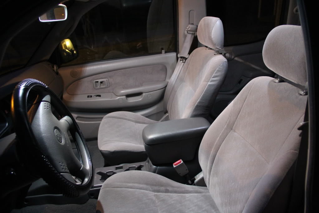

    Here's a few pictures to show the difference between the LED's and the original bulbs... Since my camera is smarter than I am, it holds the shutter open longer so the pictures aren't so dark which makes the inside appear brighter than it actually is... But it's still nice and bright inside... Link to album here for those that the pictures don't show up for....

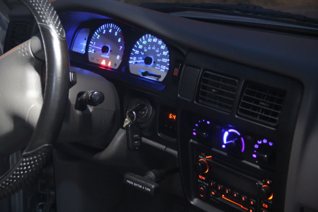

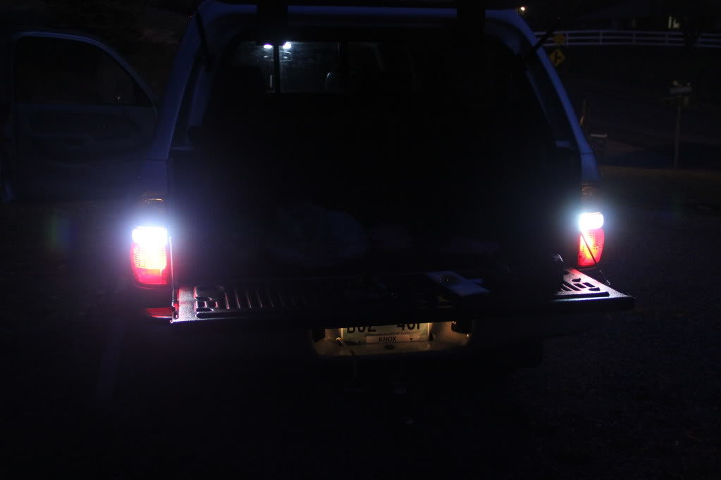

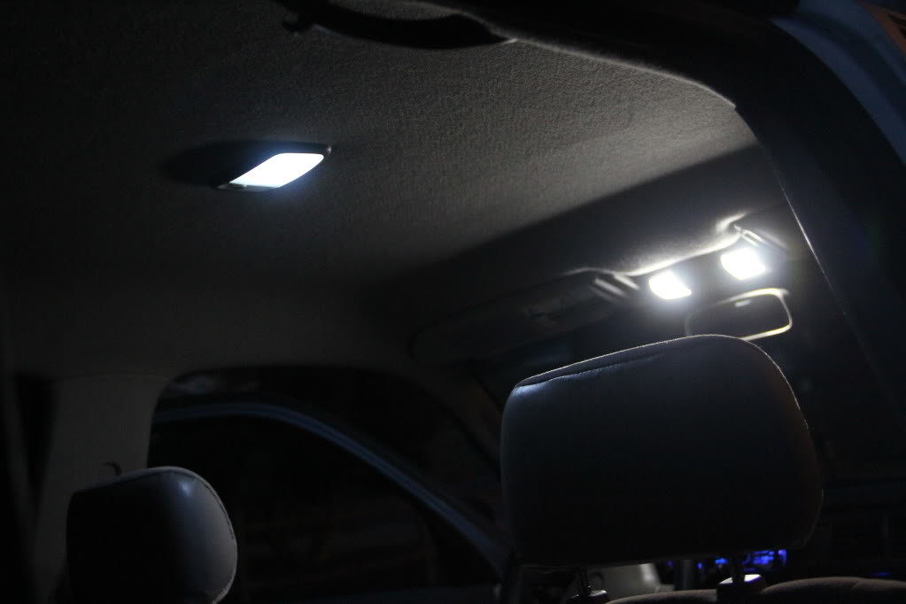

    Here are my latest additions, and yes, the bulbs from www.superbrightleds.com worked in the Map Lights with no resistors needed, the dome light did not though... Oh well, I got the one off of ebay to work by adding 2 - 100ohm 1 watt resistors to it...
    Replaced LED bulbs for reverse lights with Item #WLED-CWHP15-TAC
    Replaced A/C Panel LED's with 3 Item #NEO4-BHP Blue
    Finished my Dome (Ebay) and Map Light Bulbs (Map Light Item #3022-CWHP4)
    Nice and bright inside now!

    how do you like them reverse LEDs

    It looks better than the pictures can show. :) Let me know if you need help locating the parts. :)
    Just put them in today, but I tested it after dark and so far I'm liking it! :)

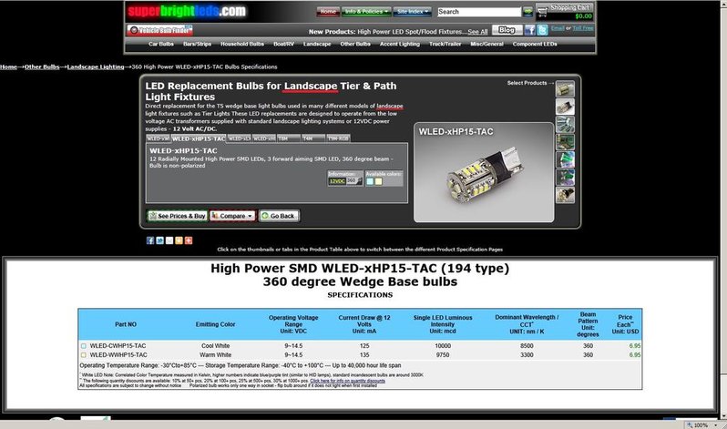

    They look good, but I have to ask what made you try LANDSCAPE bulbs?!? :confused:

    I went to Superbright's site, searched on the (WLED-CWHP15-TAC) part number you provided, and was taken to a page that labels the bulbs "LED Replacement Bulbs for Landscape Tier & Path Light Fixtures". (See attached screenshot.) What am I missing? :confused:

    WLED-xHP15-TAC: LED T10 Wedge Base Bulb
    [​IMG][​IMG]
    • Miniature Wedge Base Bulb (194/168 type) with 15 High Power 3014SMD LEDs
    • 12 Volt AC/DC, 360 Viewing Angle, 75 lumen
    • Compact size non-polarized bulb
    • Price for each. $6.95
