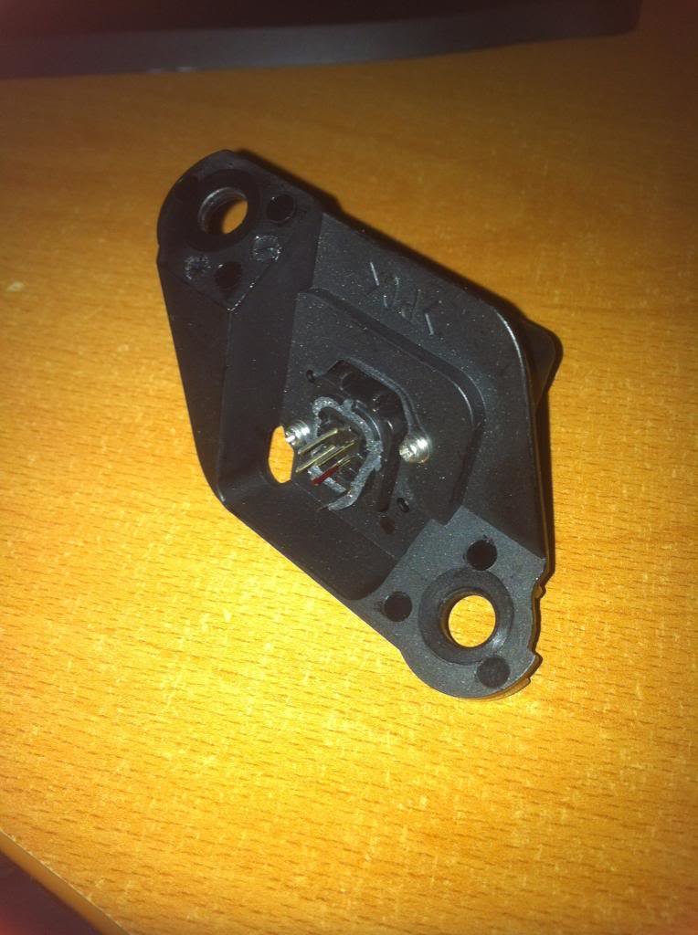

    So I have a 2014 regular cab Tacoma. It is wired for a back up camera. I do have the touch screen info-system and the yellow sticker so many threads have talked about. So I found the correct model camera (so I thought) 86790-04010 and bought it. However when I tried to connect them they don't line up at all. Both the camera and connector have 4 pins but the shapes are off. Does anyone know a work around. Please note my Tacoma is still under warranty so I will not do anything that would void that. I'd appreciate any help on this.

    20150425_134556.jpg It looks as if the plug in my prewired '13 tailgate would fit that camera. Wondering if there was a change between years, and you need a 'newer' camera?

    are you using the correct camera-end of the cable ? or the break point between tailgate and body
    so tailgate can be removed. you may just need the pigtail from camera-to-the thing you are showing

    ^^well looky they do....that may be the issue.
    though on my parts chart (sparks toyota) the 2014 'system is 04021' but the 'camera is 04010', for 2015 it is only 04021...
    perhaps this typo for wrong camera for 2014 is in many parts systems not just sparks

    Thank! Yup looks like I got the wrong camera. I need the 86790-04021. Which is 500 bucks everywhere I've looked. I got a good deal on this camera, would hate to return it. Is there a work around? It fits in the pop and lock perfectly. Bolts line up. Is there perhaps an adapter in can get? Thanks for all your help!

    This thread might help. You can shave the camera connector housing to make your harness fit.

    I was going to try and shave it down but it bothered me that my harness has 6 slots and not 4. Looks like I'll have to return it. I found this thread that shows the camera model I need.
