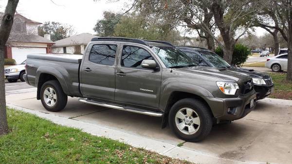

    Roof Rack installed today, about 2 hours. Spent a bit of time figuring out how to bend the brackets to avoid gaps, still not 100% but I think if you bend both ends of both brackets forward 1/4-1/2" you should be pretty close to having no gaps. I'm happy with the way mine turned out, but wish I'd had an extra set of those yellow clips so I could have refined it.

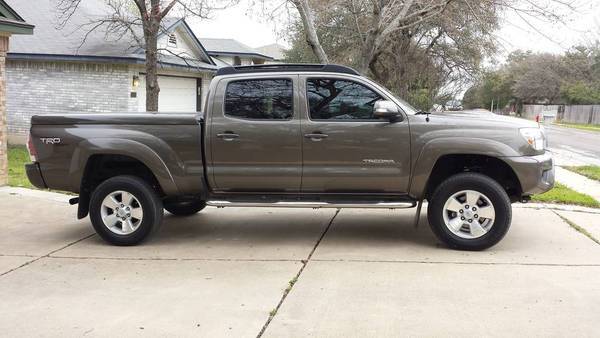

    OME lift completed. Dakar, LR, 887.
    Before/after left front: 20/22.5, After measurement on right front: 22 7/8", 1/4" spacer added above the left front strut brought both sides level, just shy of 3"
    Before/after left rear: 22/24.5 initial after couple days of driving, down to 24 after a couple of months (both sides, right might be slightly higher).
