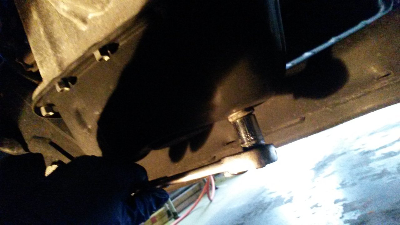

    Where does the drain plug figure into this? I understand the filter drops down, remove the filter, remove O rings.
    Where is the drain plug??
  12. Apr 3, 2019 at 9:08 AM
    #472
    mrproduxn
    mrproduxn Well-Known Member
    Feb 22, 2013
    #98175
    6,288
    steve
    Retired DoD SE VA
    Tacomas 1987,2000,2008, 2016,2012,2008
    Retired/Hobbyist old as f***
    The oil pan in the rear of the engine.

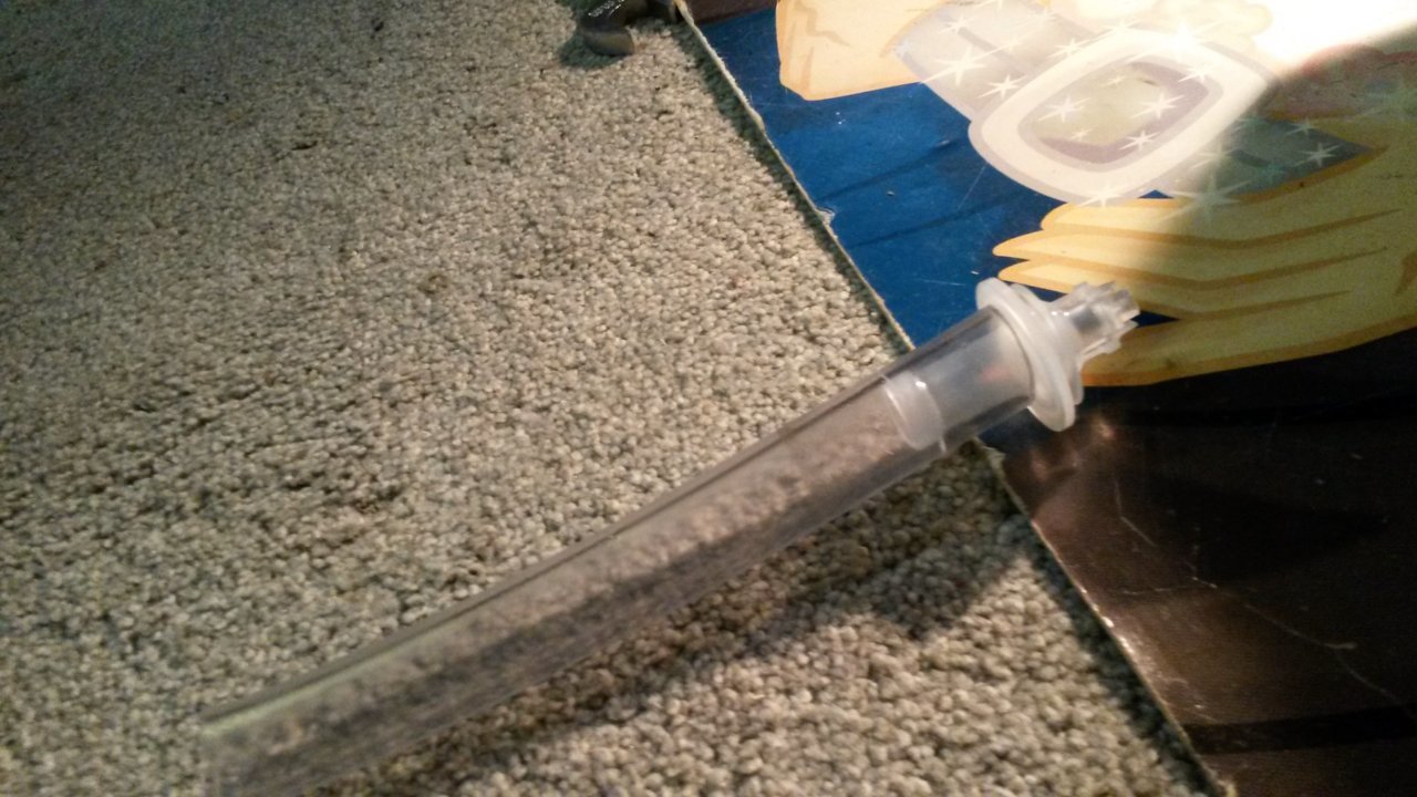

    There is a spring loaded drain plug in the filter housing too. Remove the bottom plug and push the plastic drain tube in, that comes with the filter kit, and put a hose on it to drain.

    The center plug in the first picture is how you drain the filter before you remove it.
    They sell a drain Percocet with hose so there is zero mess.
    You can also buy an aluminum housing to replace the factory plastic housing
    Be sure not to over torque either of these
