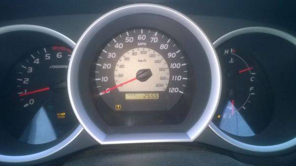

    What kind of mileage are you guys getting with the lift installed?

    I usually get about 420kms before the warning light comes on

    Pretty awesome mileage!

    Is that for one tank? 255? What setup you running. Jeeze I hope mine doesn't drop that much. I get at least 300 to the tank now stock with 265/70/17s.
