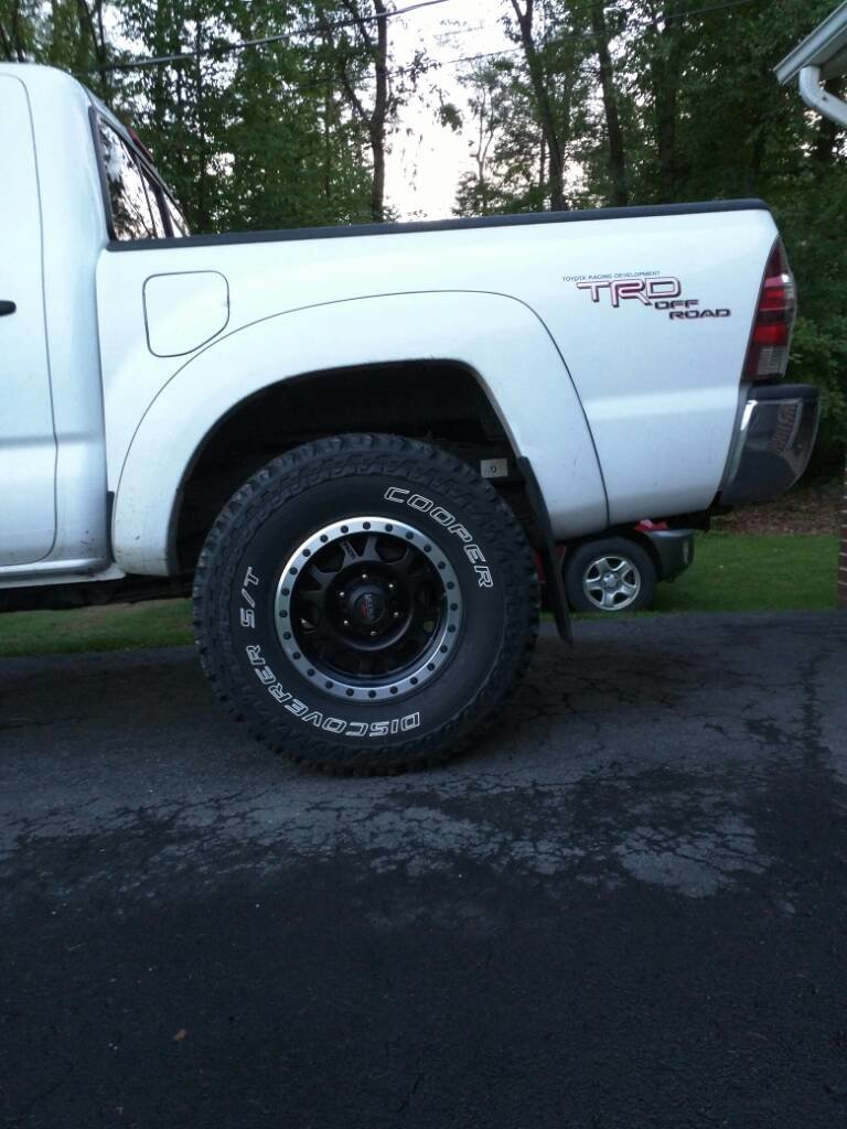

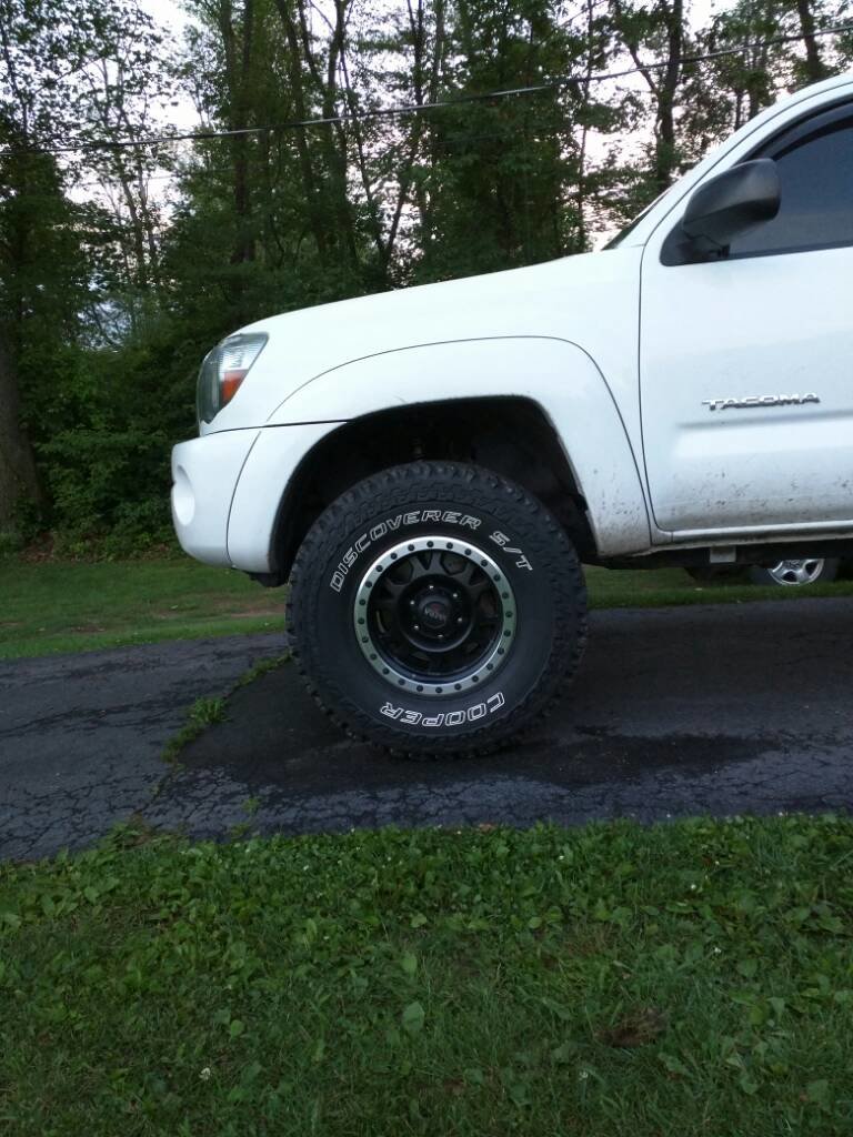

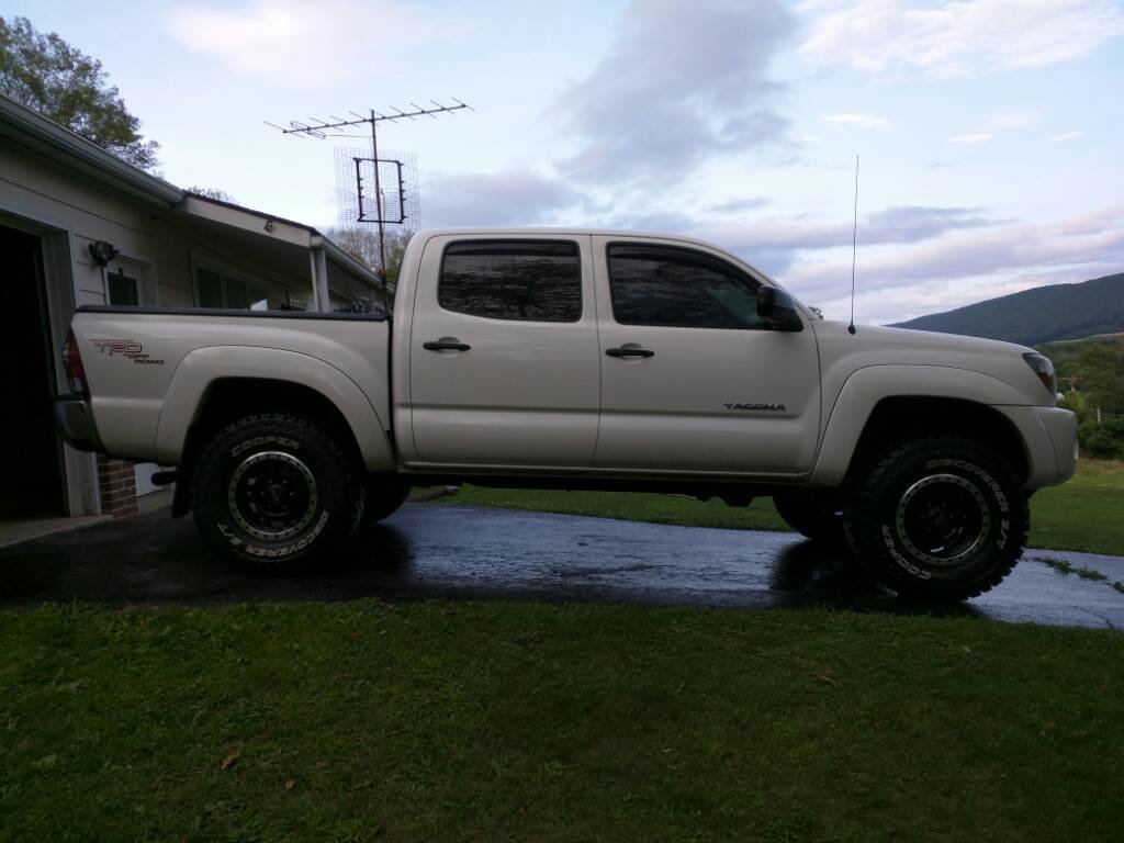

    Just got my 887 coils and Nitrocharger Sport Struts installed today. And some 285/75R16 Cooper Discoverer ST Maxx's.

    Nice man! It looks really good! How much total lift do you think you got up front?
