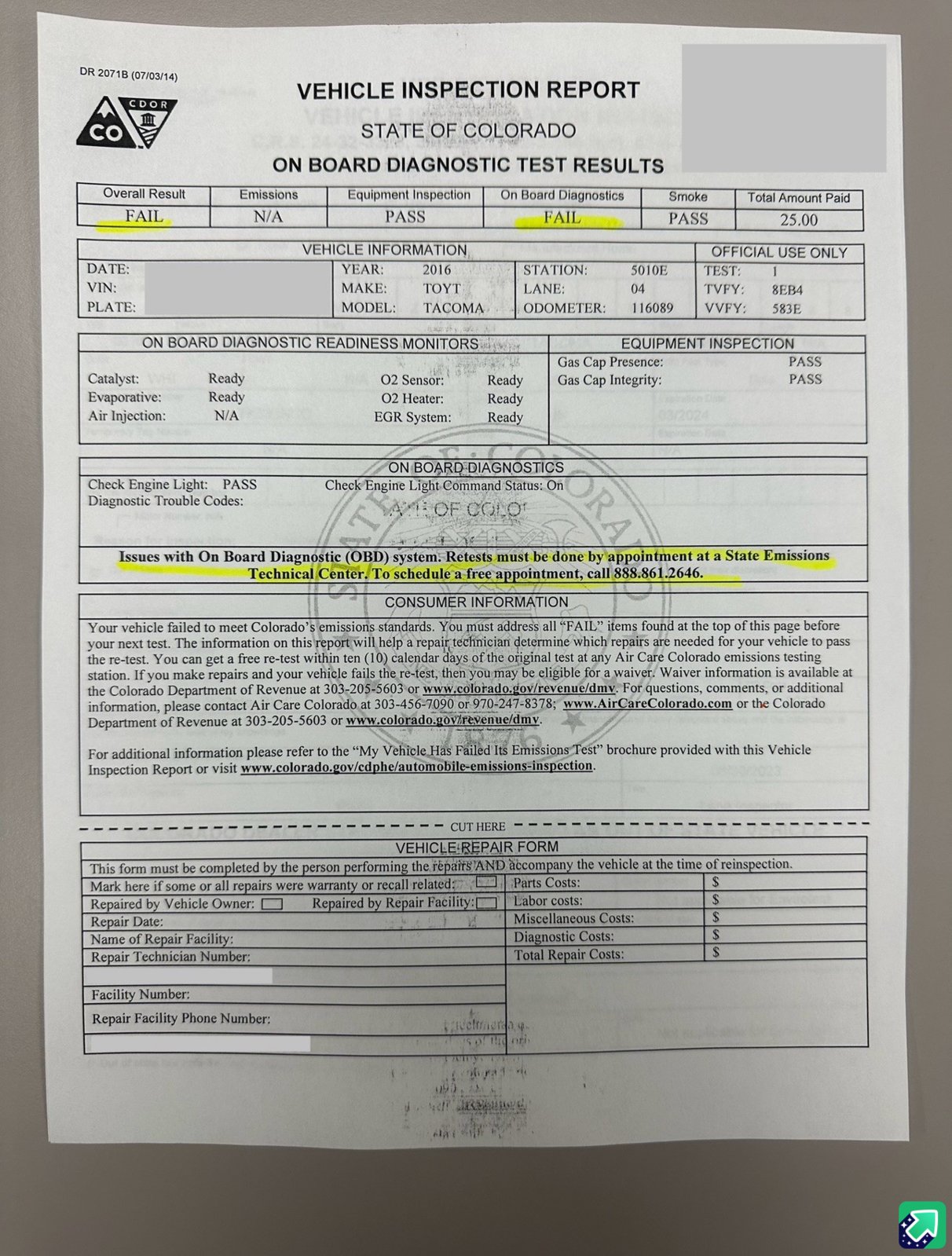

    They explained to me that I needed to make an appointment with a state emissions testing technical center to figure out what was wrong and that I could not come to any emmisons testing facility for a retest until I did so. They blacklisted my VIN in their system. Great. I texted my tuner and let him know what was up. He gave me a call and we reviewed the test results together. It didn't give us much info as to why it failed. I had no CEL and couldn't imagine why the OBDII port would be failing. So I went ahead and made an appointment with the tech center hoping that they would be able to tell me more.
    I went in for my appointment. I met the tech assigned to me, he took my keys, and pulled the truck into his bay, while I hung out in the waiting room. I had just settled in for what I thought was going to be a bit of a wait. I was wrong. He came back in within 5 minutes with some papers and sat down across from me. I have to give this dude credit as he was very patient with me and my countless questions and thoroughly explained to me what exactly was going on.
    The first thing he asked me was if I had a tune on the truck, and I simply played dumb. I said I just bought it used and the seller didn't mention anything about a tune. He went on to tell me as soon as he plugged into my truck's OBDII port he could see that the CVN/checksum did not match what was listed for my particular vehicle reported by the manufacturer. The tech said that because my CVN did not match, my truck failed the emissions test. He told me that as of July 2021, Colorado adopted California's emissions testing standards and that part of their new standard is that if the CVN doesn't match what is reported by the manufacturer, it is indicative of a modified ECU, and is an automatic fail. You can see CA's law here.
    Note: This new criteria is checking for any modification to the ECU. Any tune or modification to your ECU will change the CVN. This isn’t specific to the OTT Tune.
    Below you can see the results of their evaluation.
    So that was it, the only reason for failure. It doesn't matter that I was getting way better gas mileage or that the truck was more efficient. In the eyes of the State, my ECU was modified so my car wasn't eligible to be registered. So I asked the tech what I should do, even though I simply knew that I could get my tuner to flash it back to stock. The tech told me I would most likely need to purchase a brand new ECU from a dealer and have to have it installed and programmed with my VIN to disable the immobilizer. He warned me that it could be costly and that if the dealer had any questions to just call him. I heeded his warning grabbed my keys, hopped in my truck, and left. I immediately got on the phone with my tuner and told him what was up. We scheduled a time for him and me to meet so we could try flashing it back to stock.
    And that is what we did. We got it flashed back to stock and Adam went to check the CVN/checksum. No dice. At the time the CVN/checksum still didn't match what was stock even though there was no tune on the ECU. EDIT: This has now been fixed as per Colorado Toyota Tuning comment below. I was starting to get a little worried at this point. Adam reassured me that they would get me taken care of. He explained that he was working with a guy who was trying to get the CVN/checksum to revert back to what stock displays but they were still working on it and just starting to test this out. I was driving around an unregistered truck so I didn't really want to wait for this solution. So Adam offered up a temporary solution. He said I could borrow an unmodified ECU from him, we could swap it out, reprogram the VIN to the ECU so the truck could start, and I could take that to the emission technical center and retest. Good solution, the only issue is that I have to retest my truck every 2 years. I didn't want to deal with the hassle of getting a stock ECU from my tuner and having them programmed in my VIN every two years let alone run the risk of them closing down shop at some point or me moving away.
    So I told him I would just buy an ECU and keep it. That way I can leave the tuned ECU in my truck regularly and simply swap in the stock one once every two years when I have to get retested. This was the winner. To me, this solution seemed like the best option moving forward. It was futureproof, easy, and I didn't need to rely on any company or anyone to get emissions done. So we made the plan. Adam put the tune back on my truck as I didn't want to be without it and I started looking up where to source an ECU. This all seemed like a great plan until found out how much a new OEM ECU was.
    For reference, I already paid the average price for the OTT tune, and to find out that an OEM ECU was going to be an additional $700, I was starting to regret my decision. Unfortunately, due to the nature of this problem, reverting back to stock wasn't an option, and not ponying up for an ECU wasn't an option either. So forward we go. I pulled the part number for my ECU in my truck. The part number for my 2016 AT TRDOR was 89661-04K51. So I hopped on https://www.car-part.com/ punched in what I needed and....nothing. So I went ahead and changed it to a 2017 TRDOR AT redid the search and boom, some results. I found a reputable junkyard and gave them a call. An extremely helpful man answered and was able to tell me that my part number was interchangeable with a few different ones from different model years. So in my case, and for any 2016-2017, any ECU with the following part numbers would work.
