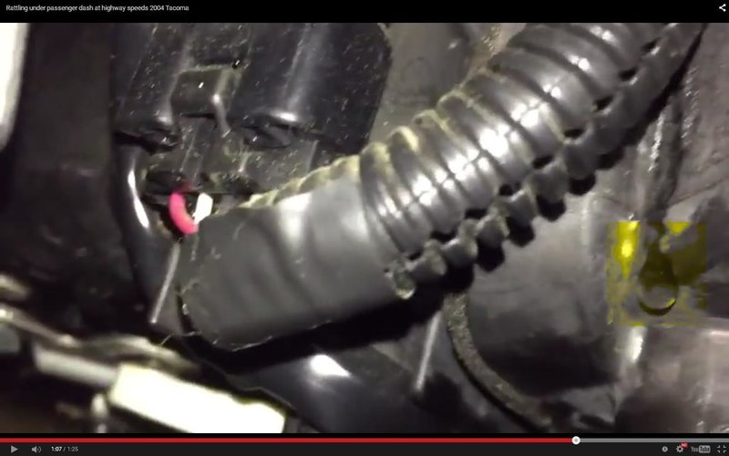

    It's really hard to tell from those videos, but it looks like your dash where the glove box is mounted is moving around in relation to the metal bar. Have you tried hitting/pushing/pulling on things to see if there is a difference?

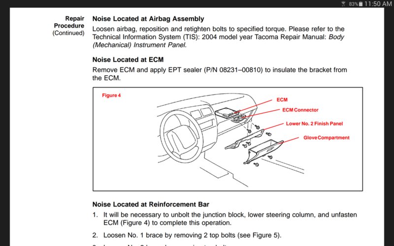

    Service bulletin

    I have already fixed the infamous dash rattle by wedging a piece of 1/4" fuel line between it and the windshield. This one appears the be more wind related. Did you watch the vids?
    I have tried to push it and pull it but nothing happens since it's already wedged with the fuel line.
    The sound comes from underneath the dash when I'm going down the highway, it does not do it just going over bumps. Is there a rock or something in my fender? Maybe my blower motor has something broken inside it? Anyone else heard this noise who could help?

    Did you read this part of the service bulletin?

    Couldn't open PDF on my phone (thanks apple). Thanks I will check that out also

    It's hard to tell but when I watched the first video @1:07 I see something that looks like a tab, around 1:10 to about 1:14 you can kind of see it bouncing and it seems to correspond with the rattle. It's a bit tough to tell but maybe someone else can look at it?

    could of swore I saw a water drop forming at 00:29 -30 (3rd video)
    but it could've just been the video quality and my mistake.
