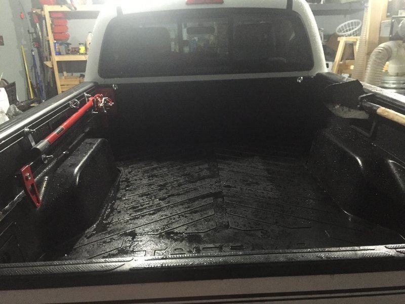

    A bunch of people make them. You can google something like "tacoma bed rail shovel mount" and get a few hits. I got these which are very well made and robust: http://www.4xinnovations.com/Double-Quick-Fist-Mount-for-All-Toyota-Bed-Rails_p_138.html
    I did find though that I rarely use the dual mounts, and only end up using one set, and I think there are guys out there making single ones. Something like this from RCI could be repurposed to mount quickfists instead of the supplied hardware: http://rcimetalworks.com/Tacoma-High-lift-Mount-Taco-05-15-8.htm

    K here's what I did. Buy the aforementioned quick fists. ^^
    Quick fists come with 1/4" hardware so I bought 1/4" threaded spring nuts and a few 1/4" washers at a hardware store (Ace, Lowes, etc).
    https://www.amazon.com/Thomas-Betts-GIDDS-461513-Spring-Nut/dp/B000BPD62I
    The unistrut will fit perfectly in the T-track of bedrail. Done. Sport the shovel and whatever else that you bed mounted. I made a simple mount to put a hi lift jack and a few tie down points using sawed down eye bolts.
