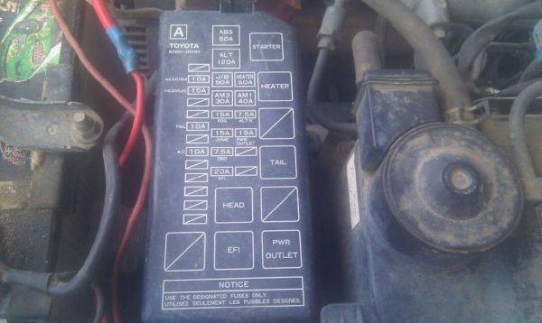

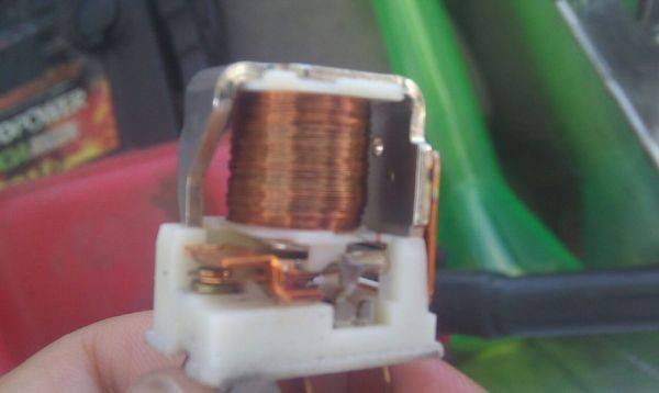

    Give me a second. The relay for the the plug is under the hood of my '01 you need to look under the hood for a thing that say's "PWR Outlet" pull that fuse and stick a piece of paper or something non-conductive under the relay switch.
    I put a piece of paper there so that it would be always on.
    This is what it looks like unmodified. You need to lift that little sprig/magnet thing and slide something non conductive there so that the circuit is always closed.

    Going on a years worth of use now and no problem. I just snapped that pic and there appears to be no signs of the paper getting anywhere near the point of burning.

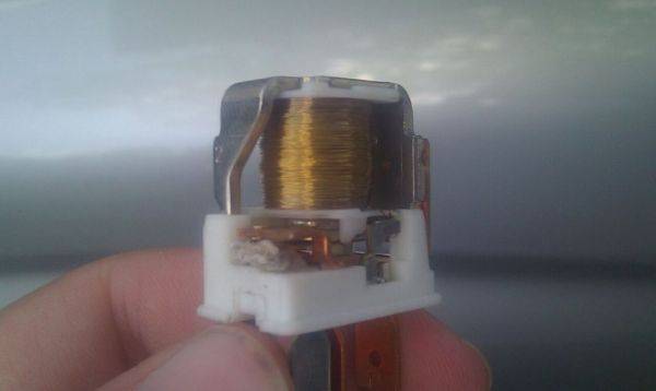

    I wanted to post another pic of the method in post #9 that doesn't involve a crumbled up piece of paper and blurry photo. I cut a piece of plastic using wire cutters, wedged it in the relay, and replaced the relay cover. I like this method better because I think it looks more natural than the "jumper" wire you see in other threads, and Toyota won't look at it funny if they mess with the fuse panel for whatever reason.
    I'm use to having 24/7 cigarette lighters from my F150 days, so I was eager to do this. I have to charge my Streamlight Stinger flashlight in a car for several hours.
    This is on a 2012 Tacoma Doublecab, and it affects both cigarette lighters. The relay is on the fuse panel under the steering column, not under the hood, for the 2nd generation Tacomas. There are other write-ups telling how to get to it.
