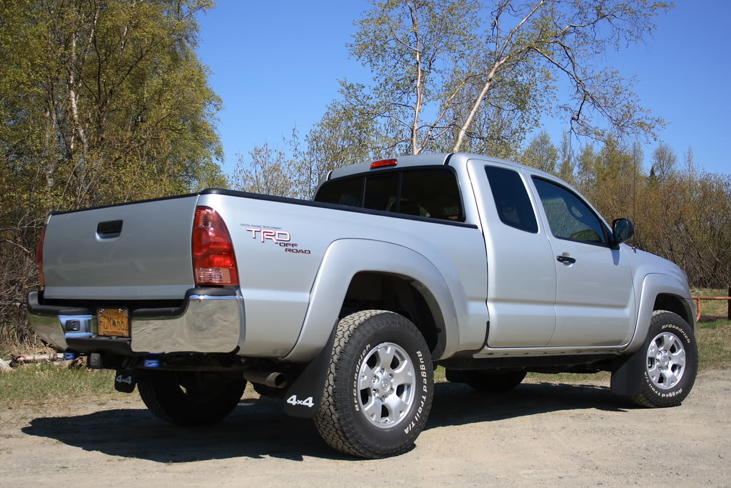

    you can use a $30 heat gun from Lowes, turn it on low heat and move it from side to side across the badge. once heated, take the fishing line and with a sawing motion go behind the badge to cut it away from the adhesive (do not let the line rub against the paint on the truck, will cause scratches)
    i used the spray goo gone, adhesive came off pretty good. washed the areas and now it's good to go!
    i took all badges off except Tacoma on the tailgate
    then you can perform the "Dog Mod"...
    here's a pic of the side after debadging.....
    P.S. if you're trying to perform the debadge on a gen 1 Taco, it's alot harder....the badges are totally different from gen 2. the badges are like hard rubber stickers. use the same steps as everyone else said, but it takes more time and patience because you have to do letter by letter :mad:
