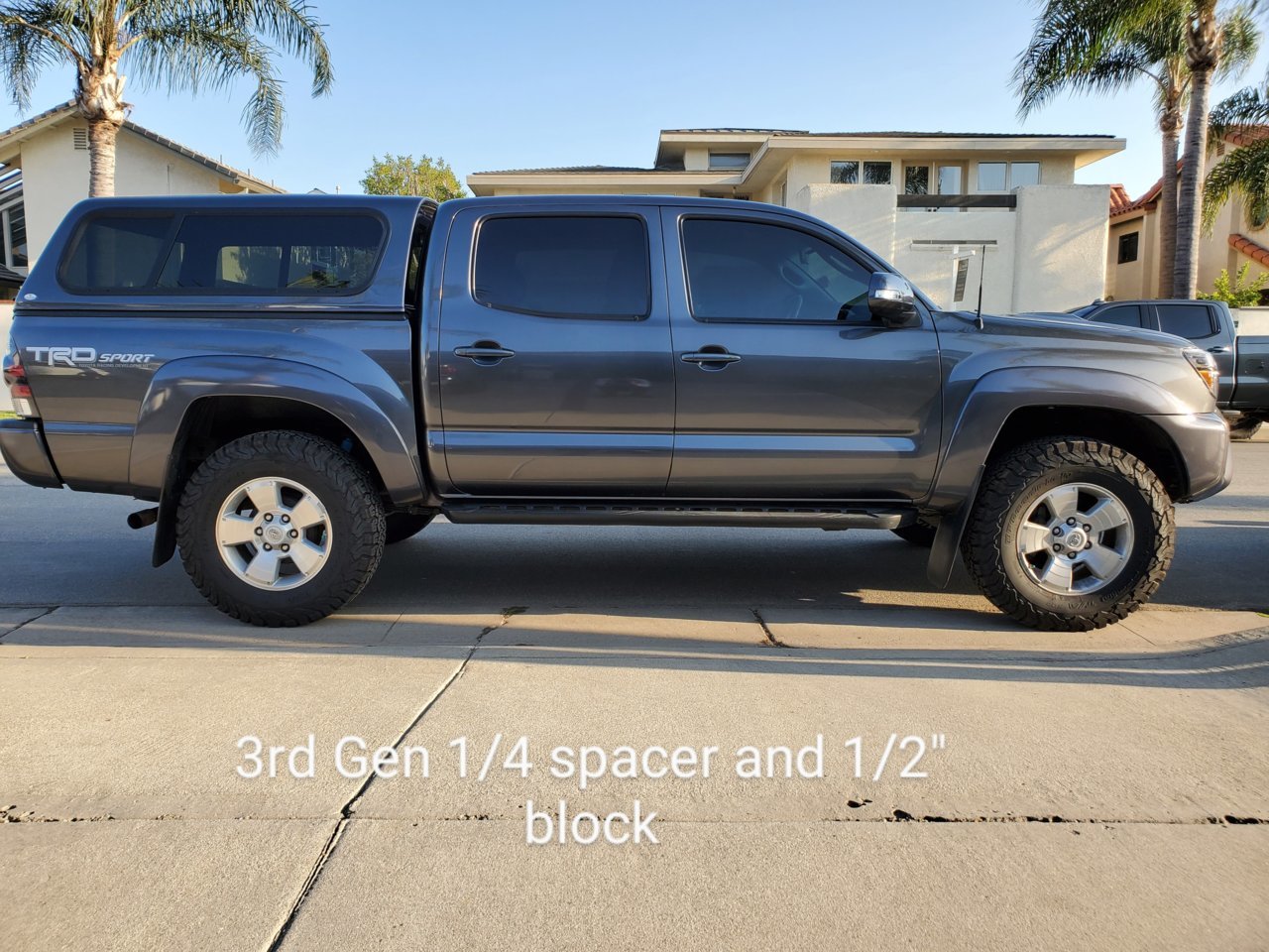

    Just had Sean@ Kaizendirt.com install 3rd Gen suspension on my Taco. Got new take off 2020 TRD OR DCSB coilovers and shocks. Added Wheelers 1/4" spacers to both sides and 1/2" rear blocks. No new top hat bolts or U-bolts were needed in either case.
    Before measurement from center of wheel to bottom of fender with a full tank of gas:
    LF: 20 1/8 RF: 20 1/2
    LR: 21 RR: 21 1/4
    AFTER:
    LF: 21 1/4 RF:21 3/4
    LR: 21 3/4 RR: 21 3/4
    Lessons learned- Even though the green dot front coil is driver side specific, it doesn't seem to "fix" the taco lean (at least in my case). There is some mixed info saying that it does. If I were to do it again, I'd only put the 1/4" spacer on the driver side (duh) -OR- if I wanted a little more lift I'd use a 3/8" spacer on the driver side with a 1/4" spacer on the passenger side with a 1" block or AAL in the rear.
    As it sits now, its pretty darn level to me but I guessing the front will settle down a touch over the next few months which is ok w me to get back a little front leaning rake.
    So prior to installing this, I really went back and forth on the going Billie 5100s with OEM springs and the 3rd Gen stuff. While I'm sure I would have been pleased with the 5100s, I'm thrilled with the ride quality of the 3rd Gen suspension. It's still very smooth and OEM like which is what I was after.
    For those in So. Cal, Sean@Kaizen was super easy to work with. I consulted with him prior to going w 5100s or 3rd gen and he spent a good amount of time detailing expectations of ride quality and performance from each without pushing an agenda of far more expensive suspension options. He knew what I was looking for and thought the 3rd Gen stuff fit my needs best and it did...

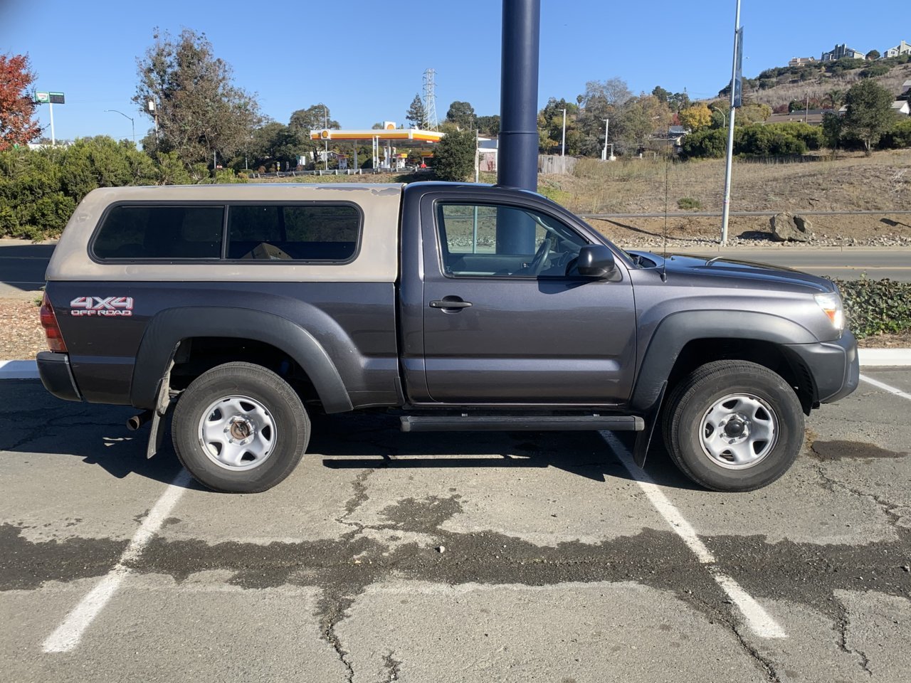

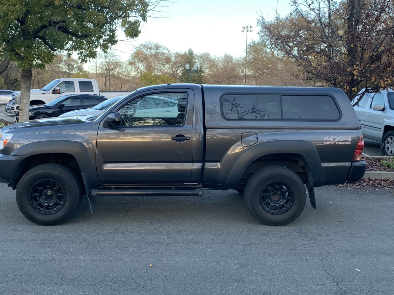

    I recently replaced front and rear springs and shocks in my stock 2013 regular cab.
    I bought new leafs and shocks, front and rear from a 2020 trd pro. The original had only two leafs, the trd pro has three. No installation issues other than the front shocks and springs are a bit longer and difficult to get in.
    Here are the before and after pics.
    Ohh and I painted the shell, but it’s the same truck. The 265 70 on the procomps, 245 75s on the stock wheels. I hope this helps.
