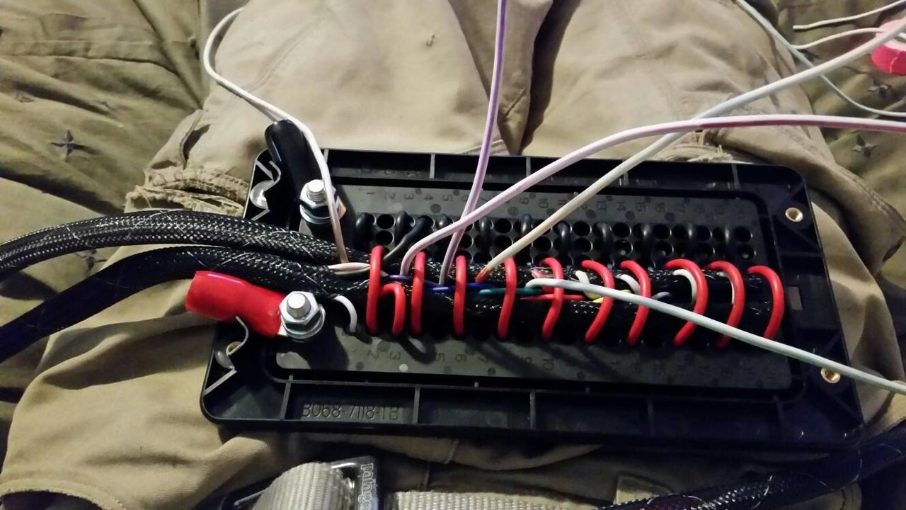

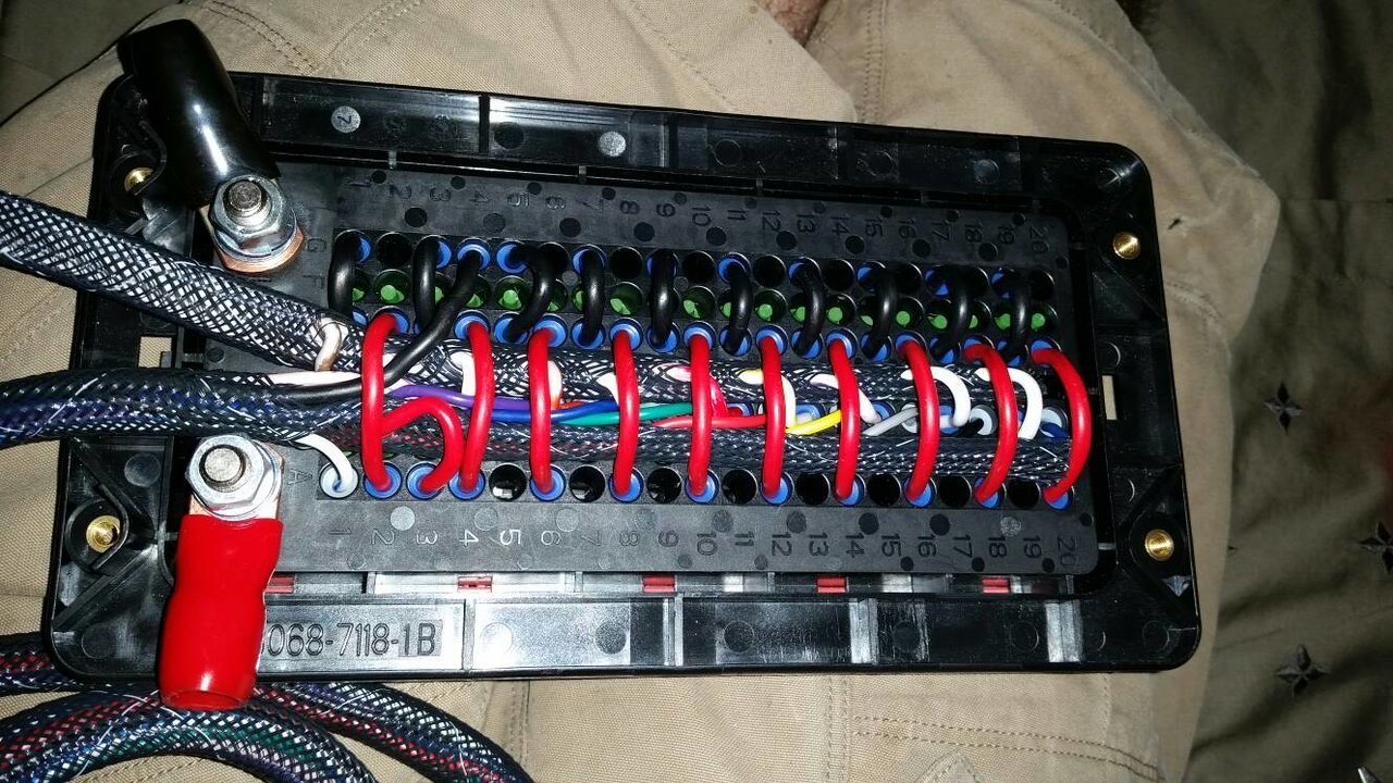

    Just an idea, take all the metal mounting clips off of the relays. A screwdriver flathead to pry the plastic up and a p[air of pliers to pull the clips out.
    Get some of the 3M Grey double sided foam tape. Used of automotive badge adhesion. <- I can link you to this.
    put them 4 on one side and 4 on the opposite. (relays) so that all the wires are in the center. Make the same type of the harness you just created with the clips. Connect all the positive, and all the negative. Use only 1 trigger out from the relay each and 1 out for the power on.
    SO with 8 relays, you should end up having 18 wires coming out of the box. Thats it.
    Positive from Battery
    Negative ground or battery
    8 Triggers to switch
    8 Out to accessory
    Ground all your accessories as close as you can to the actual accessory. Saves on running extra wire.

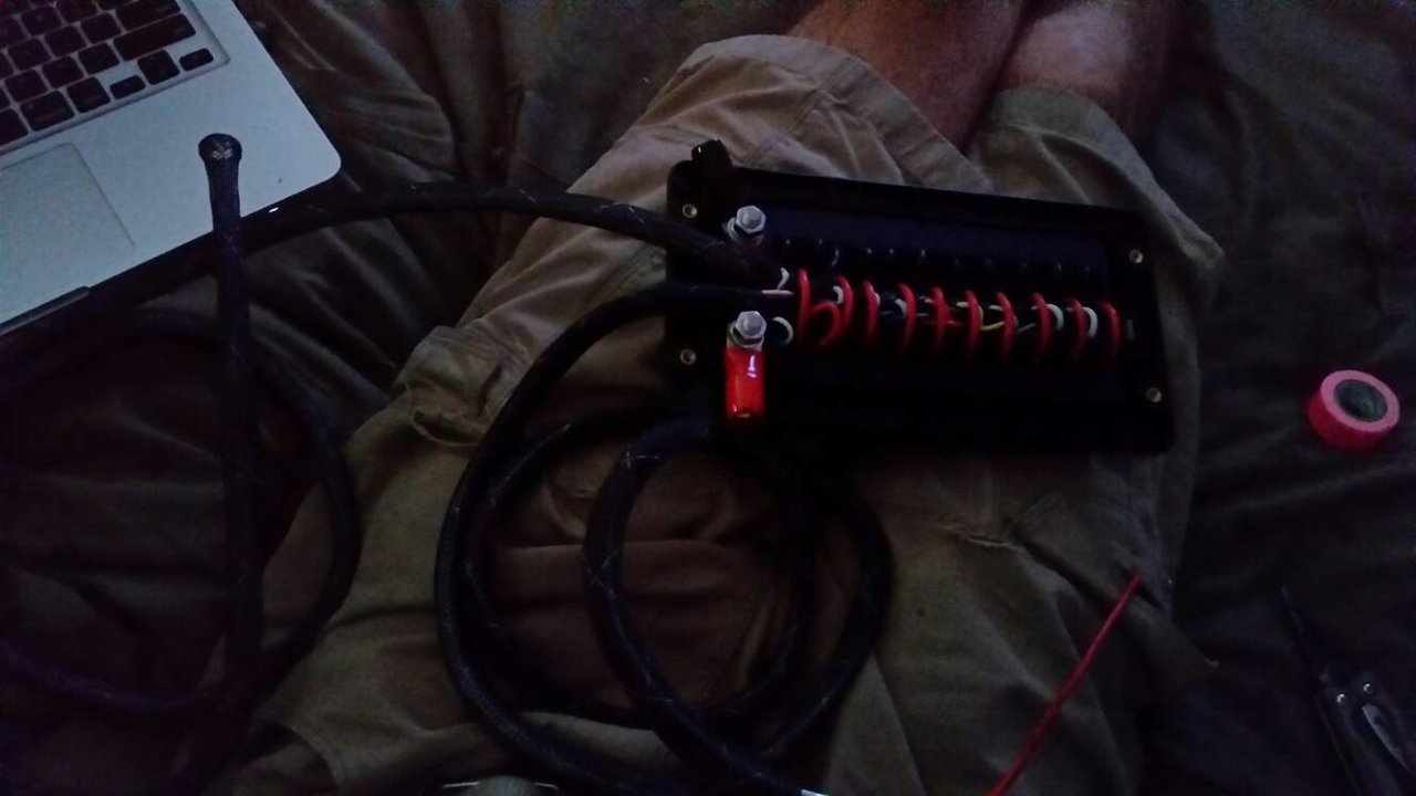

    Redid all I had in there. Now they stay in.
    Switch harness is done. Will terminate the accessory harness later today. Work on a mount, and install by nightfall.

    just got home, eating some cereal and then to finish this monster 100%!

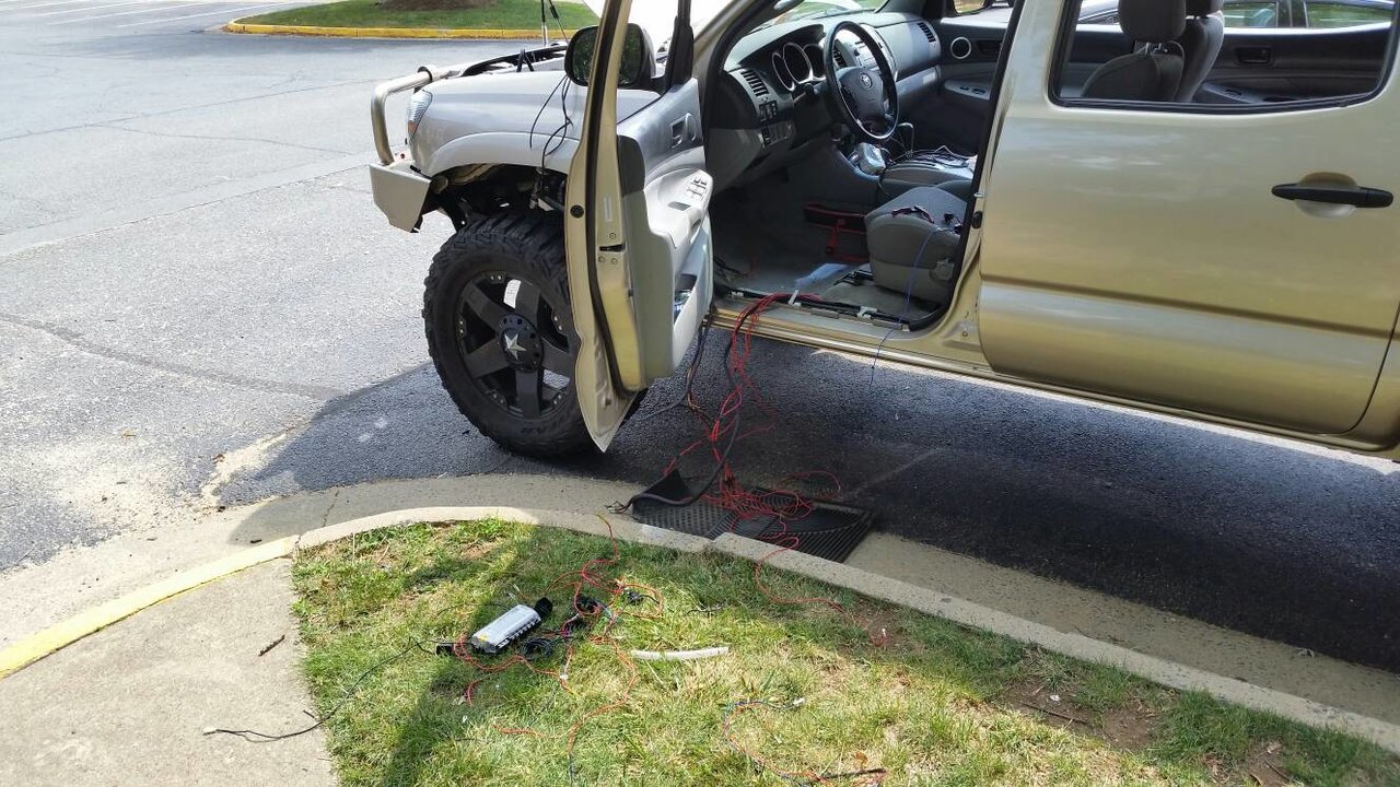

    1.0 done. Calling it 1.0 because I know I will want to add more to it.

    Going to plug the last of the unused holes and foot to go. Now for the mount.
