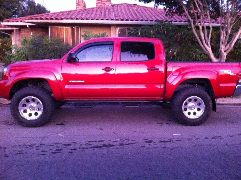

    sorry went camping... and it still rubs... check out the pics and let me know what you guys think... how much more do I have to trim and where exactly? thanks!
    the next two pics: the rub is in the middle of the pics, sorry for poor quality pics
    and this is my baby:)

    ya, i suggested that but they said getting that will rub the front even more and they have no idea how its rubbing there... If you see it yourself theres about 2-3 inch clearance from the tire and the frame...
