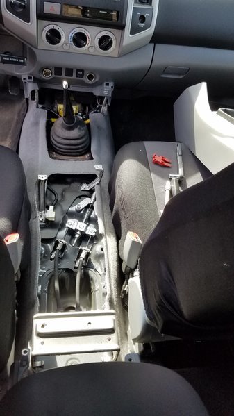

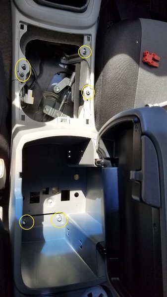

    Remove the cup holders. They popped right out just as was suggested above. I was surprised how easy they came out.
    Remove the entire center console assembly. This was accomplished by removing the 6 screws circled in yellow.

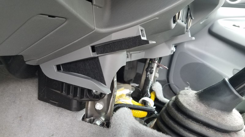

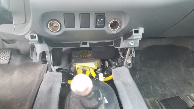

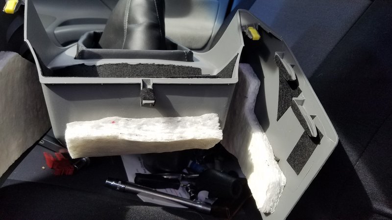

    I then looked at how the front part of the console that connects to the dash and not surprisingly, there are many areas of plastic on plastic. So I am not shocked this thing made as much noise as it did. I cleaned all of the plastic on plastic areas very well with rubbing alcohol.
    I had a bunch of sheets of "stick-on" or "peel and stick" felt for a different but similar project (*more about this project below) I was working on and starting cutting small pieces to fit on the areas that could rub together. I did a few pieces then re-installed and still had some noise, so I popped it back out and added more felt. I did this process maybe 6 times.
    Here are some pictures I took. The yellow arrows are pointing to where I also stuck felt but didnt take any pictures. Also I removed the yellow clips that the arrow is pointing at. With all the added felt, the console was more snug in the dash and I didnt see the need for the clip and I thought it was contributing to some noise. Props to Toyota for making quality clips that dont break, even after 7 years! The VW clips are shit compared to them.
    I added A LOT of felt to every clip and every mating surface, and an hour and a half later, I took it for a drive and sure enough ALL of the creaking from this console is gone! I probably went over board with it, but I wanted to rid the noise for good!

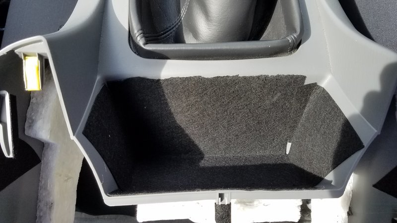

    *The project I was working on with the "peel and stick" felt, was also to eliminate noises in the cabin. But it was for the storage areas where everything is hard plastic and then is filled with other plastic/hard objects. So as they slid around, it would make a noise. I got this idea from my GTI which had every storage compartment lined with felt/carpet from the factory. For whatever reason, the cheap plastic Toyota uses is very loud any time something touches it.
    So I have been slowly covering every plastic storage compartment with felt and have been happy with my results. So far I have covered the inside of the center console, the center cup holders (bottom and sides), and the storage area in front of the shifter. I forgot to take pictures of the center console and cup holders but here is the other storage area. Had I known I was going to end up taking the whole thing out, it would have looked better and been easier to apply. Maybe I will re-do it, but you cant notice it when its in place.
