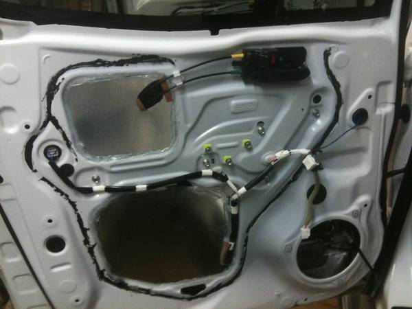

    Going to do the doors at least this weekend, and the rear wall is next though Im likely to have my local shop that did the amp/sub work to do it as they are more familiar with the way they wired the amps, etc. back there. Ive got some BXT II and P&S Ensolite on the way thanks to Rick at RAAMmatt.
    Anyway, Im pretty nervous about the whole project, and have several questions for those of you who have done it as most of the DIYs and tutorials out there are incredibly brief and seem to make many assumptions about peoples abilities and knowledge of their vehicle.
    For the inner portion of the outer door, did you just try to cover a good portion of the door?
    Most the pictures and tutorials Ive read talk about reaching the deadener through the access holes and covering the inner wall (which I plan to do). How much of that inner wall is important. Its a "go for most" scenario correct?
    For the inner portion of the inner door, did you apply many small cut pieces, or a few big pieces?
    In the Dynamat install page, the show having cut two large pieces, then cutting the necessary holes etc. See here:
    Is that realistic or should one plan to cut several small pieces and slowly go about overlapping most the door? Does the same apply for the Ensolite?
    How did you "press" your deadening to the door?
    Did you use a little roller? Hands? Sponge? Any tricks or "be careful to" etc.?
    What did you use to cover the access holes?
    One thing that seems really important, and is very beneficial to bass, etc. is to properly cover the access holes once done with the inner door. Ive seen several suggestions in regards to plexi, aluminium, etc. What did you use and how did you cut/mount it?
    When you did your doors, did you have anything that you realized in the process...or after the process...that you wished you had approached differently?
    Any lessons learned etc? For example "make sure to remove this first" or "be sure to organize this this way..." etc?
    Any other insights would be greatly appreciated. If you have any pics of your install that would be incredibly helpful as well. Im trying to get this all sorted out prior to the install so I can move along in a timely fashion without spending time wondering about the next step lol ;)

    Please keep in mind that this is strictly MY opinion.
    In theory, you are just stopping the vibrations of the outer so you should only need to cover most to accomplish this goal... not every square inch.
    I did mine in three full size sheets (I used Second Skin Damplifier Lite). I felt comfortable using full sheets instead of cutting them up. It is certainly easier to deal with smaller pieces, but in the end both ways will give the same result. I would go with whatever method you feel most comfortable using.
    In theory you want to try and avoid cutting up the Ensolite. Since this will be absorbing sound, I think you want to shoot for fewer seams. Seams have potential to let sound through.
    Use a roller... your hands will thank you for it. Obviously you need to lay the mat down by hand, but you should for sure use a roller to press it down. Be careful around the edges of the deadener... they will cut you.
    I think the main goal in covering up the access holes is to provide stability when laying down the deadener. This whole process is done to seal the door. I didn't cover my openings and just laid the deadener over everything. This method still seals the door but has potential to puncture during the install. I'm happy with the sound of my door speakers, so I think my method works fine.
    If I were to cover the holes, I would use thin aluminum sheets and attach it with metal screws. You can cut the aluminum fairly easy with metal cutting shears.
    Not really. I thought this was a very simple job. The best thing IMO is to just take your time and do a little at a time (i.e. don't try and do the whole truck in an afternoon). I started out doing just my front doors. My next step is to just do the back doors. Then the back wall. etc.
    Some people go crazy with deadener, which I think can be overkill. The thing I had in the back of my head was the more deadener I use... the heavier my truck will be... and the more it will cost (in gas) to drive. Keeping it simple will greatly increase the sound from your system even if it's not perfect.

    Definitely do the outer part of the inner door. That helped IMO. I just did about 3 square feet in there.
    I used plexiglass to seal the holes but I'd use sheet aluminum next time if I had some metal sheers. No need to use screws to hold it to the door; deadener works fine ;)
    I'd urge you to work in smaller strips first. Don't try and use huge pieces at first. As you get better you can start using larger pieces but certainly not to start.
    And IMO, the roller is only useful on flat surfaces which you'll find almost non existent on the door. It saves your fingers but I think your fingers are the best tool by far.

    1 door down (passenger front), 4 to go! Got started late today so I only got one of the two doors I was hoping to get. So far so good I think!
    The BXT II is fairly easy to work with, and the ensolite is very easy to work with. The door has a noticeably more solid "thump" to it. Took my time...thats for sure. Id lay down some BXT II, then "tap tap tap". I wanted to make sure that when I was done, I was DONE. I only made one major error (that I know of lol). I forgot about the brace...the one that you screw the door back into behind the handle lol. I had BXT and Ensolited right over it...so it took some clever pressing with a phillips head to find the holes. Lucky for me I was smart enough to take lots of pictures along the process.
    Anyway. Got music coming out of it etc. and no rattles. Im on call for work tonight so I dont really want to tear into the drivers side today...but at least now I have a good idea what Im doing. Ill get back to it first thing tomorrow when I get done at the gym.
