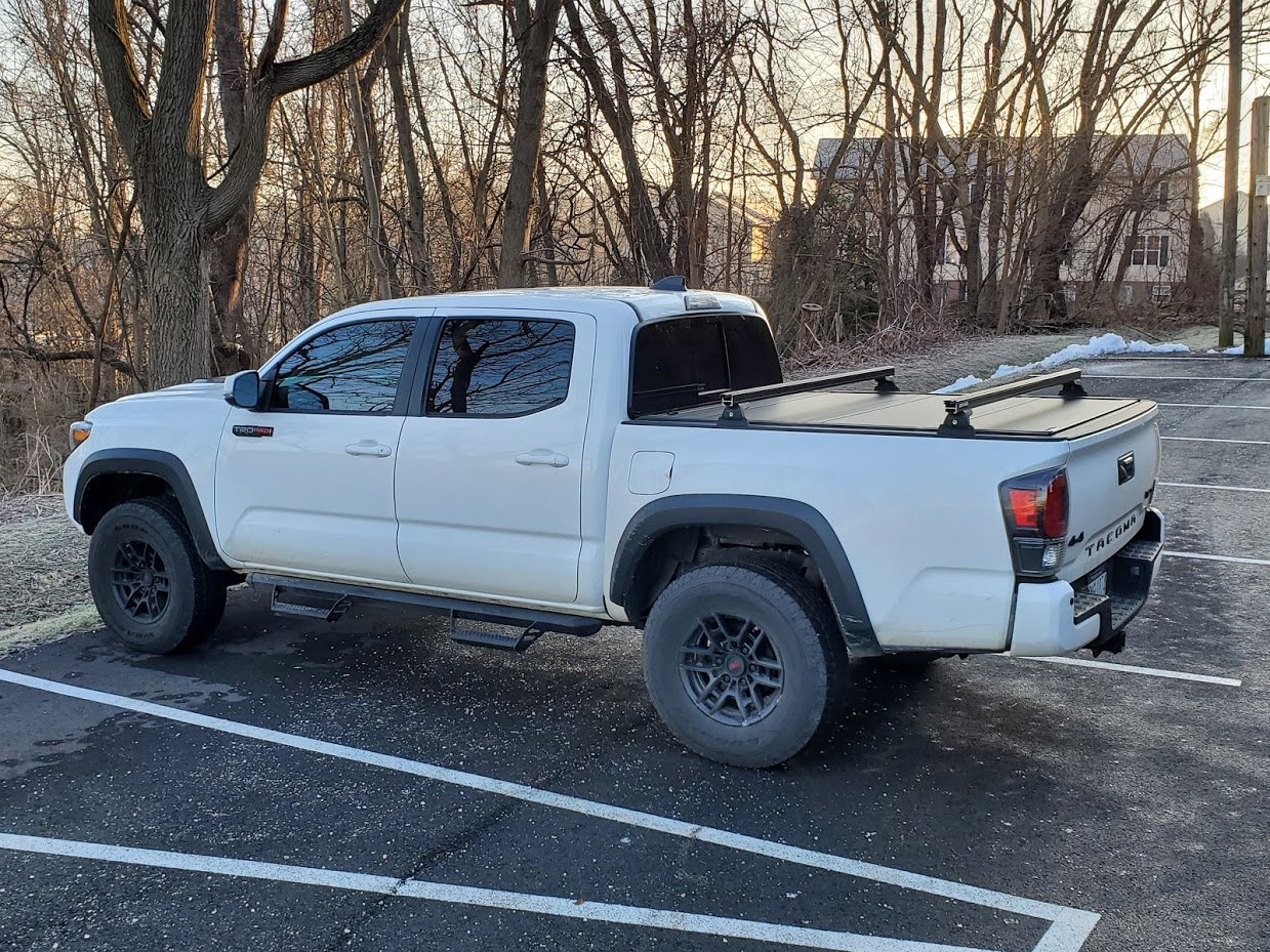

    I have an Undercover tonneau cover that utilizes the side rails. So I'm thinking about just bolting something to the top of the bed sides. This is only to haul a kayak so not too much weight. And I'd unbolt them when not needed. They don't need to be adjustable either.
    Any suggestions on how to fabricate this?
    Picture is of Voodoo's racks. I wish I could use these but they require the side bed rails.

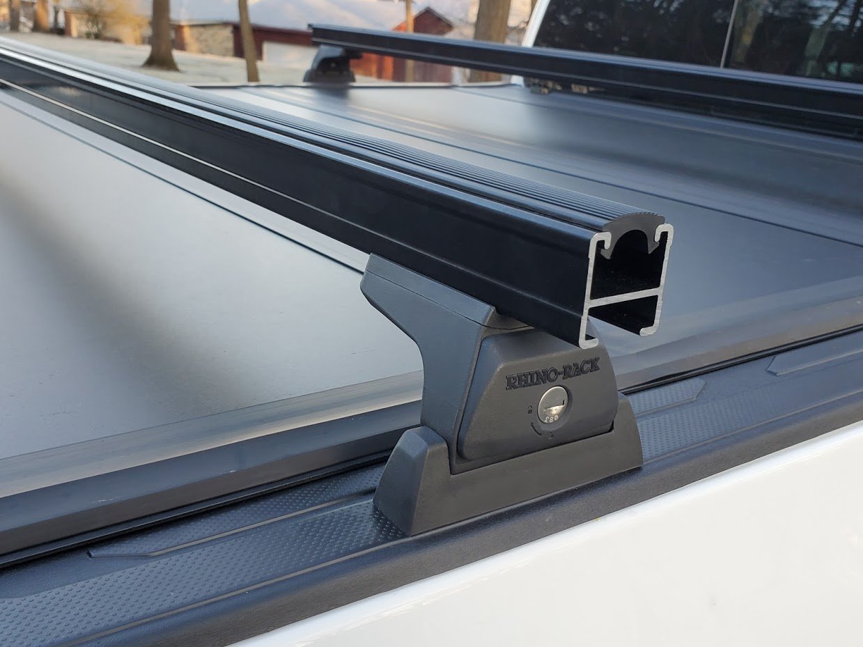

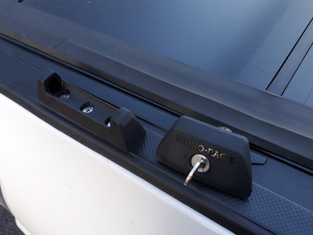

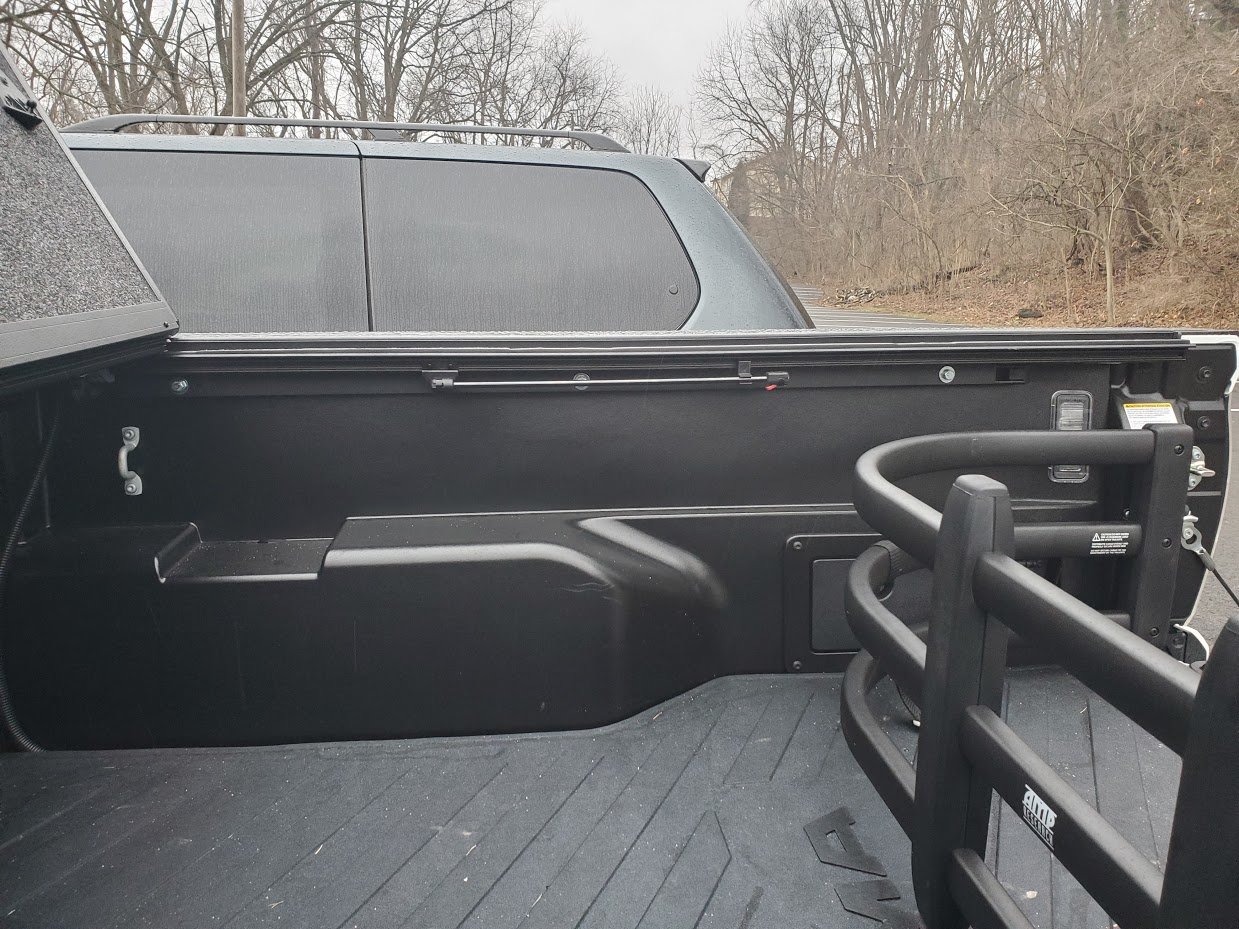

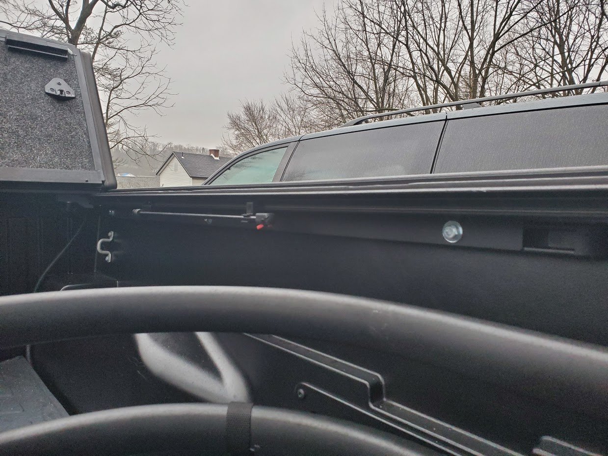

    Thanks. Unfortunately, the cover I have uses the entire damn rail. It's not a great design but it's what I got.

    damn! That is a terrible design. Mine only has two bolts on either side and two for the box.
    well then, and drill through you like will work. You need long arms to get the nuts on, but it’s totally doable.

    Yeah, I need to figure out nutless options. I won't get my arm up there.

    Install nutserts

    TRD-OR Trail Limo
    I had to do that for my headache bar. Harder than it should be with the plastic cover. I had to make a spacer so the tool could work.

    Thanks. I think I have it figured out with the nutserts. I'll remove the plastic cover, install the nutsert, then reinstall the plastic cover and drill a hole into the nutsert. The bars will sit on top of the plastic cover. They can be removed and only a small hole in the plastic will be left behind.
