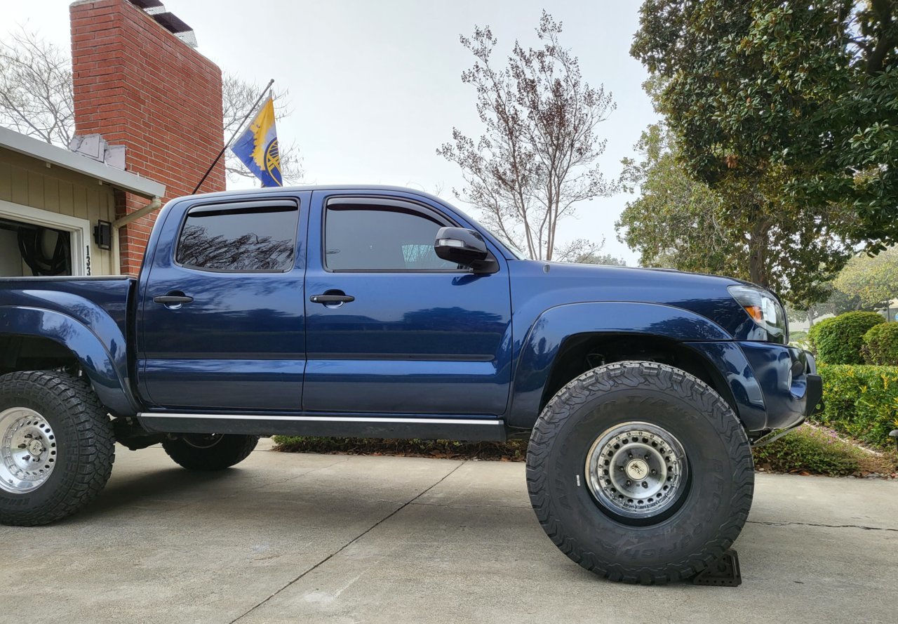

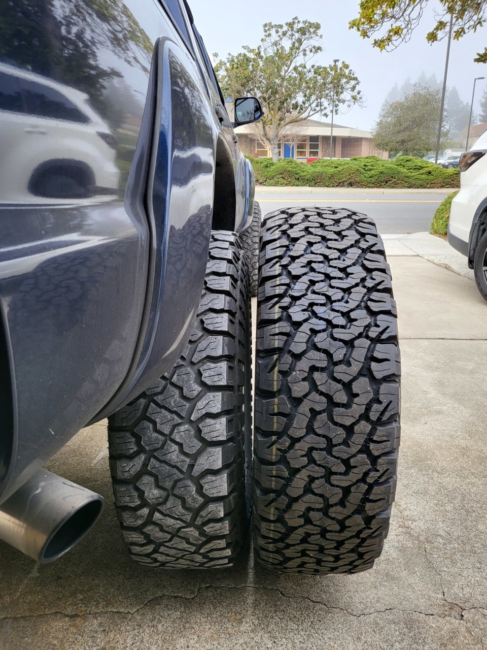

    It's going to be like clown shoes....need to spend a day with a BFH and angle grinder on the front wheelwell

    I can only imagine... I did 315/75r16 km3's on my last tacoma.
    I never realized how big 37's were until I had my Raptor lol
  7. Mar 2, 2022 at 1:47 PM

    Raptor on TEs? Yum!
    These 37" BFG KO2 are on the smaller side too. I picked up a single Cooper STMaxx 37" and that tire is HUGE!
    But yeah, either of them will dwarf a 35.

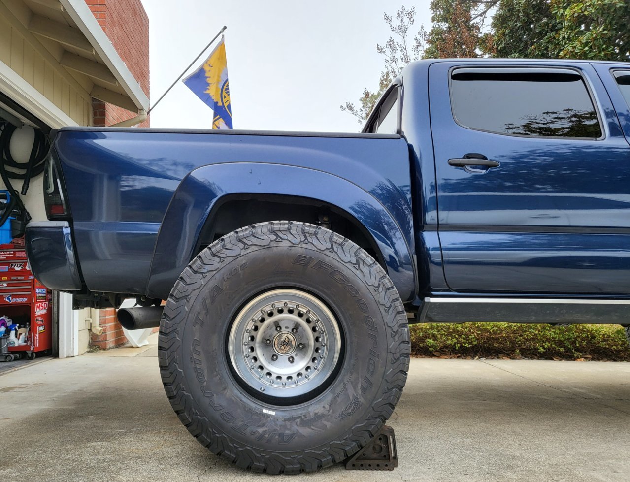

    Still need to trim and cut stuff. The 37" cooper stt pro is a ginormous 37.

    Damn, I could almost drop my trans without jacking that truck up! Looks awesome!
    I can only imagine the amount of heavy massaging required to get those to fit.

    Like a lot of people here.... I started with a 2.5" leveling lift and was convinced that I wouldn't want to lift any higher. :rolleyes:
    The Cooper STT Pro is going to be my spare tire but using it to mock up right now. If it's going to clear with the Cooper tire, then it'll clear easily with the BFG KO2s.

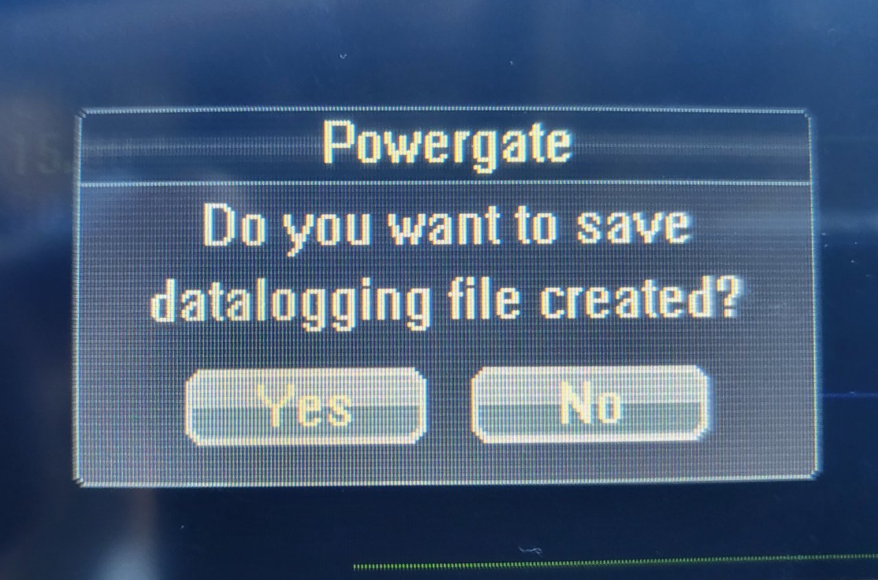

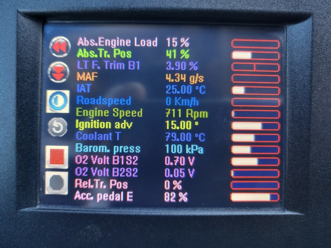

    I dyno'ed my truck back in 2018 when ECU tuning on the 1GR was accomplished by Orange Virus Tuning. (Pre HP Tuner days)
    https://www.tacomaworld.com/threads/ovtune-handheld-dyno-s.551687/
    I've been fairly satisfied with the OVT tune and have been using their "Stage 2" tune for the last 3 years. Then HP tuner came out, blew up the playing field and opened up the ECU floodagtes. Thus, my OVT handheld joined a device pool that includes the typewriter, fax machine, tube tv, vhs player, etc.

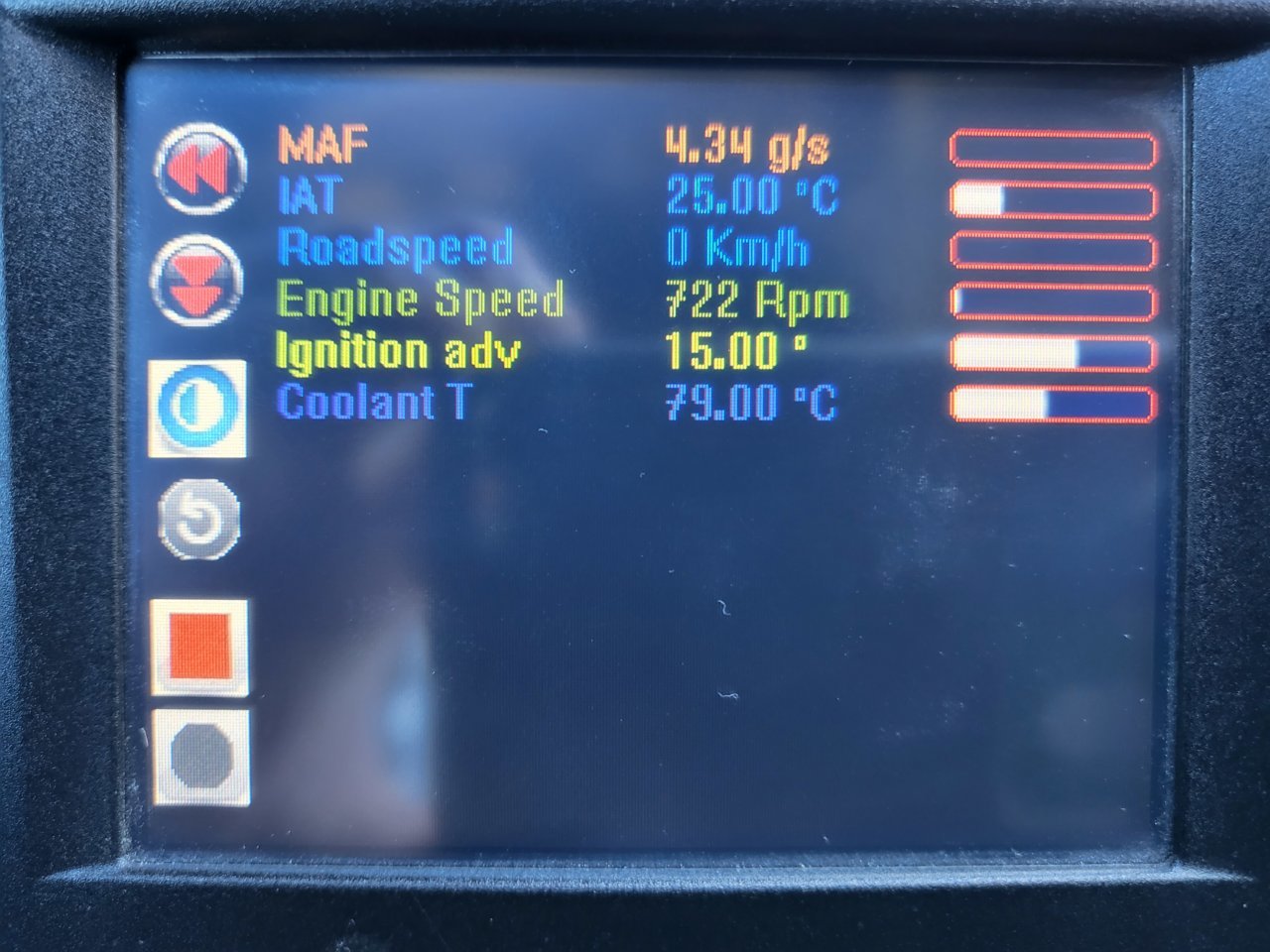

    Recently, I thought to fish out the OVT handheld device and see if it was still able to read/write. After a firmware update, this handheld device not only can still read/write, but it now appears to have rudimentary data monitoring and logging! Super cool!
    The device can read only 28 pids/channels/signals and only display up to 14x of them at one time.

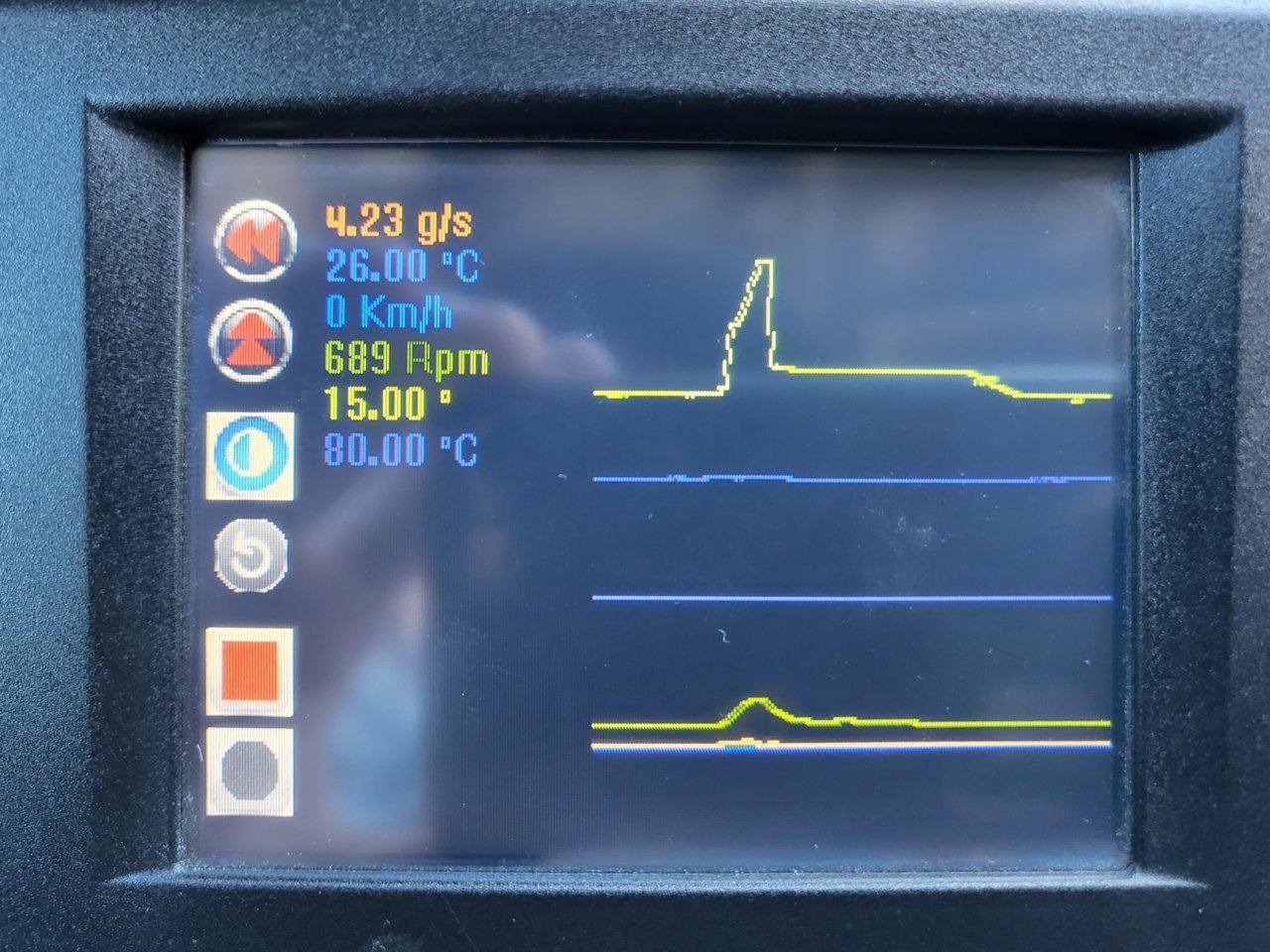

    I've simplified it to just display (MAF g/s, intake Temp, Speed, RPM, Ign Timing, and Coolant Temp).
    With those 6x PIDs, the device does realtime graphing.....
    And datalogging on the variable settings, saved as a CSV file.
    It doesnt support as many PIDs as scangauge or ultragauge nor can it display tpms like Maestro. And it pales in capability compared to HP Tuners since it cannot make adjustments.
    But its a total win for no additional $ spent. Basic data/pid monitoring and logging without needing a notebook/laptop.
    It's only a matter of time before I convert to HPT because of how robust it is. But until then....

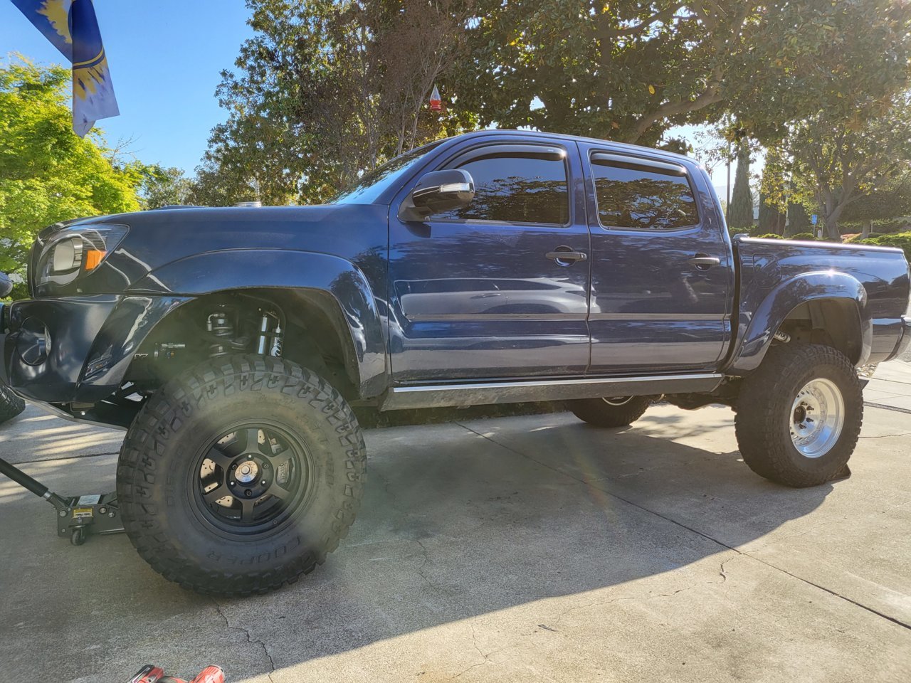

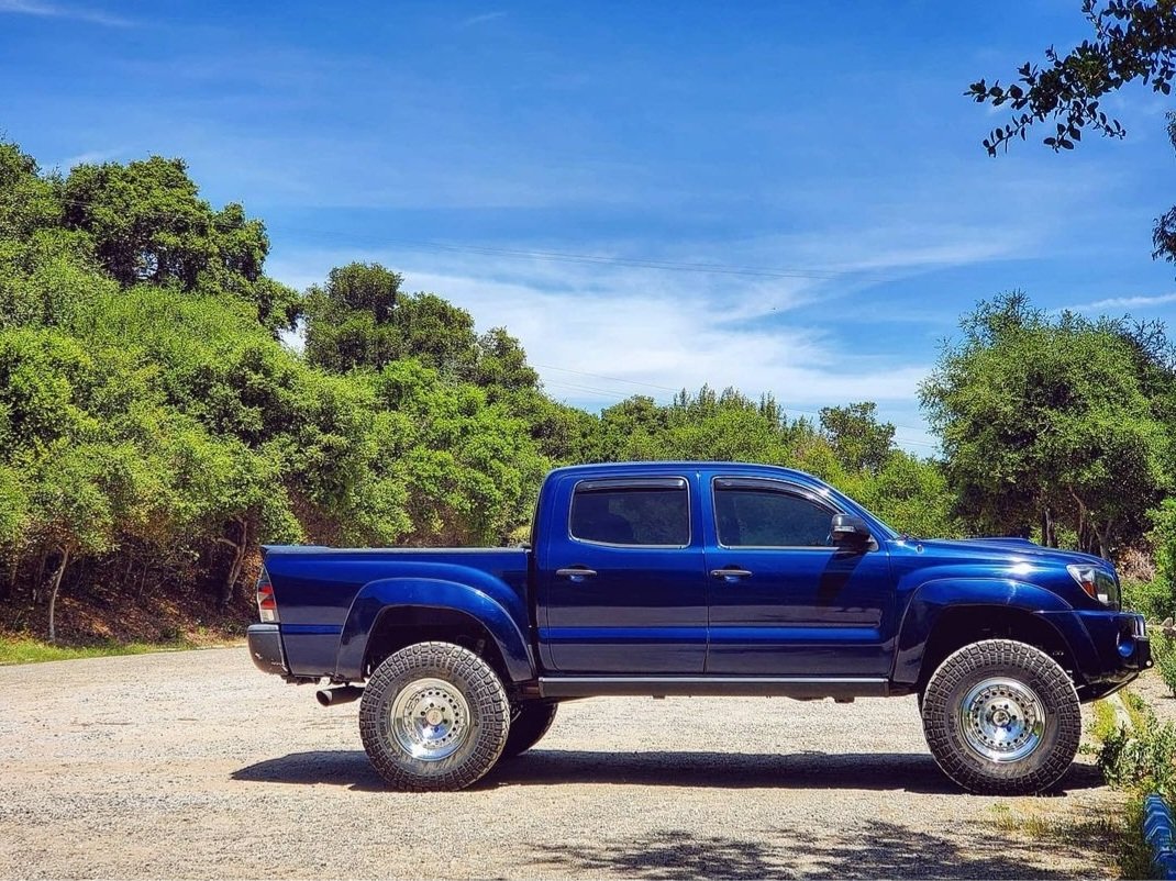

    (On Kenda Kleaver RT 35x10.5x17)

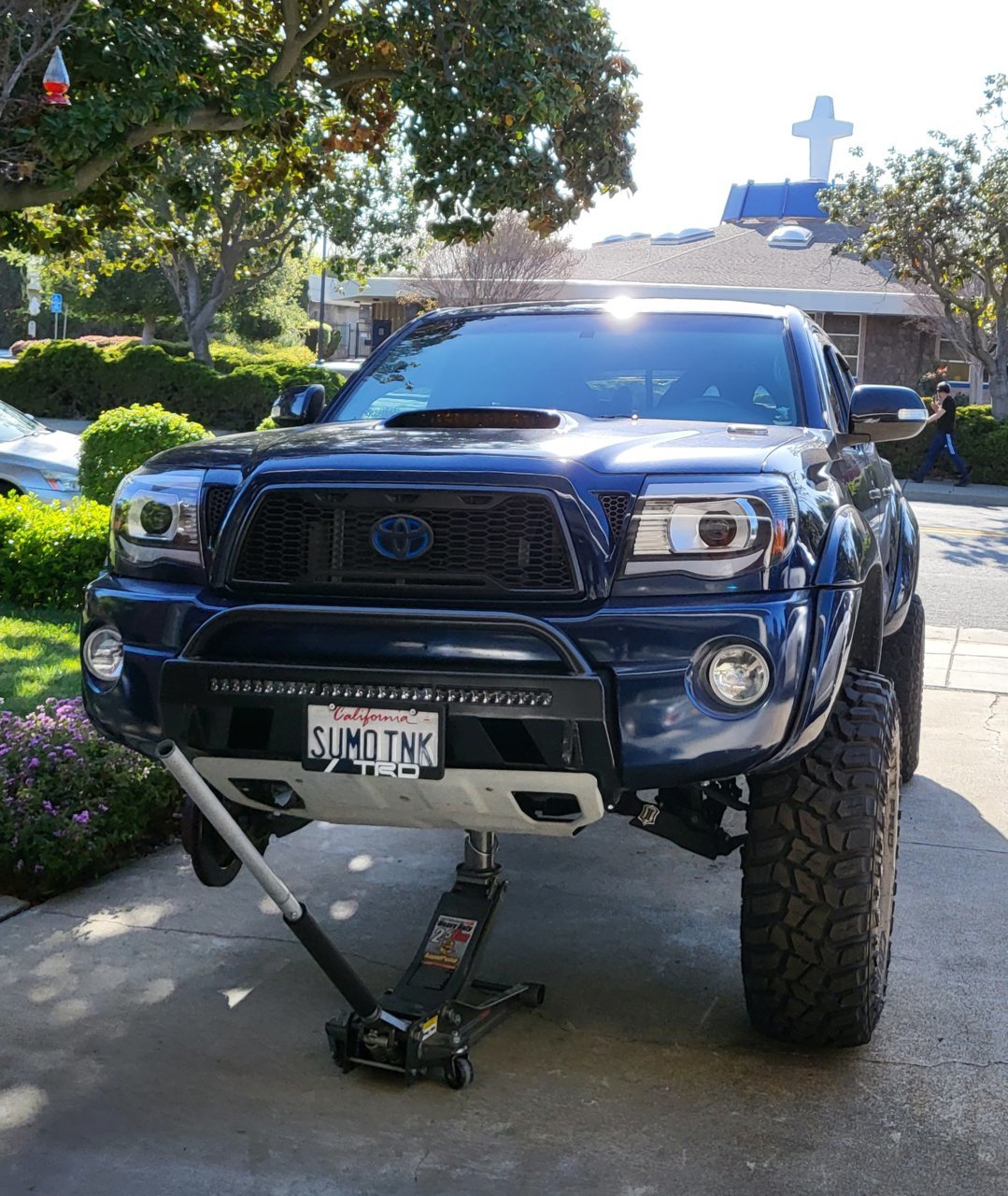

    Decided to undergo a Gen2 to Gen2.5 facelift. The main cosmetic changes will be these:
    1. Knockoff TRD Pro Grille with custom emblem
    2. Amerihood Heat Extractor Ram-Air Hood
    https://amerihood.com/toyota/tacoma...e-functional-heat-extractor-ram-air-hood.html
    3. Morimoto XB Hybrid LED Headlights
    https://www.theretrofitsource.com/xb-hybrid-led-headlights-12-15-tacoma-amber?quantity=1
    4. Diode Dynamics Elite Series Fog Lamps
    https://www.diodedynamics.com/elite-series-fog-lamps-for-2012-2022-toyota-tacoma-pair.html
    5. Chassis Unlimited Prolite Front Winch Bumper
    https://chassisunlimited.com/products/2012-2015-toyota-tacoma-prolite-front-winch-bumper

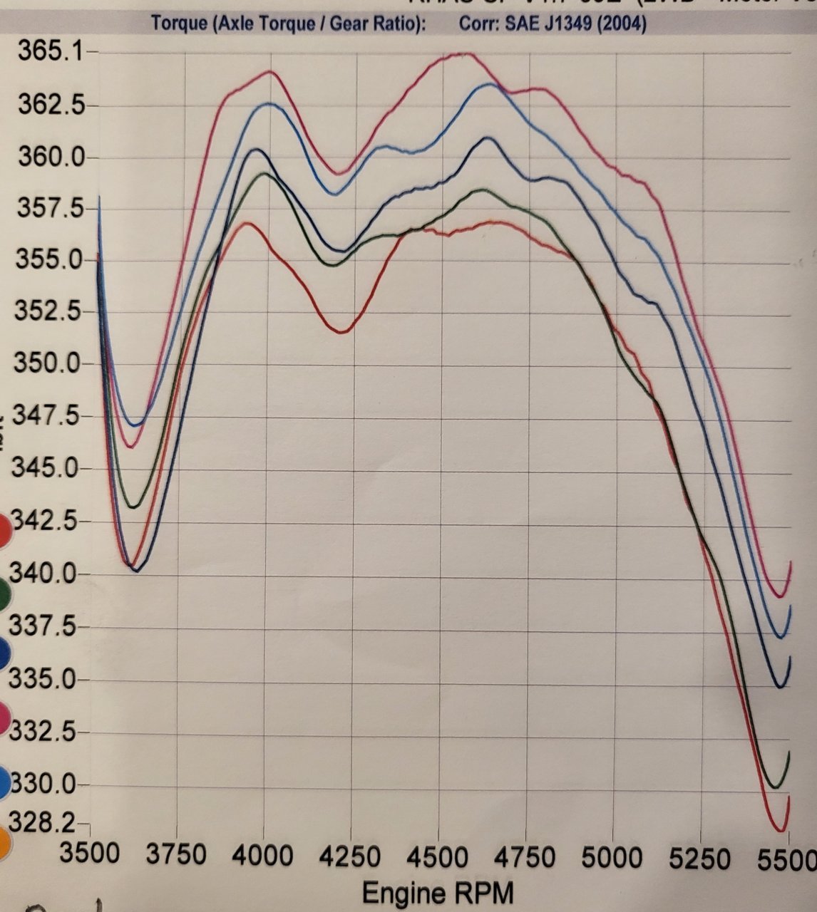

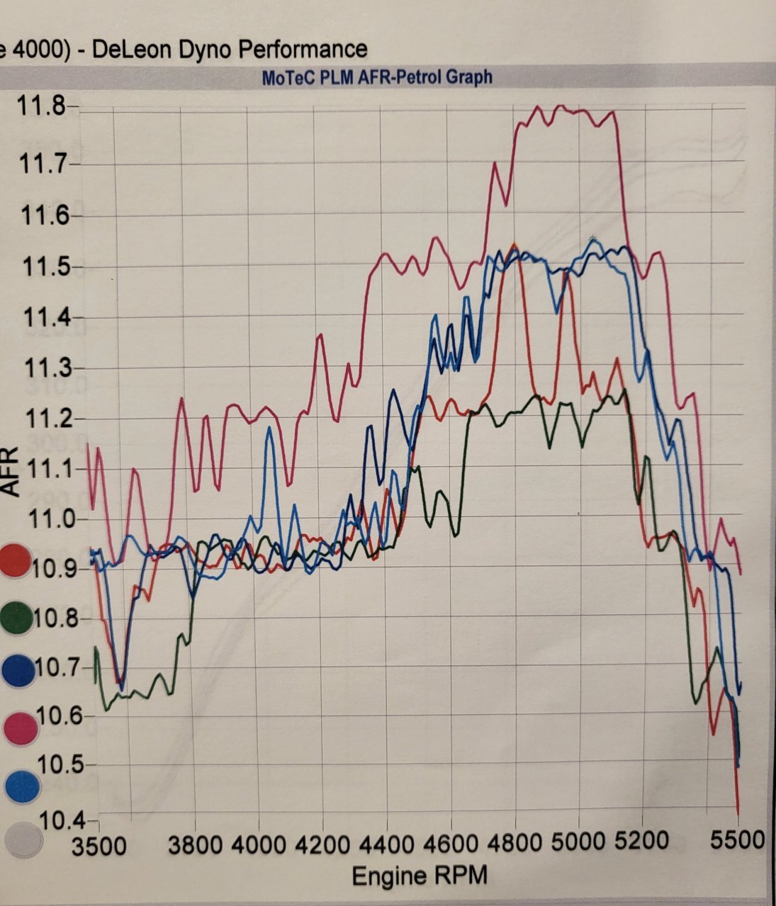

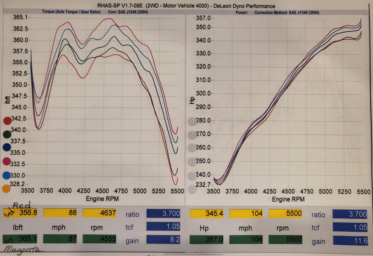

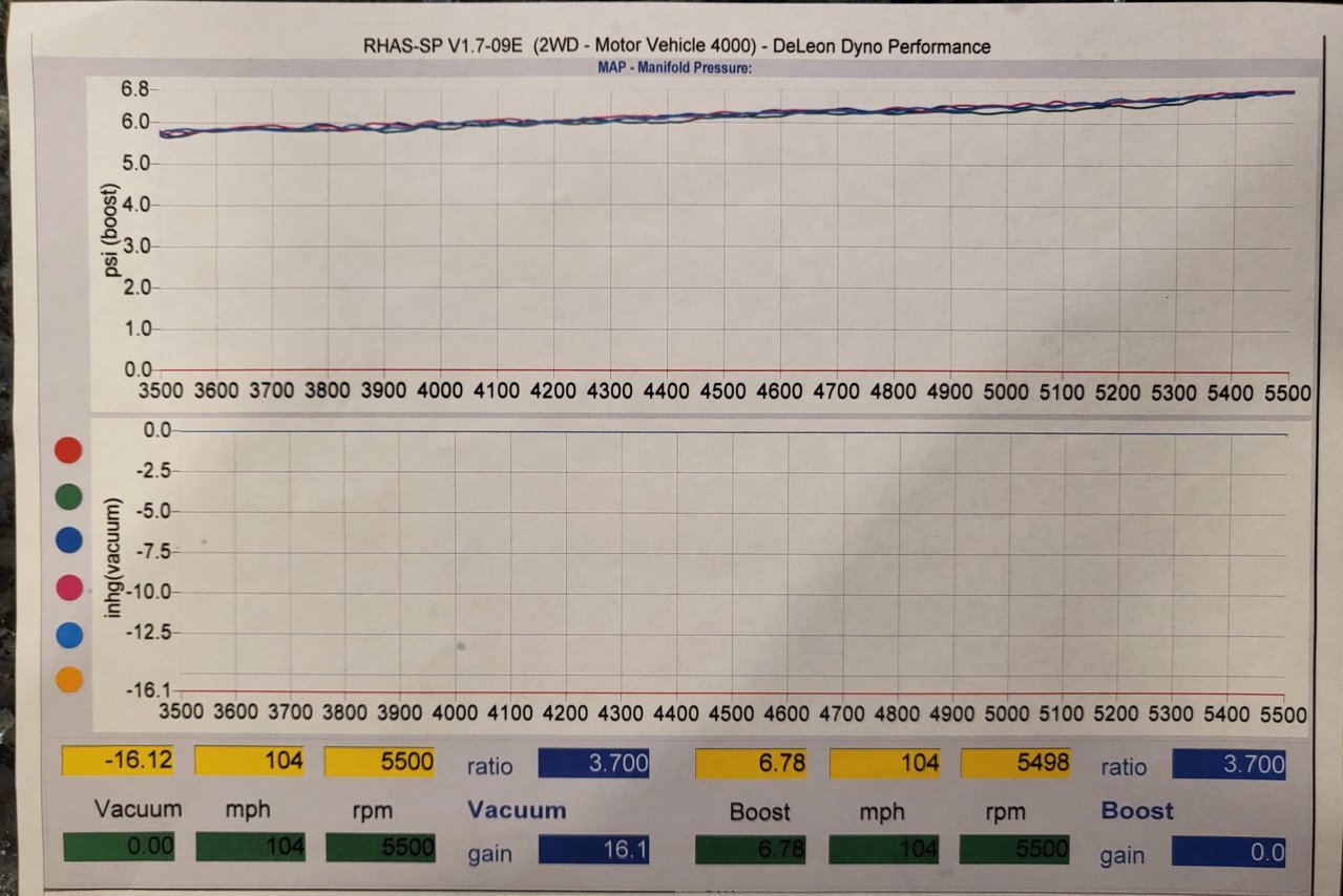

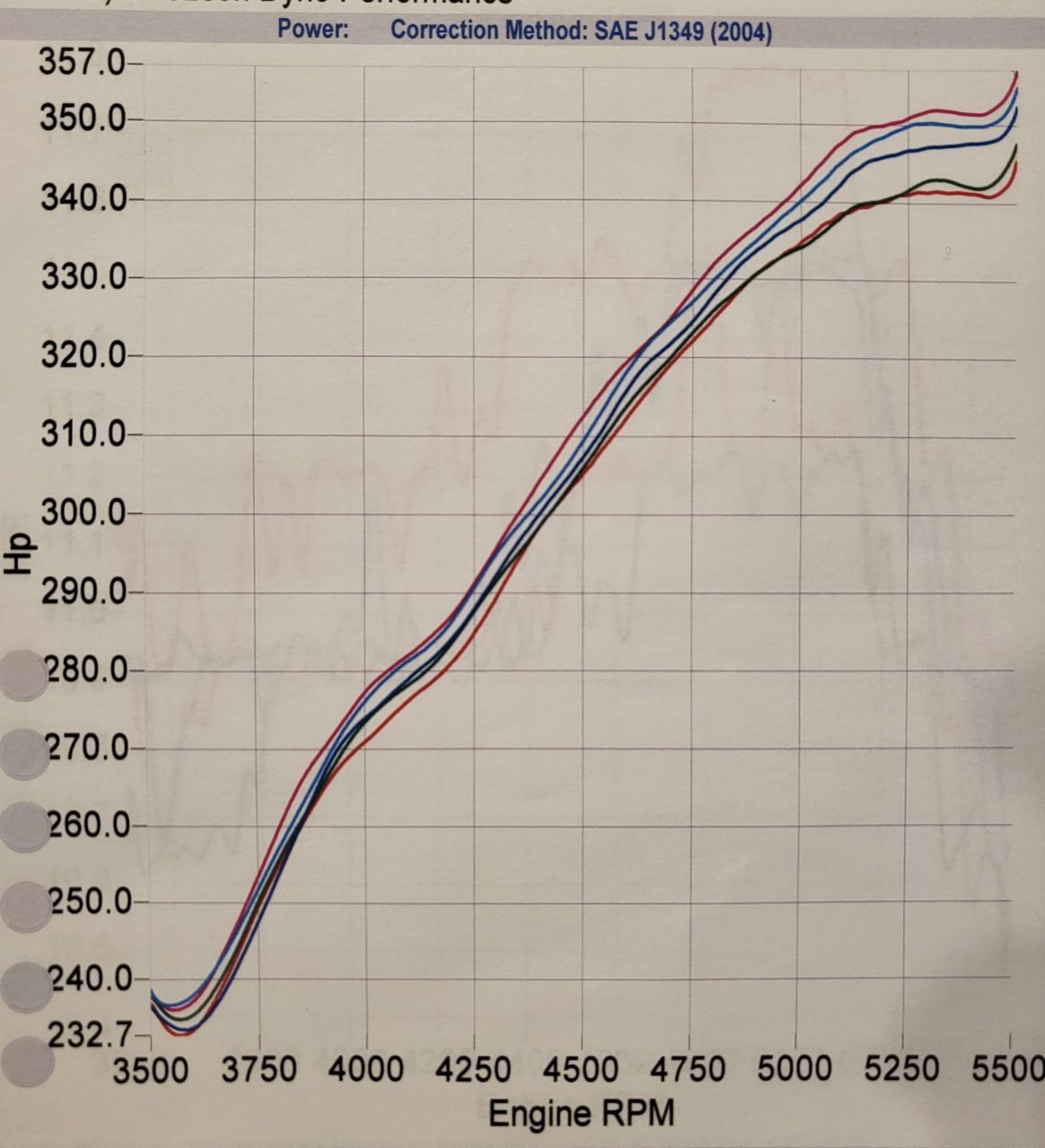

    Went ahead and got another dyno session today.
    2008 Tacoma PreRunner TRD OR 2WD
    4.0L 1GR-FE V6 (AT)
    113k on odometer (blower installed at 60k)
    3.73 rear end
    DeLeon Dyno Performance (Dynapack Dyno)
    Santa Clara CA 95051 (Elevation: 72ft)
    66°F 64% Humidity
    TRD Supercharger
    URD 2.85" stealth pulley
    TRD Gen1 CAI with Volant scoop
    76mm throttle body
    URD/Walbro fuel pump upgrade
    NST waterpump/Alt/crank pulleys
    Doug Thorley short tube headers
    URD Y-pipe
    https://www.tacomaworld.com/threads/ovtune-handheld-dyno-s.551687/ (May 30, 2018)
    Baseline: Max Power: 326.4 Max Torque: 371.8
    OVT 91Octane Max Power: 335.8 Max Torque: 371.7
    OVT 93Octane Max Power: 341.3 Max Torque: 379.5
    4 Years Later......Same mods in the list above plus
    • Boost Referenced FPR mod
    • OrangeVirus Tuning (OVT) Ver2.0 software (91 octane/93 octane) with speed limiter removed
    • NST TRD Blower pulley
    • RIPP Ignition Coils
    • NGK Ruthinium Spark Plugs
    • -2deg Exhaust Cam Gears
    OVT Ver2.0 91 Octane Max Power: 357.0 HP Max Torque: 365.1ft/lbs @4555rpm (Magenta line)
    OVT Ver2.0 93 Octane Max Power: 353.0 HP Max Torque: 363.0ft/lbs @4618rpm (Light Blue Line)

    Horsepower Graph
    Torque Curve Graph
    Air Fuel Ratio Graph
    Vacuum/Boost Pressure Graph
