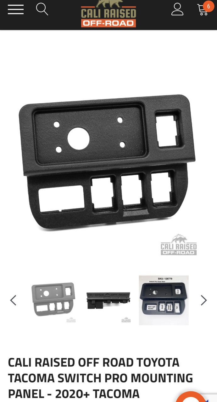

  13. Jun 18, 2021 at 7:48 AM
    #1373
    TheTacoAdventurer
    TheTacoAdventurer Well-Known Member
    Sep 3, 2013
    #111758
    799
    Boston, MA
    2018 DCSB TRD OR
    Forever modding!
    Random question but has anyone spotted a way to mount a Switch Pro on the left side of the steering wheel above the vent? I have the above mount, but am looking to run a 2nd Switch Pro and I'd really like to have it in better line of sight. I saw that SDHQ did the opposite putting it below the above panel: https://sdhqoffroad.com/collections...a-sdhq-built-switch-pros-sp-9100-keypad-mount but I feel like that will cramp leg space or I'd be likely to hit it all the time getting in and out of the truck.

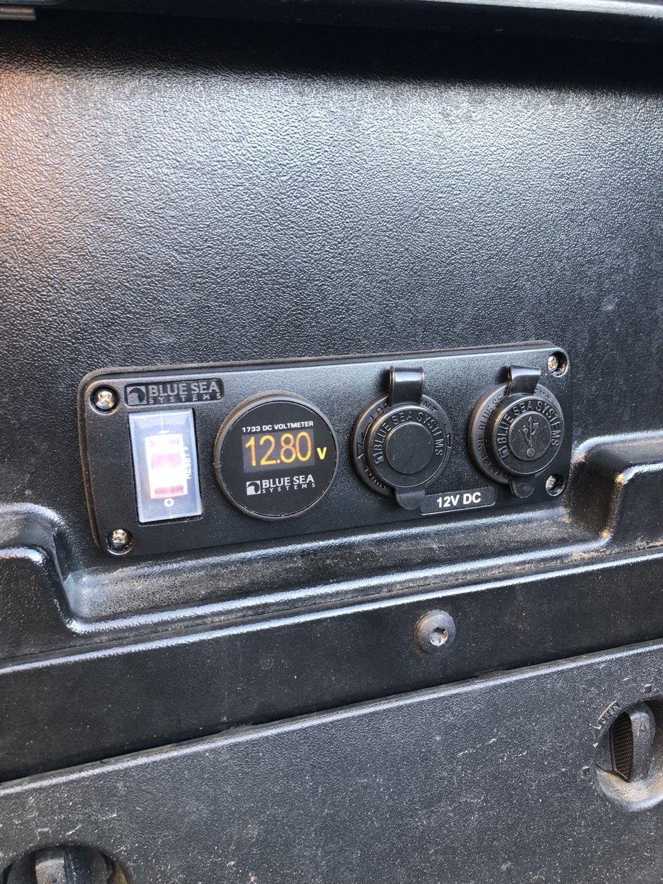

    I have this same thing in my truck bed. It has been super useful. I have it wired to my secondary batter so it wont kill the main.
