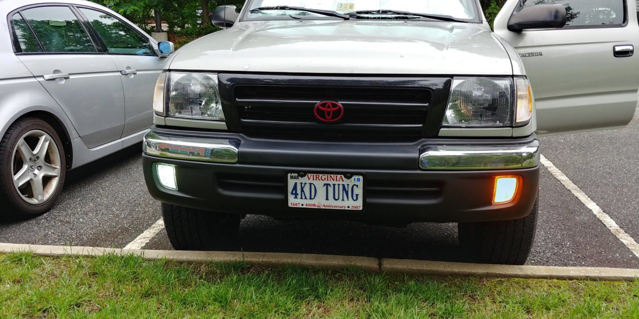

    Hey Colchicine thanks for linking that kit. It looks like it has a rubber 'fits all' seal that jams in the hole in the corner light. Is that right-- and are you happy with how that seals up the light body, or does it need silicone and attention in the winter?

    I had to change the wiring over to a relay that is triggered by a wire that only comes on with the engine.
    I wanted to change the signal light over to a switch back as well, but I couldn't find a kit that would fit the small bulb and socket that is in that lens.

    for the corner light switchback you have to use the kit colchicine linked, drill and silicone in a second bulb, or use a switchback controller that both on and flashing modes drive the stock socket which can be upgraded with LED.
    For the turn signals (below front bumper) the fog light mod thread shows the right switchback bulb to use but you need to upgrade your sockets to have the 3rd wire as they only stuffed 2/3 pin locations at the factory.
