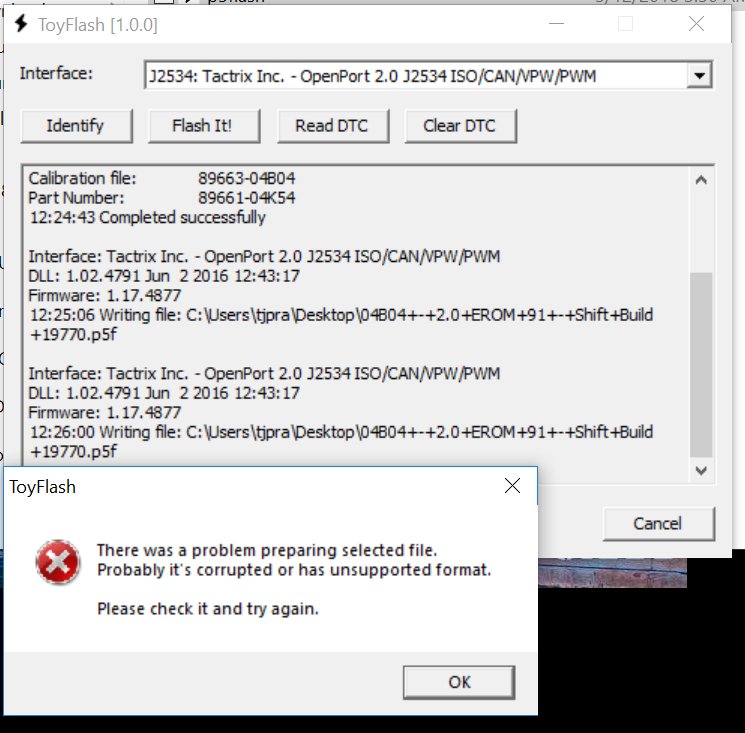

    Now if i can just remember how to flash lol.
    Last time was on the flash manager. These files look like they're on that page. Lemme see if i can figure it out.

    What am I doing wrong..

    Try updating your software. Click help, then update.
    Should be version 1.3.0.

    That was it. TY!
