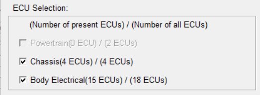

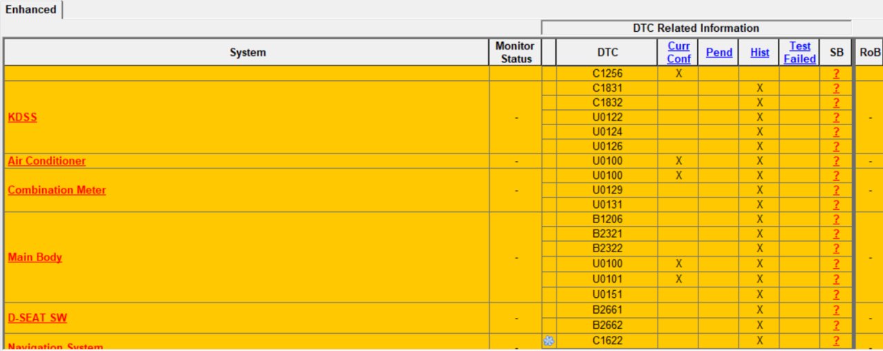

    Progress stopped on my 4r. The ECU suddenly stopped responding to odb/techstream. I found a broken positive battery terminal, but otherwise have no idea what's going on.
    The ProCharger is 100% installed, and I was able to flash it with the PC tune. It started up with a rough idle and was showing short term fuel trim on both banks at -20% throwing P0172/P0175 codes. I shut it off that night, and the next day it would turn over but not start, and was no longer able to pull codes.
    Fuel pressure is 35psi when turn it over and does not drain fast. No response from the ECU. The battery (odyssey 34r) did seem to lose charge quickly over night.
    I'm wondering if maybe the imobilizer was some how triggered. I'm tempted to try the 7/13 pin ECU reset and if not, pull the ECU and inspect the port. I may also pull one of the new plugs just to check it out.
    I just bought a spare ECU just incase it comes down to replacing it.

    Did the battery loose connection while you were flashing a tune?

    Not that I am aware of. I had the engine idle for a solid 30 minutes at one point after the flash and it was reading the ecu that night with no issues.
    tech stream reports 0/2 engine ecu's but can see everything else

    Sounds like it didn't get flashed, or it was the wrong tune. Was that done with the RTD device?
    I would double check for wiring issues and try to reflash again before putting the new ECM in there.

    The rtd flash completed, I didn't have any power interruptions and I believe it ate a credit. I went through all of the fuses many times with a multimeter, although a power probe just arrived and I'll probably go back through the fuses and relays again.
    This was running after the flash although just with a rough idle, I cleaned the maf and it wouldn't start up after that (no spark from what I can tell, no ecu communication)
