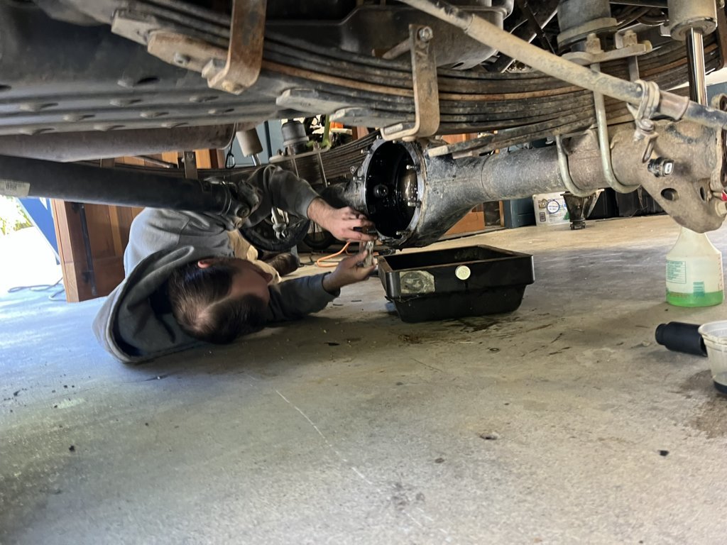

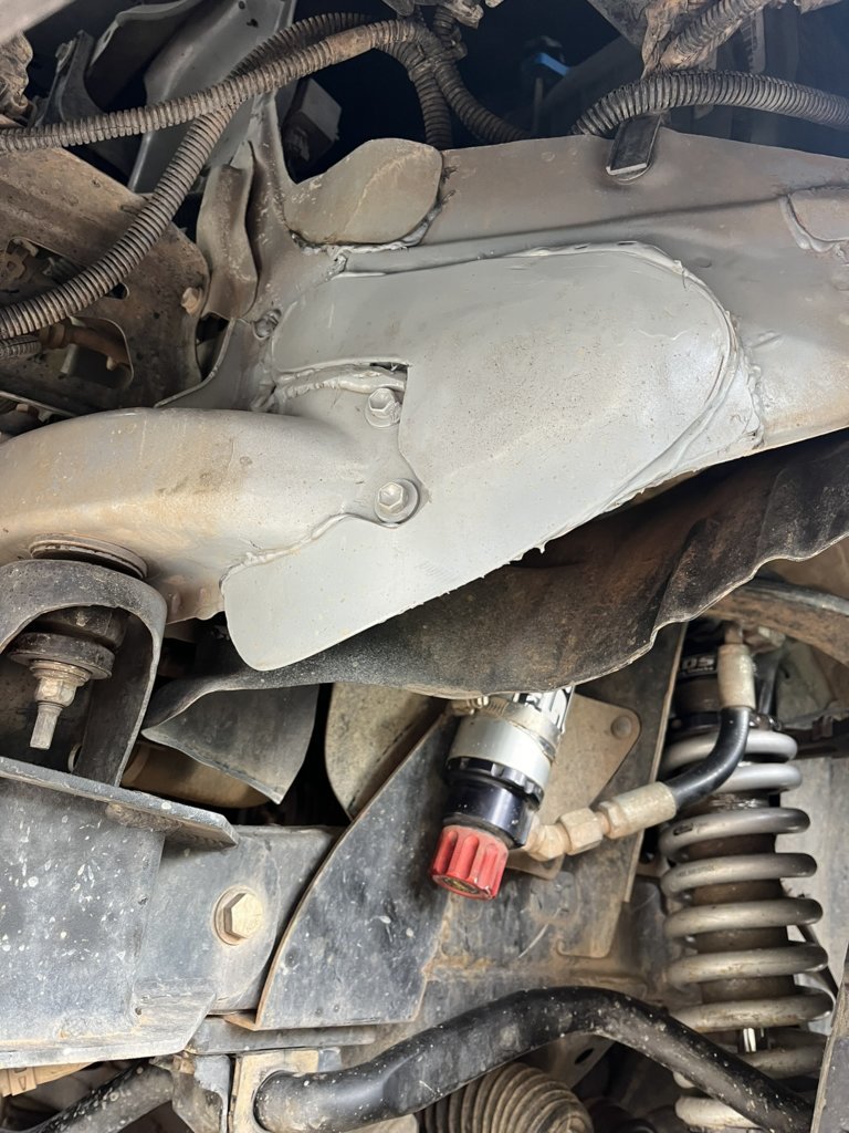

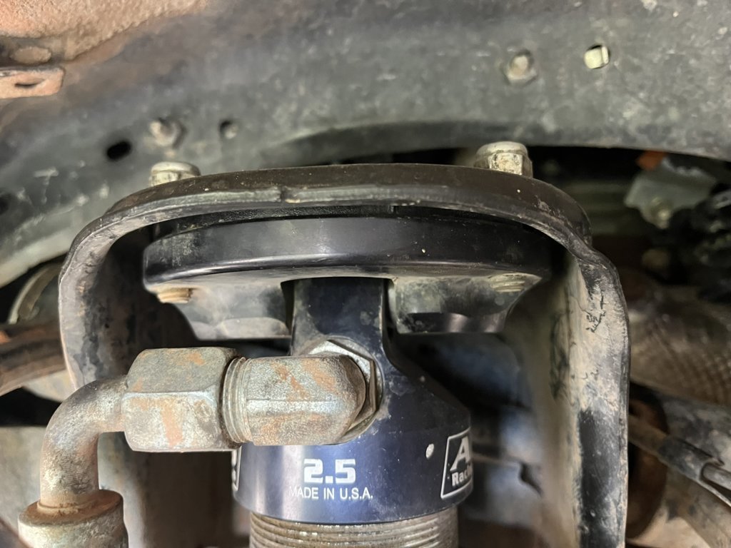

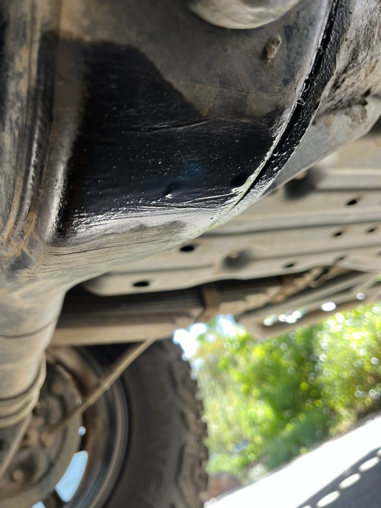

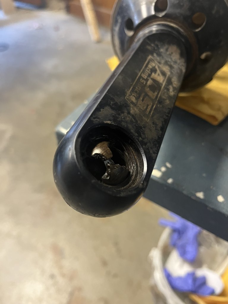

    Mechanically, there were no real issues. My first patch of my cracked sheet metal above my radiator core support failed somewhere in Arizona when I hit a bigger than expected whoop at faster than expected speeds. But it was still a success in my book, proof that the repair was holding the load of the sheet metal. So I upped the gauge, used some galvanized sheet metal (I learned that you can't bond to paint because the paint will fail), and thoroughly prepped all surfaces. I also switched to a different adhesive this time that is more viscous, which seems to adhere very well. So far so good... time will tell!

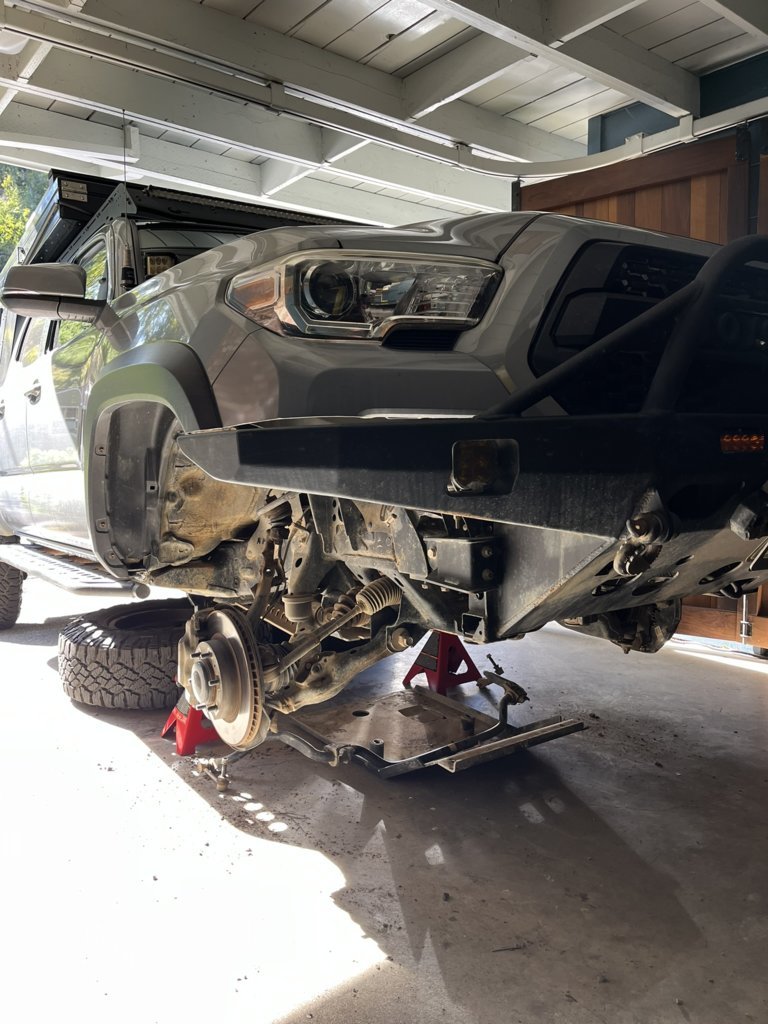

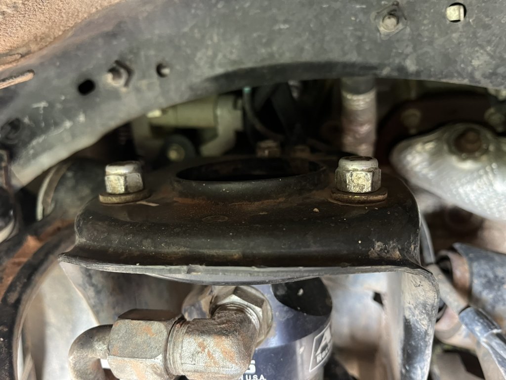

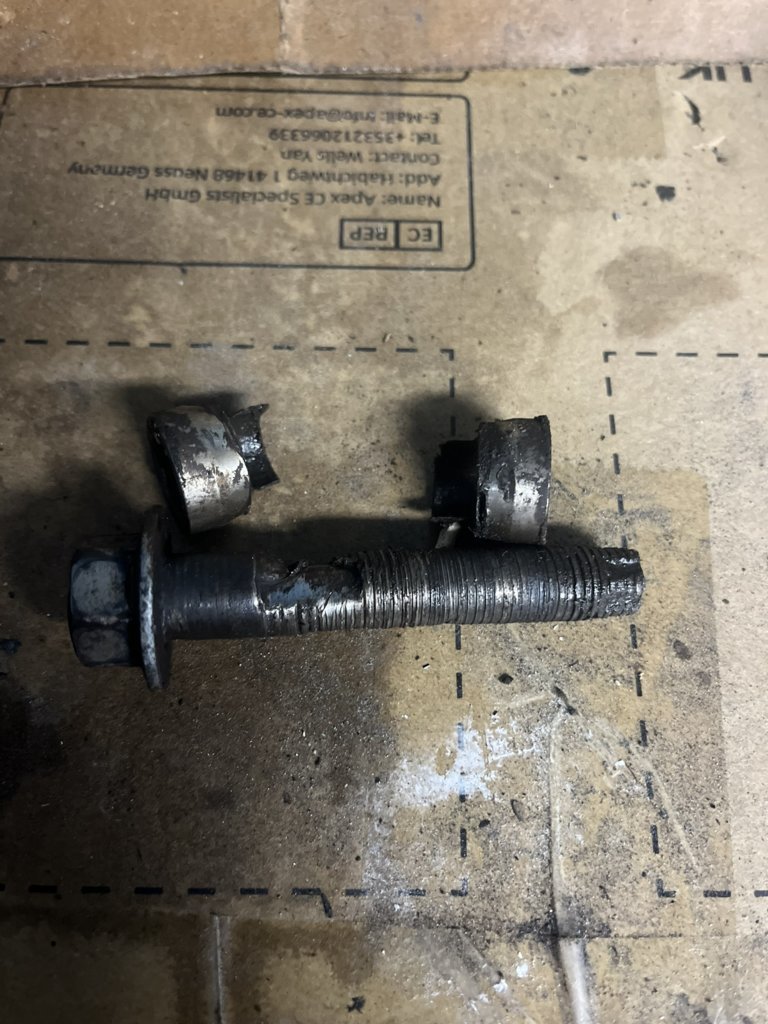

    I also discovered the source of my front end squeaks. Well... I already knew, I just didn't know how bad it would be. I've been planning on doing a shock rebuild soon, so I'd been ignoring my spherical bearings, but I could ignore no longer. I decided to add a 1/4" top hat spacer to my coil overs to effectively get 1/2" more down travel (extended bump stops keep from bottoming out the shocks), when I discovered that my spherical bearings, misalignment spacers, and mounting bolt were absolutely destroyed. What I thought was going to be a quick "throw on a spacer" project turned into a much bigger ordeal. The amount of bolt that was worn through was flat out scary. :eek:
    Fortunately I had an extra set of hands from my step dad, and fortunately 303 shock service had everything in stock that I needed. So out with the old destroyed bearings, and in with the new. Not surprisingly, all the squeaks and clunks went away, and the top hat spacer is working awesome. Much less topping out than before. I do wish I had about 2 threads more sticking through the nuts to fully engage the Nyloc features, but there is plenty of thread through the nut portion and I'm keeping an eye on the torque. I might throw some thread locker on there for good measure when I rebuild them too.

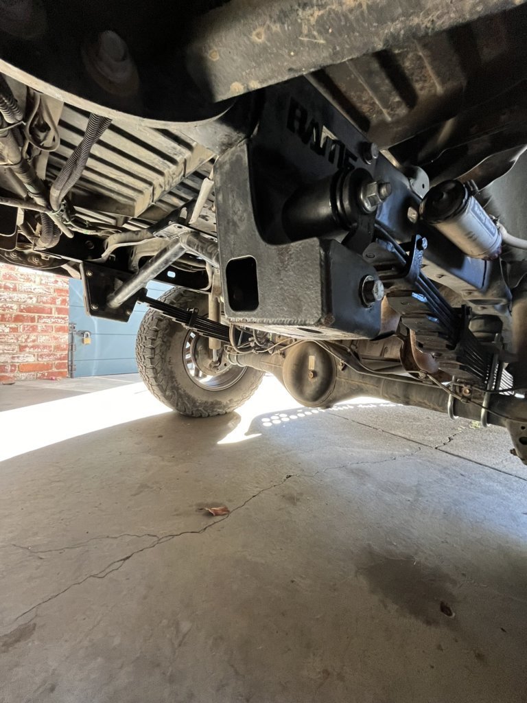

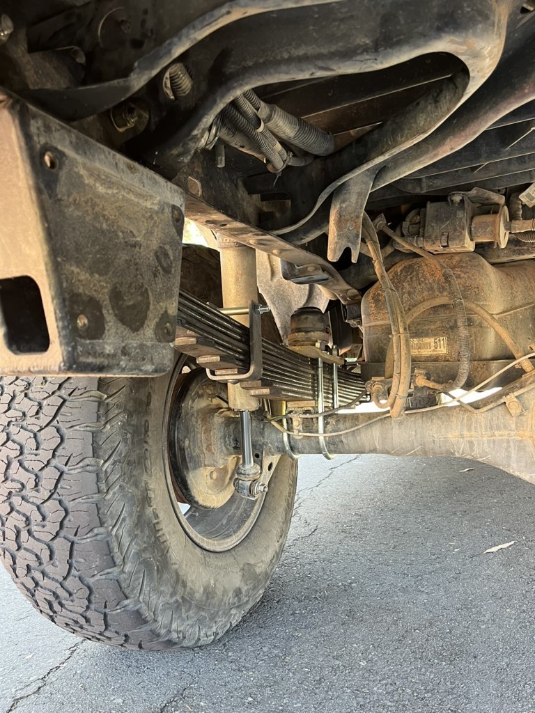

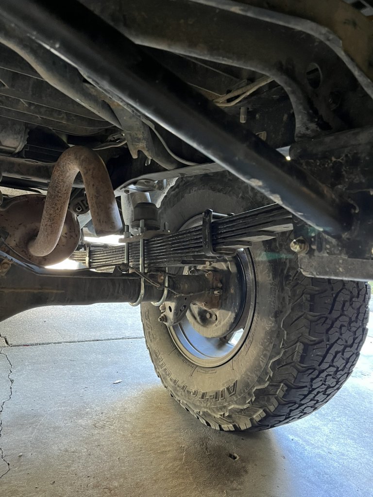

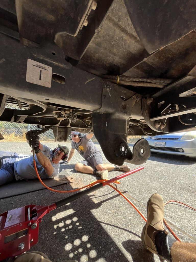

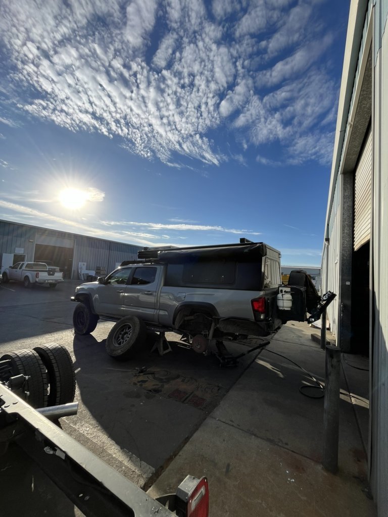

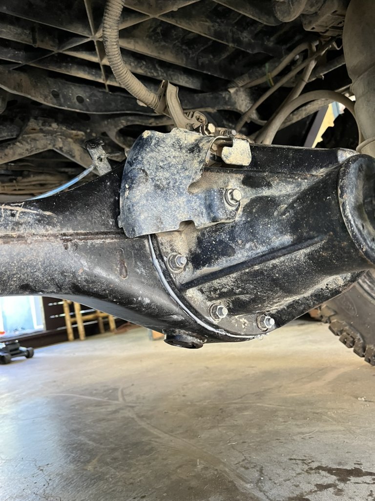

    Something that's been on my radar and that I knew would need addressing some day was my leaf packs. These have been a pain in my ass since day one, probably similar to most people. I had started with OME Dakars because frankly, when I first started this build, that was pretty much the only option. Everything from Deaver then was custom, expensive, and a long lead time. Things have changed, and some Stage 3 Deavers popped up used in my area so I decided to jump on it. And shit... while I was in there, why not do the BAMF shackles and hangers too, right? There just so happened to be a used set local as well.
    Anyone who says that the BAMF hanger project isn't that bad is full of shit. It sucks. It's loud, messy, and a frustrating process to remove all those rivets. I'm sure there are tricks to make it better, but at the end of the day you're removing stuff that was never meant to be removed, so it's pretty well designed to be permanent. Fortunately I had a couple amazing friends to help out, along with a great air chisel, and we got the job done. But it sucks! And to be honest, I don't think it does anything the factory hangers don't do perfectly well. Sure, maybe it's stiffer, but who knows if that's a good thing (see my posts on cracked sheet metal above the radiator body mounts after using stiffer body mounts). But whatever, no one seems to be reporting any downsides, now I have greasable shackle bushings, hopefully it's all good.
    UNfortunately, the Deaver Stage 3's just aren't enough spring for Chubbs. I had suspected this could be the case based on some other friends' setups. Chubbs is heavy, especially with that BAMF dual swing out, and even more so when I'm carrying a bike rack and bike. So I needed to do something so that I could actually carry some weight and have some up travel before hitting my bumps. Funny enough, even with how limited up travel I had and how flat these leaf springs were, the ride quality was appreciably better than with the Dakars. Planted? Not by any stretch of the imagination. But very linear feeling, with no harshness when the bumps engaged.
    So I called Deaver to see what they thought I should do. These folks are great, and he gave me some options. 1) I could come in and they could get me sorted (unfortunately they are in SoCal); 2) I could ship my leaf packs and they could add a leaf to them; 3) They could make a custom leaf pack for me; or 4) I could find a local spring shop to make and add a leaf. So I called around, and found Valley Spring Works in nearby Dixon. The owner was great, and said I could bring my leaf packs over and they would add a leaf, or I could bring the truck and they could do the whole thing. Well, they are an hour away, I wanted him to look at my springs under load to decide the best option, so it just made sense for them to do the whole thing. Yeah, it cost an extra $300, but then they had full control over the outcome, so that's what I opted for.
    The end decision was to add another leaf, use leaf stock that was the same thickness but wider so it would have a bit more carrying capacity, and that he would taper in around the u-bolts. He was also going to re-arch the whole pack, and we decided to throw some 3 degree shims in there as well to help ensure good pinion angles. Of course that also meant new retainers and center pins. While the leaves were out, he measured the hardness and found that Deaver uses a few softer leaves in combination with harder leaves, which is maybe how they get different progression in their springs. I also had him spray all the leaves with dry moly spray lube, which Deaver recommends doing to reduce noise.
    Check out this beast!
    In total, it ended up being about $600 in materials and $300 in labor. So in sum total including what I paid for the used leaf pack, about the same as a custom leaf pack from Deaver, which I suppose this basically is. And it was installed, which is an added bonus since my back was not in a good place those days.
    Finally!!! We have a rake again, we have up travel, the shocks are at mid stroke, and the "stance" looks soo good! The leaf springs feel great too. I backed waaaay off on my compression adjustors and the suspension is feeling really good. I do have some groans coming from the leaf springs, so I might try to get some more lube in there to see if I can quiet them down, but such is life with leaf springs. All in all, I'm finally super happy with the suspension!

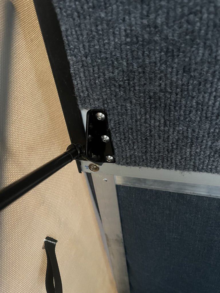

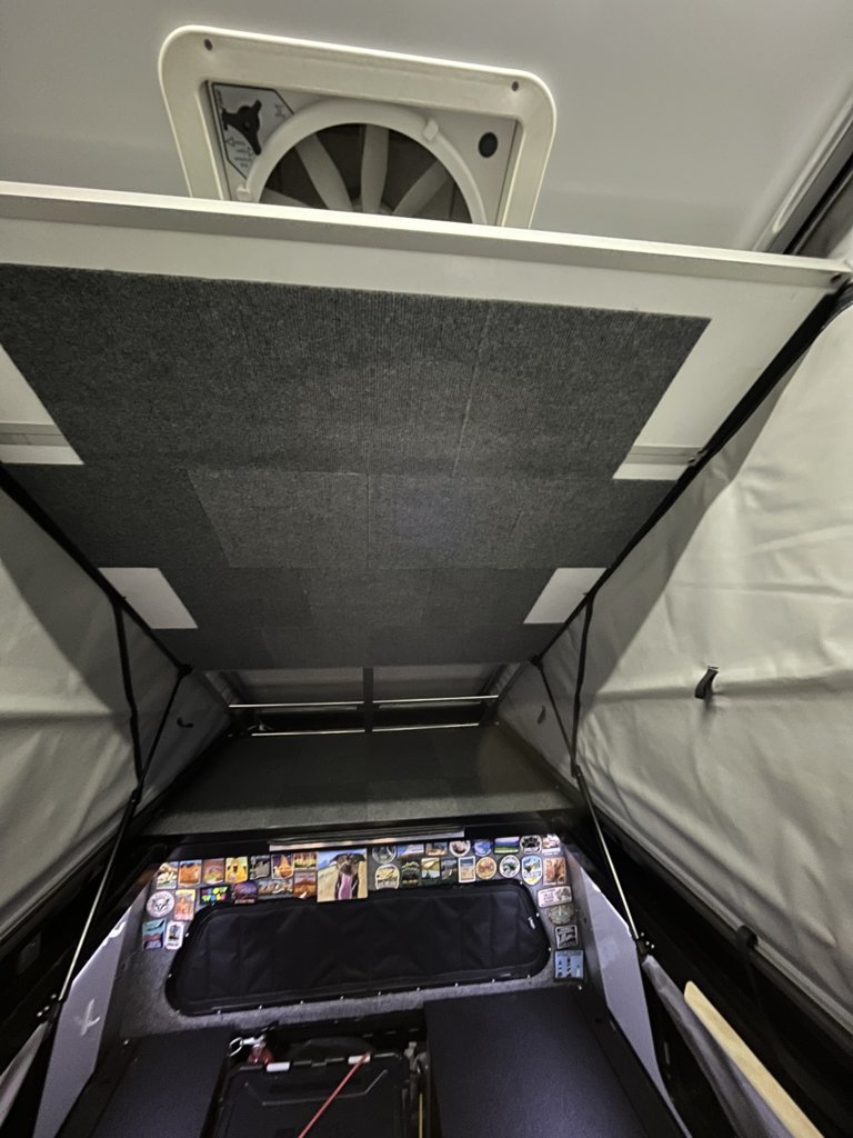

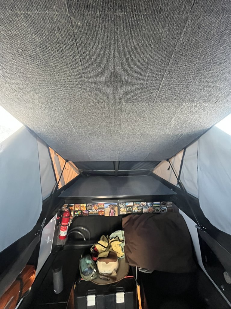

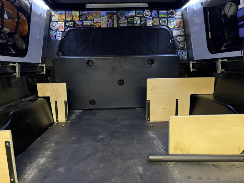

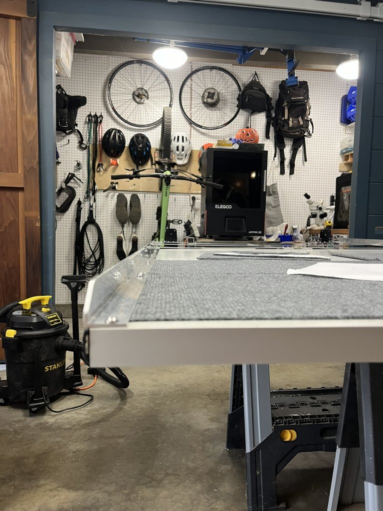

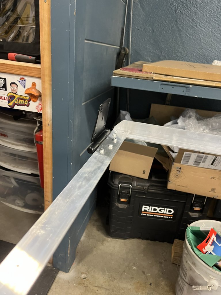

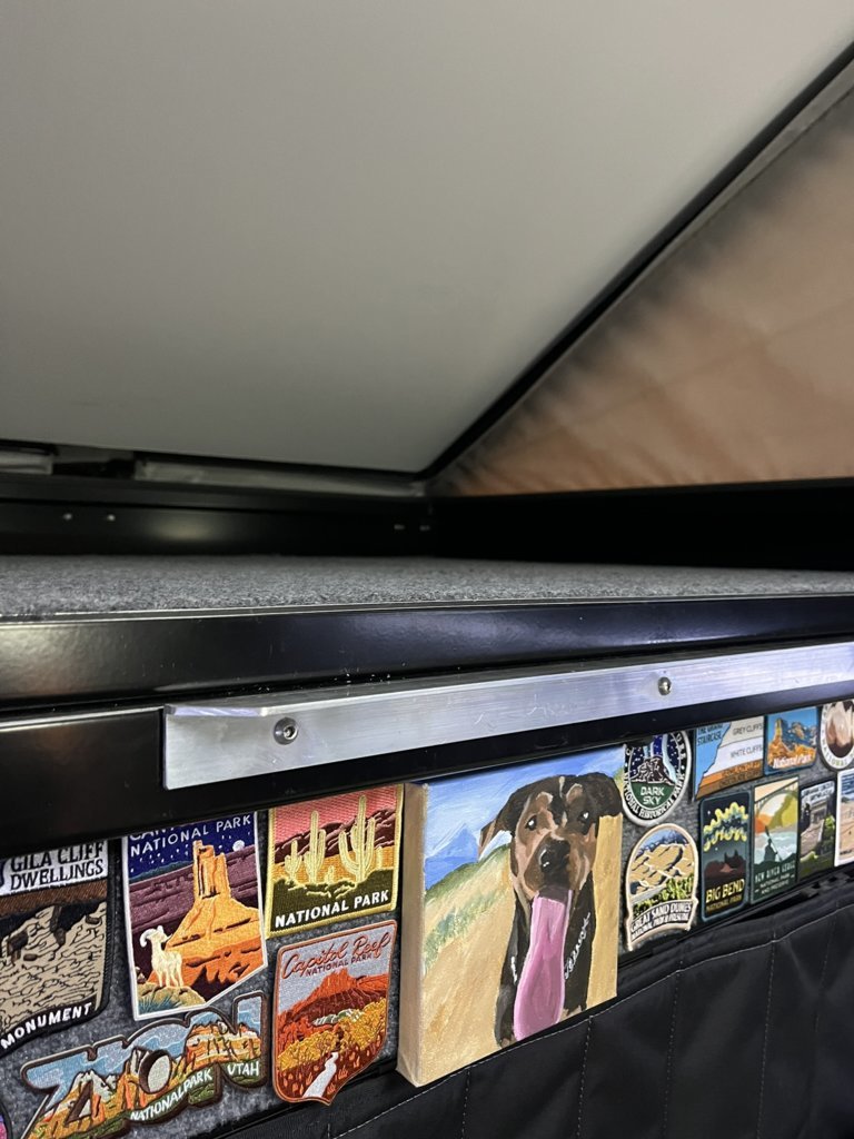

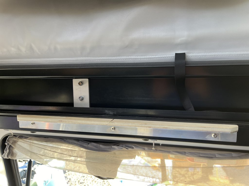

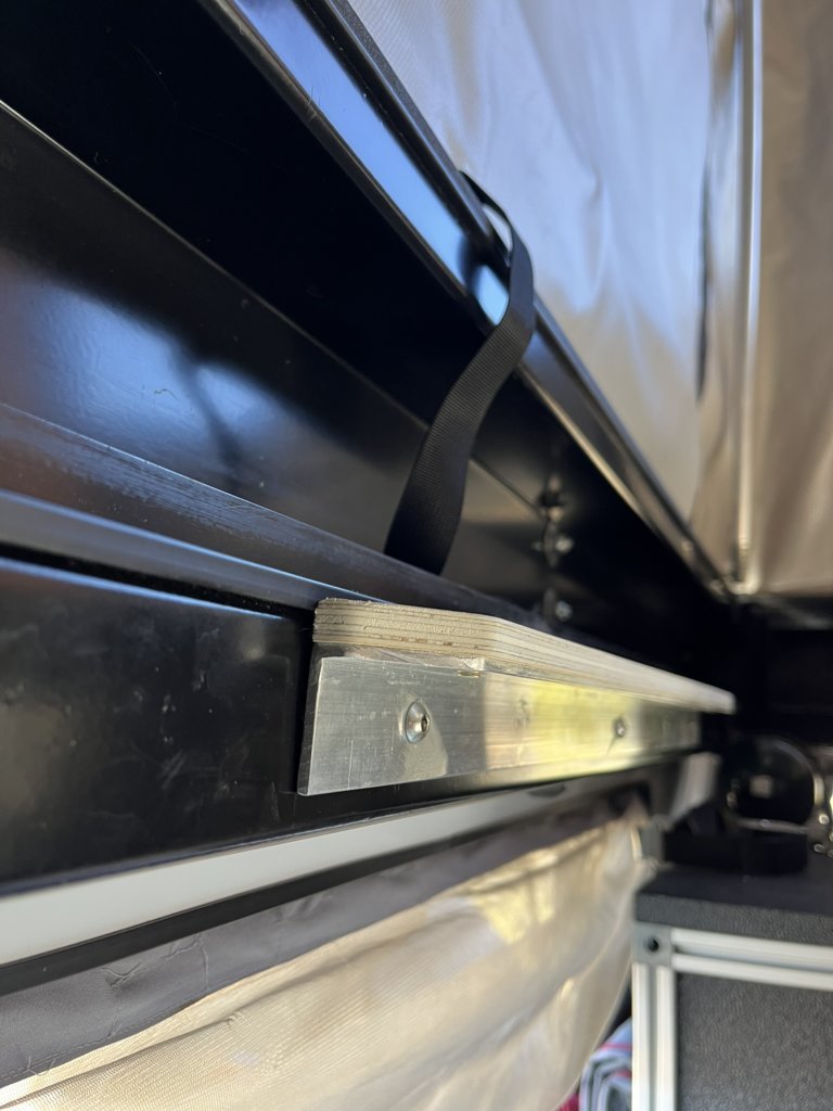

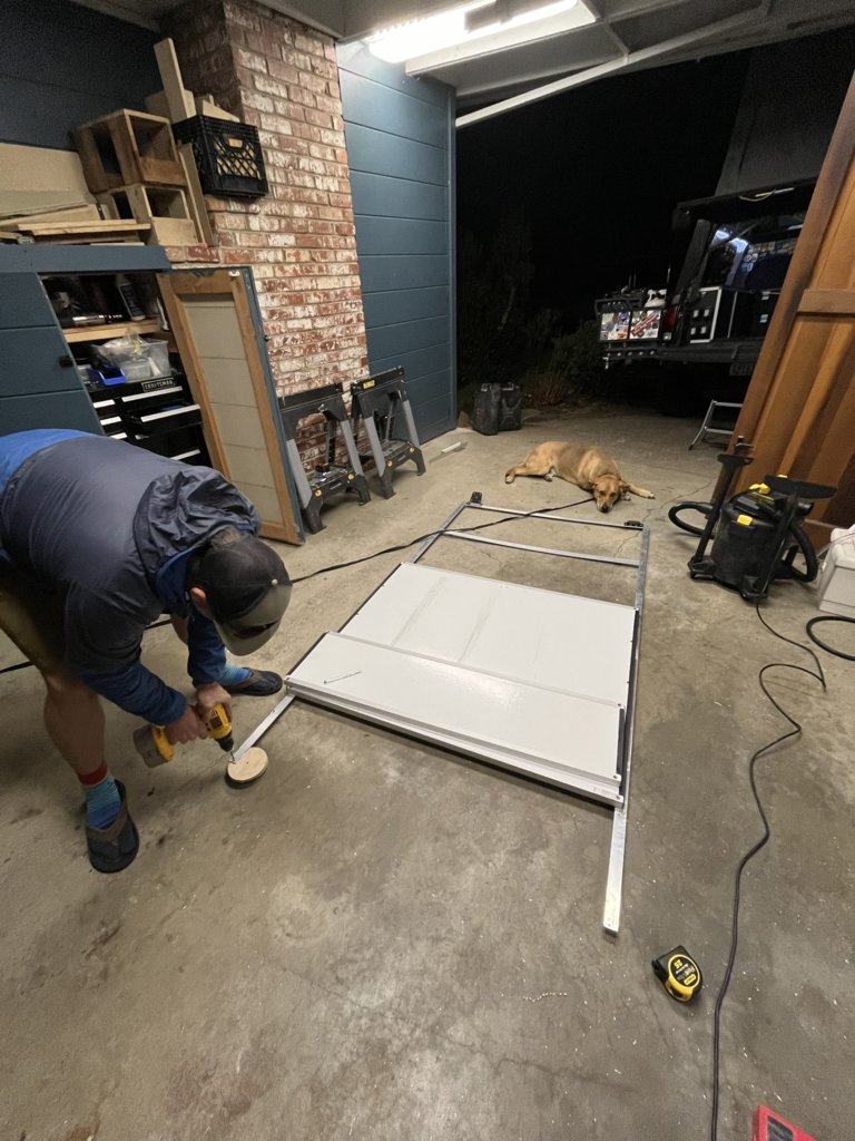

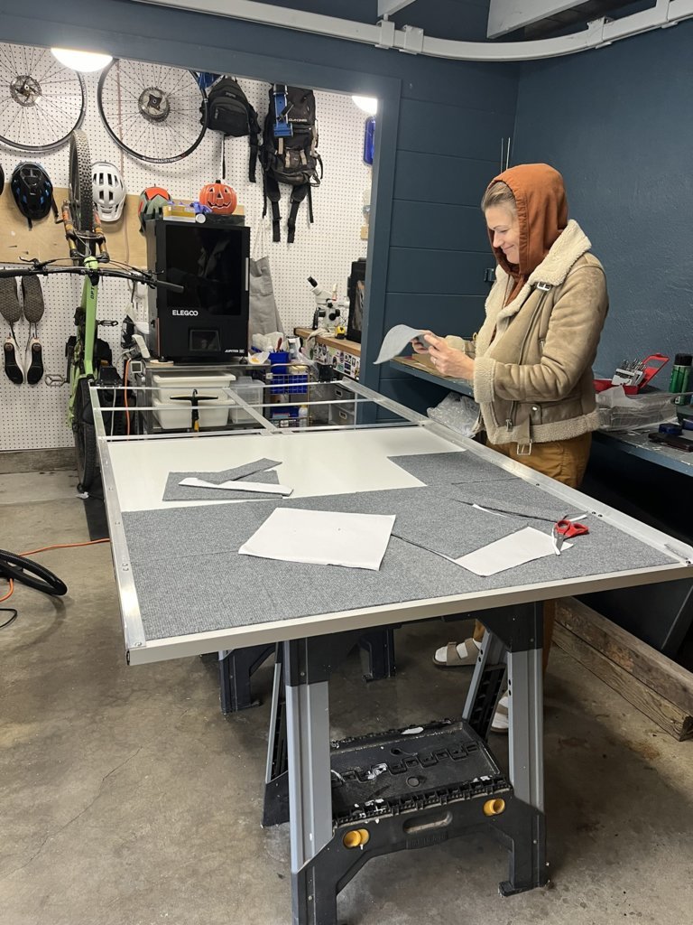

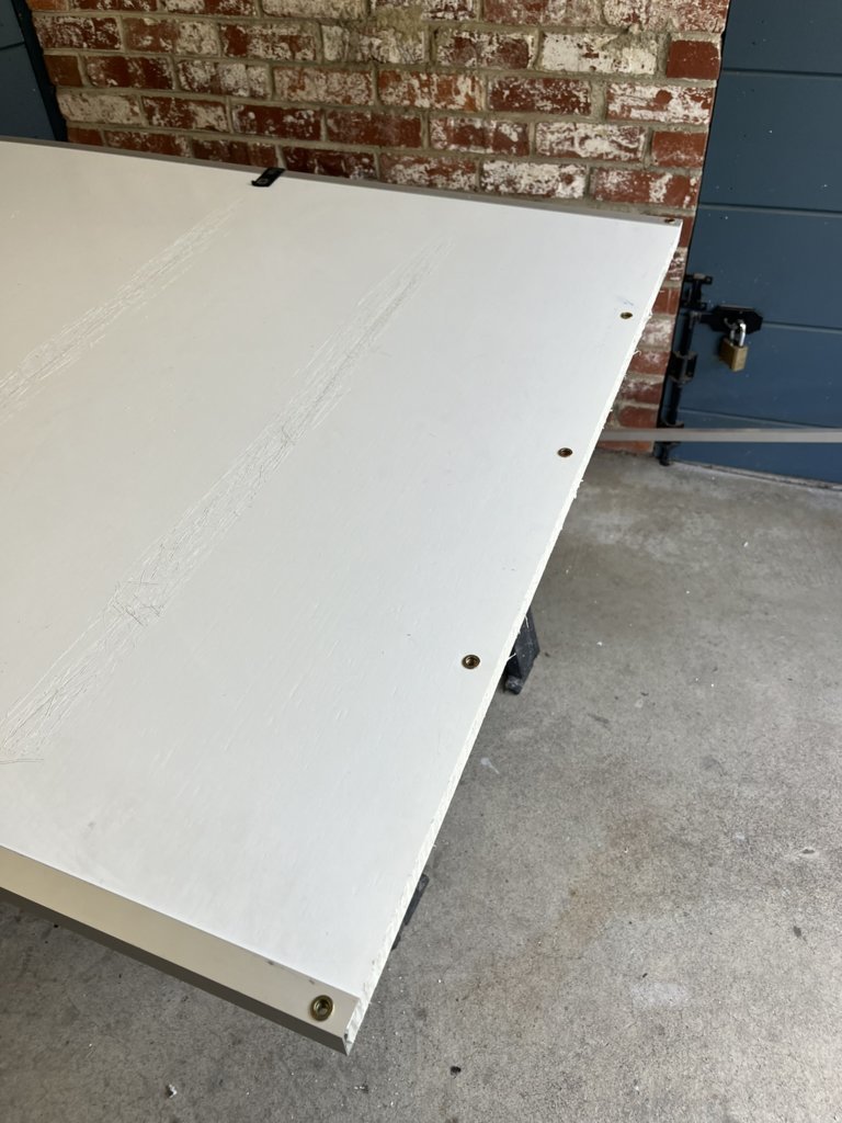

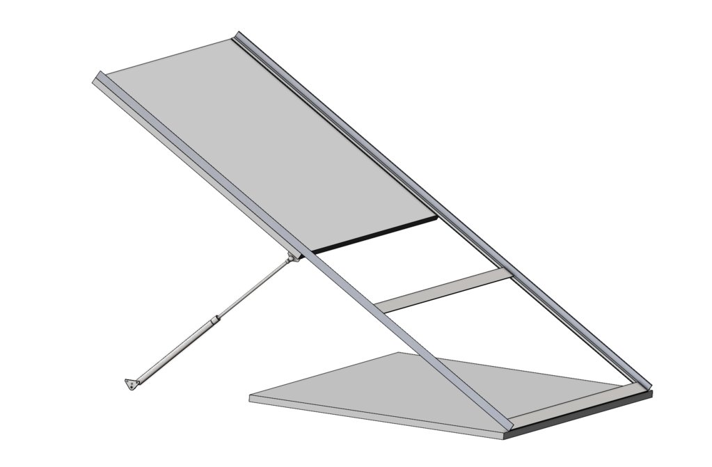

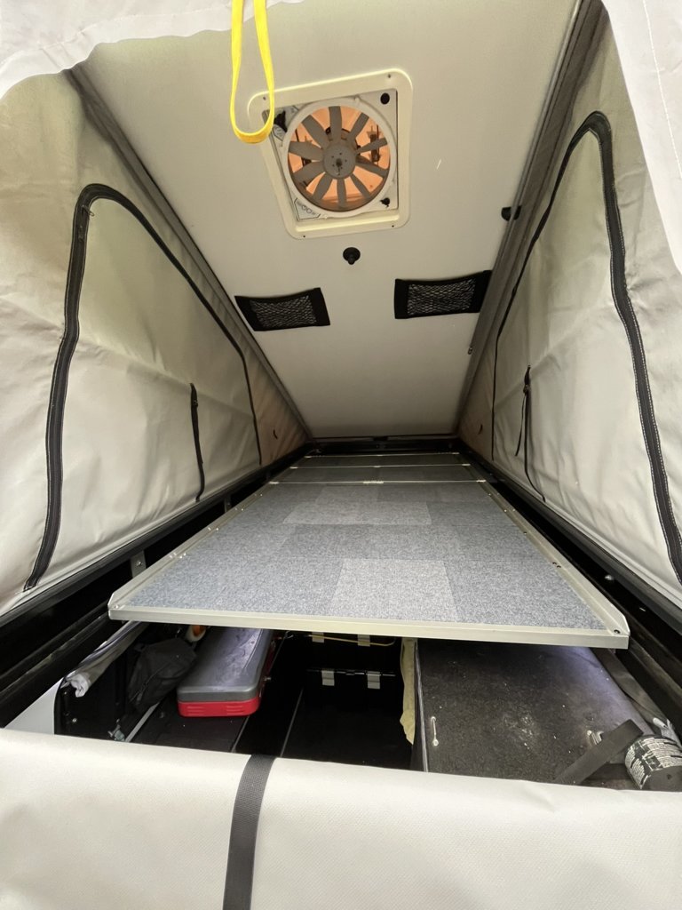

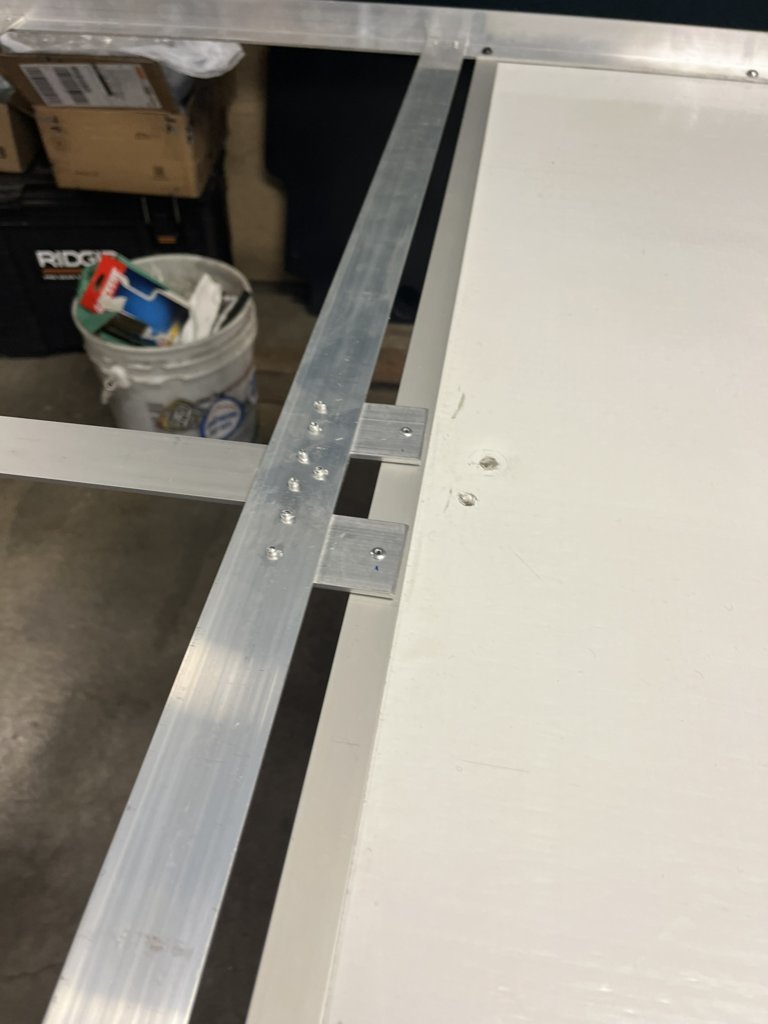

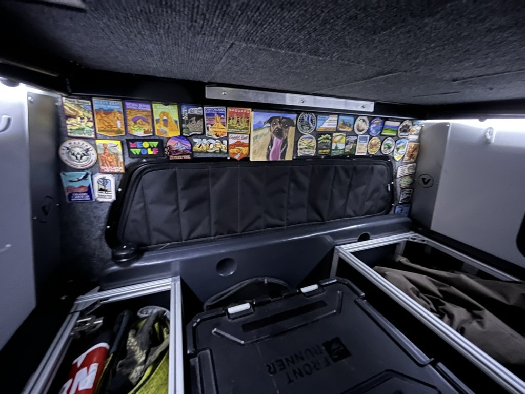

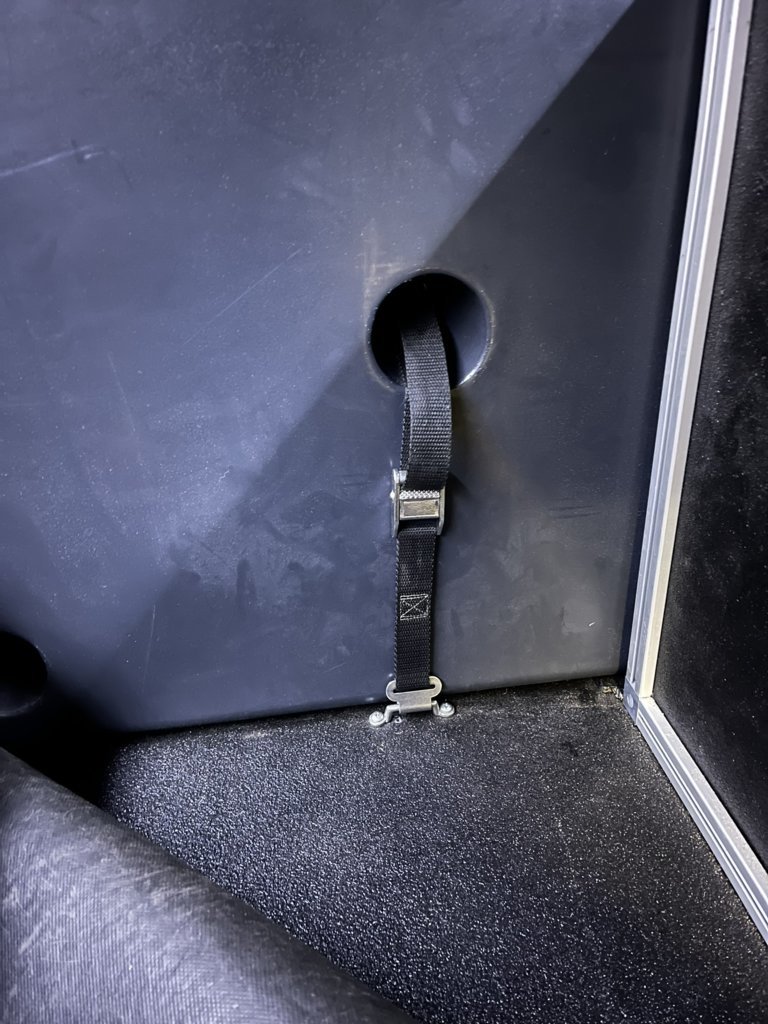

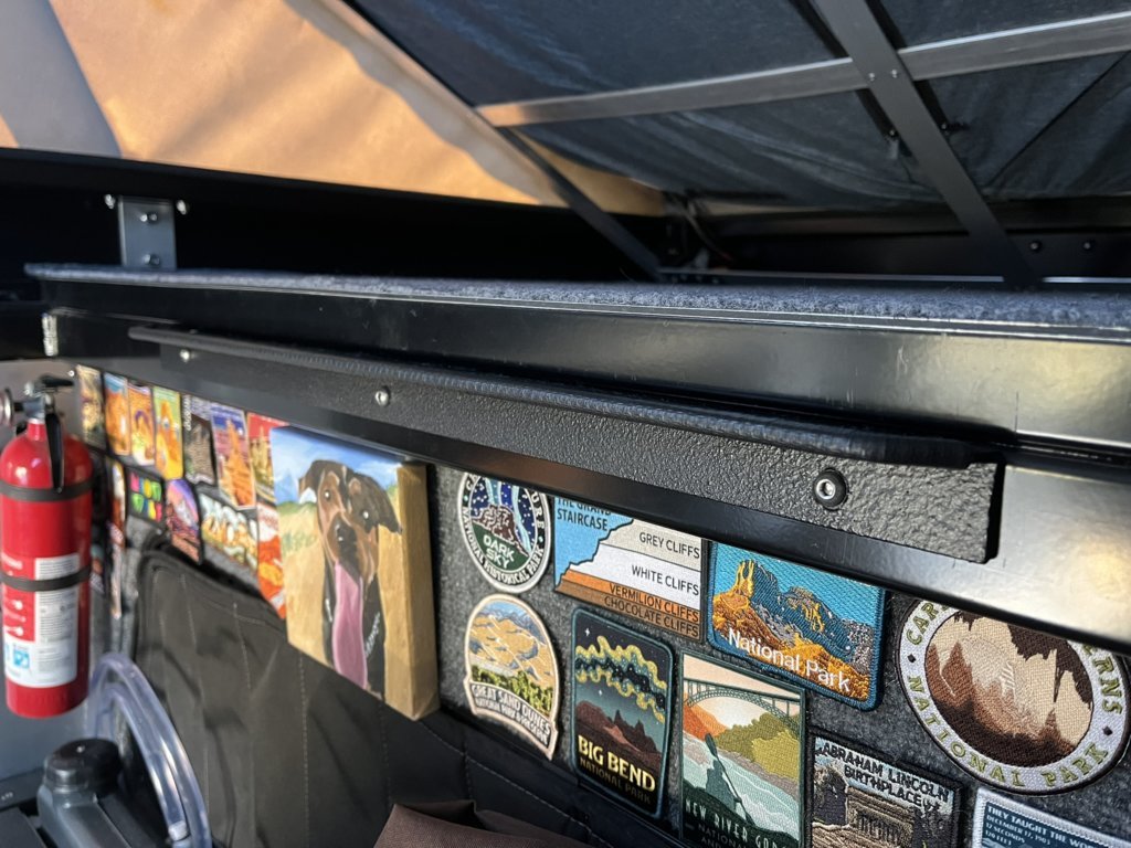

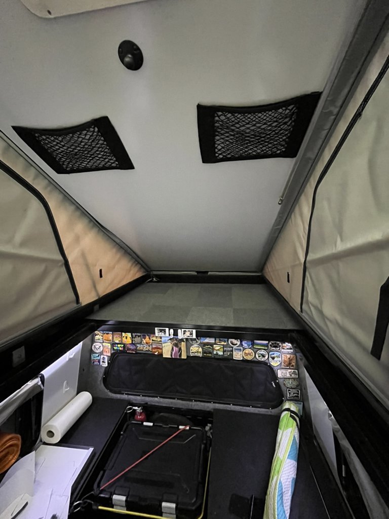

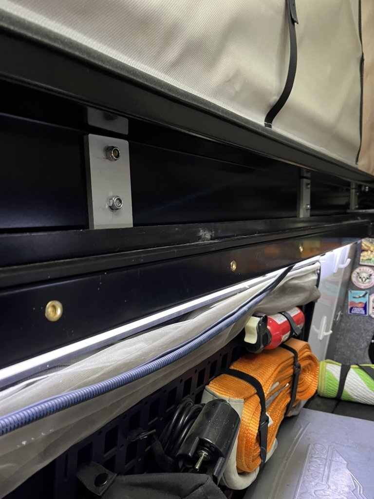

    Sometimes I get ideas in my head that I just can't shake. I noodle and noodle and noodle, and then the only thing left to do is do it. That's this project for sure.

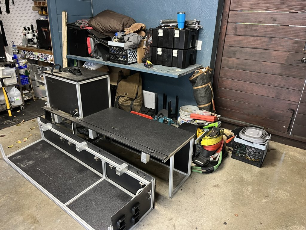

    One thing I've always hated about the Drifter is how annoying it is to stow the bed. Shifting the panels is totally functional, but the ergonomics suck. You have to fold the mattress up, jam the panels underneath, they always want to jump off the track, and if you have the bedding up there it's an even bigger PITA. Anyway, I hate it. And when I saw my buddy's Alucab with a bed that lifts up, I just new that's what I needed.
    So then I got to noodling. I found a couple other folks who had done a lift up bed in their Drifter - one being Christin Whettin's (@Badassbrunette) old setup, the other being Haven Overland's build here on TW. So I knew it was doable. Both used an aluminum frame with plywood, and some gas struts to lift it up. Simple enough, right?
    There were a couple of key things I wanted to be sure to be able to address with this: 1) Add carpeting under the mattress to help prevent condensation; 2) Still be able to keep our sleeping bed and pillows up top. As is, we are right at the absolute limit for being able to close the top with our Hest mattress, 2 pillows and double sleeping bag. I would be removing the condensation pad from under our mattress, but that is at most 1/4". So keeping it minimal profile was absolutely critical. And even though I do know how to weld aluminum, I don't have an easy way to weld aluminum. Fuck it, rivets work damn well right? And my last design decision was rather than use plywood, I would keep the existing foam/aluminum composite bed panels as the main platform, and just modify them to work with the new frame. I mean, they work well enough as a bed platform, they're light as hell, insulated, why not?
    Being the type to over-analyze everything, I started in CAD with the basic layout, determined what length struts I would need (I don't understand why so many people mount gas struts the other direction), then calculated the total weight to estimate how strong of struts I would need. Then I added a bit more to be safe. So I ended up at 50lb struts

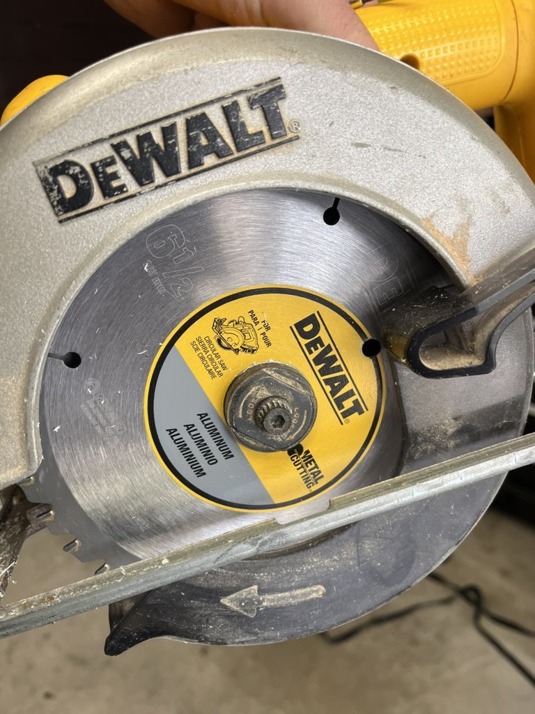

    The first thing to address is that the panels needed to be cut down to allow them to lift all the way up. The panels are aluminum skinned foam composite with aluminum U-channel end caps. I got an aluminum blade for my circular saw, and holy shit it cut like butter through this. Absolutely blown away. I ended up cutting them down to 47.5" overall width, allowing 1/2" of clearance with the camper frame to allow it to lift up.
    I placed 1/4x20" riv nuts around the border of the bed panels to allow them to mount to the frame. I really thought the skin of these panels was more substantial, maybe 1/16", but in reality these are foil thin. They have amazing rigidity given how thing the skin is. They're so thin that it kind of worried me, so I ended up flipping the panels over so that the flange of the riv nut was on the bottom side to take advantage of the surface area. And then I put a couple extra in for good measure. I don't know why the hell I drilled these holes first instead of drilling the holes in the frame, then lining them up with the panel, but that's what I did and came to regret later on. Word to the wise - drill your frame mounting hole first, then do the ones in your bed panel! Also, if you don't want to use rivnuts (which definitely have their limitations, just through-bolt them or use binding nuts.
    I built the basic frame out of 1-1/4" x 1/8" angled aluminum, with 1-1/2" x 1/8" flat aluminum flat stock and all riveted together. I cut all the aluminum to size using my miter saw with an aluminum blade and holy shit did that work well! All the flat stock really does is provide a hinge point for the frame, and support the bottom half of the mattress, so where others have used plywood I took a gamble that the flat stock would handle that, but allow the mattress and bedding to compress when the lid is closed. Then Adam (@RangerComa) and I took to mounting it to the panel which I had already installed rivnuts in :censored:. What a pain in the ass. We figured out a method that worked and got everything pretty much perfectly lined up, but it was definitely frustrating and not recommended.
    After putting the center strap in, I realized it would have been way smarter to have it connect to the lip of the bed panel. So I added a couple tabs. I wish I had thought of it before so I could have just cut that piece a two inches longer!
    I used big ol' 1/4" rivets to secure the hinge to the frame. This hinge is ridiculous, but the only ones I could find that lay completely flat are gate hinges or piano hinges. And I also ideally wanted something about 1/8" thick so it would sit flat to the bottom of the frame. All that I'm sure is over-thought, but that's what I wanted so I ended up with some big ass hinges. They work great though, and they were cheap, so what the hell.
    While the bed was out, I went ahead and carpeted the front bed panel that is part of the camper itself. I'm a big fan of adhesive backed carpet tiles for projects like this because they're cheap, easy to install, look decent, and if one of them gets damaged/stained, you can easily just replace that tile. Of course being cheap, they don't all match perfectly, but the camera really exacerbates how different those shades are.
    With the platform mounted to the aluminum frame, I employed my wife to do some carpeting while I installed some bracketry in the camper.
    Now to figure out how to get this thing to support our weight. The original design has the platform overlapping the side rails of the camper. Unfortunately, at that width they also hit the lip of the frame just above the bed panel, hence why I had to cut them down by a few inches. That means that I needed something to hold them up to the side rail. So I decided to create a lip for the platform using 1-1/4" angled aluminum sections that I would bolt to rivnuts installed in the sides and front of the camper. And then I set Adam to task with drilling said holes :D. Fortunately, he brilliantly observed that the LED light strips and camper wiring run right behind where we intended to install the rivnuts. So with careful measurement and planning, he threaded the needle and found a safe window for them to go. We ended up having to mount them lower than expected, so I added a 3/8" plywood trim to the top of the side pieces to make up the difference.
    Then we looked at it, and I said, how the fuck are we going to get this back in there? Well it turns out that the back tent window is just barely wide enough to pretty much fit it in there. Fortunately vinyl has a little give to it. Thank goodness because the alternative was disassembly or taking out the cabinets. But we got that sucker in there, and it felt rock solid on the platform mounts.
    The last thing to do was to mount the struts. Long story short, those composite bed panels are not strong enough to just use sheet metal screws. I ended up replacing with 10-32 rivnuts, which I also placed all the way through the panel with backer nuts. It's maybe overkill, but 50lbs is a lot of force on those brackets. And finally, lift off!
    The sucker works! Without any mattress or bedding on it, it's kind of a scary amount of force to get those struts to come back down. But with additional weight it feels very controlled and normal. And it lifts up beautifully with all the bedding and pillows. I still have to finish up the carpeting on the underside, but otherwise I'm pretty stoked on how this came out!
    rob1208, d.shaw, Ngneer and 1 other person like this.
  7. Nov 20, 2024 at 2:13 PM
    #287
    essjay
    essjay Part-Time Lurker
    Nov 29, 2018
    #274276
    3,325
    Concord, CA
    2011 Tacoma SR5 (V6/AC/4WD)
    How'd the shackle hanger and crossmember install go? Truck looks great, and that trip had to have been amazing.
    tacomarin[OP] likes this.
  8. Nov 20, 2024 at 2:20 PM
    #288
    tacomarin
    tacomarin [OP] ig: @travelswithchubbs
    Sep 15, 2017
    #230087
    1,945
    Steve
    Bay Area
    2018 DCLB TRD OR
    Prinsu Cab and Top Rack VO Drifter LED Interior, License Plate, and Reverse Lights Huskyliner Weather Beater floor mats Salex Center Console Organizers 35% Front/15% Rear Tint Debadged and De-stickered Anytime Front and Rear Cameras Brute force front bumper BAMF HC Dual swing out 285/75r17 BFG KO2 Front: ADS 2.5, EXT, RR, Clickers Rear: OME Dakar HD, ADS 2.5, EXT, RR, Clickers Stainless steel brake lines (+4 in rear) Wheeler's Offroad Superbumps Front and Rear Wheeler's Offroad U-bolt flip ECGS CV Axle Bushing SCS Stealth 6 17x8.5 wheels, matte dark bronze

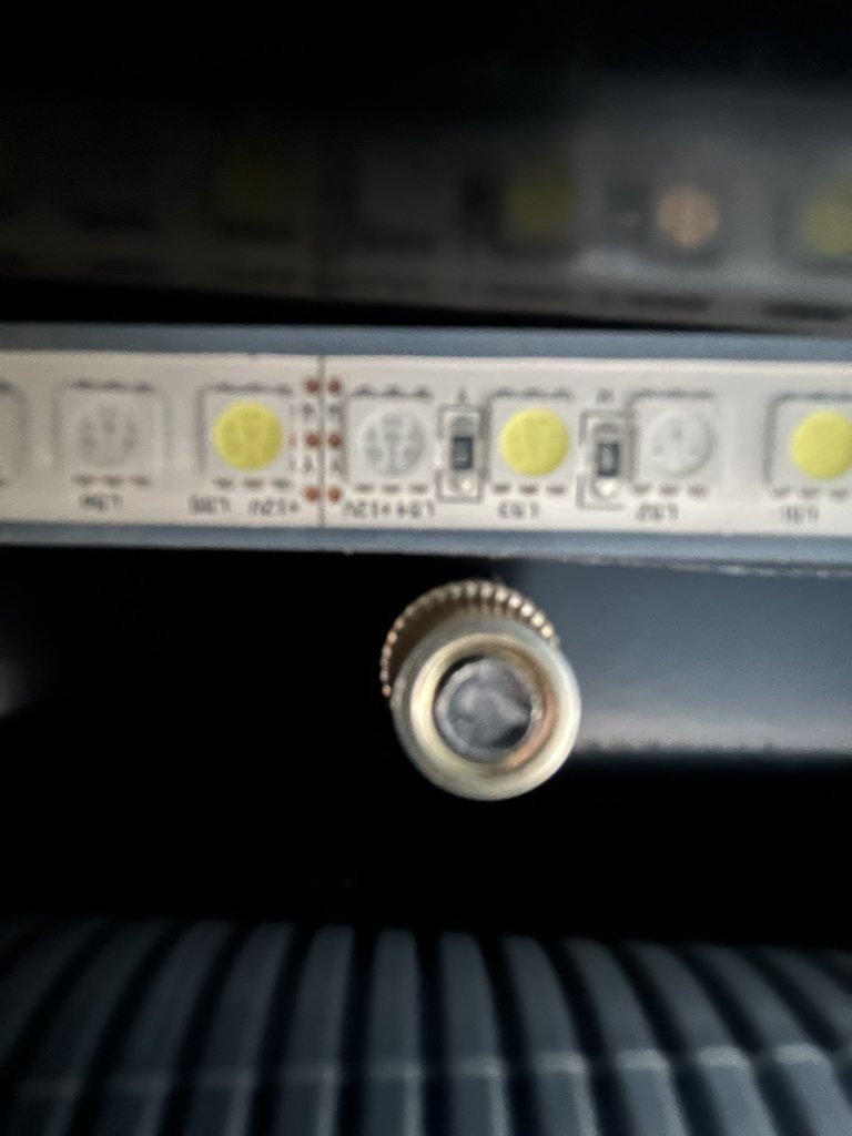

    I don't know if everyone has downplayed how annoying those rivets are or I just ignored them :D. They sucked to get out, especially through the gross member, but once those were out it was smooth sailing! I've tried with and without the cross member, and haven't noticed a huge difference, but I left it installed because I figured it's not a bad thing to have a little more support with all our extra weight. I haven't tried to tie it into the factory cross member yet either. Not sure I will bother since it seems super robust as is right now. So all in all, :thumbsup:. Thanks for the goods!
    essjay[QUOTED] likes this.

  11. Nov 22, 2024 at 10:56 AM
    #291
    rob1208
    rob1208 Well-Known Member
    Aug 29, 2014
    #137169
    2,029
    Rob
    SF Bay Area
    2014 Toyota Tacoma DCSB MGM TRD OR
    TRD Supercharger AFE CAI ProDryS ADS 2.5 Remote Resi Shocks ADS Rear Piggy Back 10" Travel Shocks ADS 2.0 Rear Hydro Bump Kit Deaver U402 Leaf Pack + Add a Leaf MCM Fab Uniball UCAs TC Spindle Gussets BAMF 100% Bolt On Sliders BAMF 1/4" Steel Skid Trilogy BAMF Diff Diaper Brute Force Fab Hybrid Front Bumper with Warn VR10000-s Winch Brute Force Fab High Clearance Dual Swingout Rear Bumper Custom Car Grills Mesh Grill Insert Stealth Custom Series SR8 - Matte Black 16x8 285/75/16 Toyo Tires Open Country AT2 Relentless Fabrication Ditch Light Bracket Mounts 2x2 Ditch Lights Apex Fab Works Flush Lower Grill Light Bar Mounts Caliraised 32" Light Bar Tech Deck Extreme Vagabond Outdoors Drifter
    This is something I've been wanting to do. I may have to copy the way you made the platform. Looks good!
    do you have a picture of this replacement? sounds simple enough but a picture helps me visualize what I need to buy. I was thinking of just using some nuts and bolts with fender washers but I do like using rivnuts instead.
  12. Nov 22, 2024 at 1:05 PM
    #292
    tacomarin
    Sep 15, 2017
    #230087
    1,945
    Steve
    Bay Area
    2018 DCLB TRD OR
    Now that it's done and I know it works, it wasn't that bad. But for a while there while I was in it I was like, WTF am I doing messing with something that's totally functional! :D
    I'll get some pictures soon... whenever it stops raining. What happened was that I originally tried using sheet metal screws to mount the strut brackets to the bottom of the panel and they just ripped out. So I drilled out the holes and put #10-32 rivnuts in with the flange on the bottom side. It was more solid, but I still didn't totally trust it so I drilled all the way through the panel, put some longer 10-32's all the way through, and put nuts on those so that they're at least engaging both sides of the panel. Hopefully some pictures will help make sense of that.
    Bottom line is mounting to one side of the panel is sketchy, mounting through the panel is pretty damn solid.
    ETA: With where the brackets end up relative to the frame that's mounted to the top of the panel, it's not really possible to use fender washers. It'll make sense with the pics

    Some more pictures of the bed platform details. Still need to finish up the carpeting, but very happy with this. We took it on our first camping trip over the Thanksgiving holiday and it is so nice being able to easily lift the bed out of the way!
    Here are the detail images of how I mounted the strut brackets for @rob1208
    Some more detail shots of the final brackets to support the platform. I'm going to pull these off and Raptorline them at some point.
    Precision placement of the rivnuts between the wireloom and LED strips, courtesy of @RangerComa

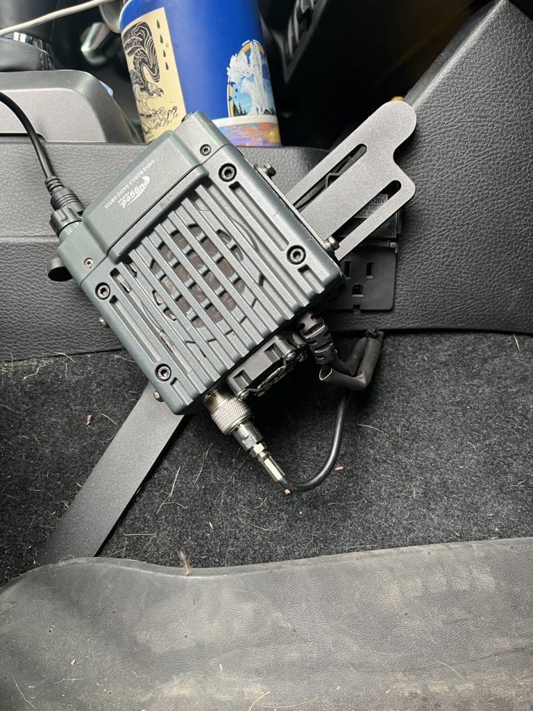

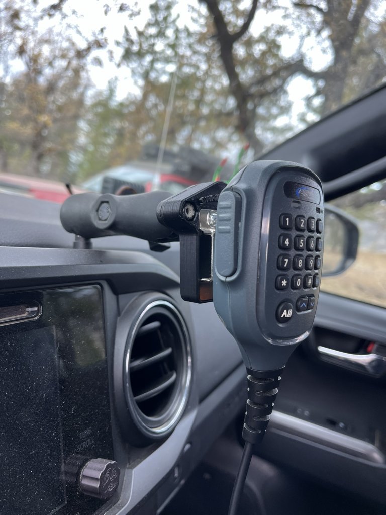

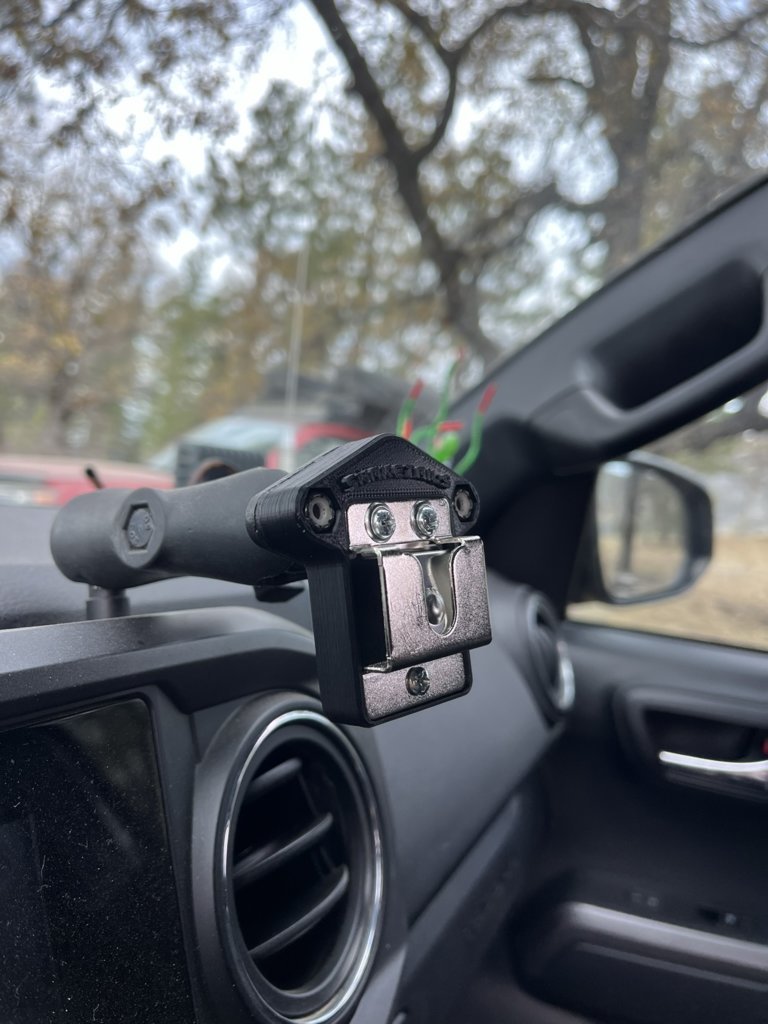

    I picked up this Rugged Radio GMRS unit a few months back from a friend. I had it velcro'd to the side of the transmission tunnel, but decided to make it a little more permanent with a proper mount. I picked up this one on their Black Friday sale which fits the bill. Bonus points, it works with the AC outlet I installed last year.
    I also 3D printed a mic mount adapter to work with an old Ram ball I had from a previous accessory mount.

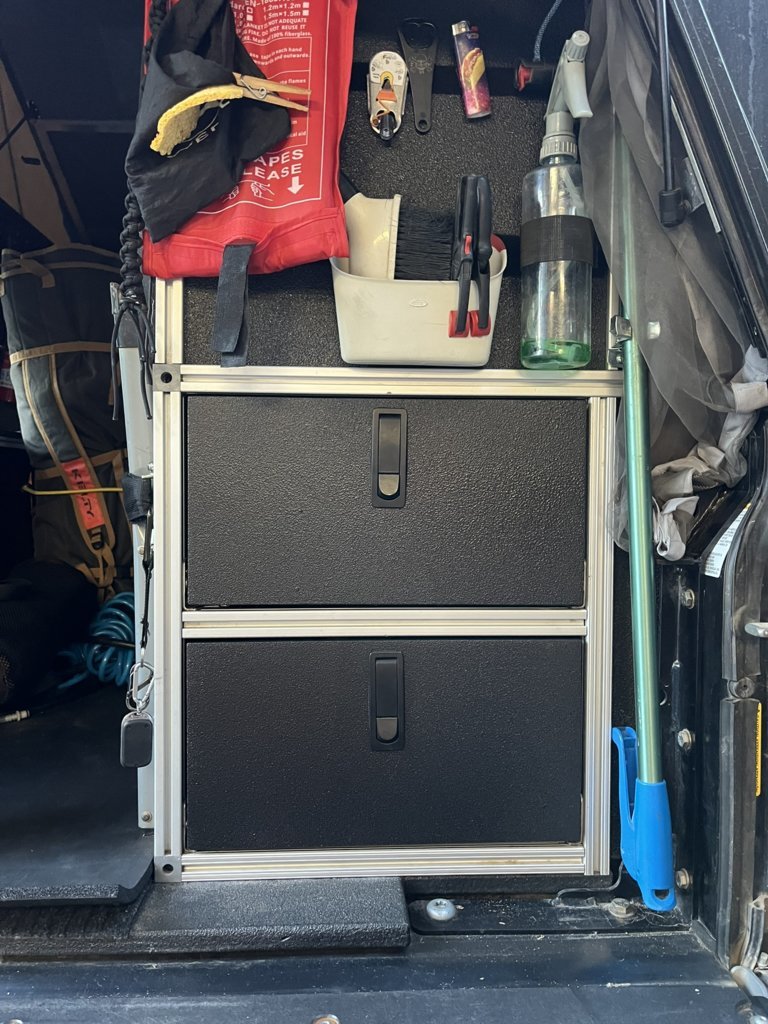

    Took advantage of some rainy weather and knocked out another project - Adding a water tank to the front of the bed. I had been dreading this project because of all the work it entailed, and it lived up to the expectation. First, everything had to be unloaded out of the bed. Then the cabinets had to be pulled out. I had to partially disassemble the cabinets and cut off 3" for the water tank. Then reassemble them (with loctite - lesson learned), and bolt them back in. Then figure out how to secure the tank, plumb it in with a 3 way valve to allow either the tank or jerry cans to be used. Then load everything back in and admire how it basically looks the same as when I started. Woof.
    So... why? Well in short, we got a huge dog. Before Rio, we could go for 5 days with 2 jerry cans of water. Add a 90 lb dog into the mix and all of a sudden we were blowing through water way faster. So yes, I could have just carried another Jerry can or two. But what's the fun in that?? Actually it just came down to trying to maximize space, and also be able to carry fuel. Now we will be able to carry up to 20 gallons of water, or 15 gallons and 5 gallons of fuel, without having to carry another Jerry in the bed. And for short trips, we will just fill up the bed tank and be able to keep all that water weight between the axles instead of hanging off the back.
    I decided to go with the Front Runner Outfitter's upright water tank, which I picked up on a Black Friday deal. It's a 40 liter tank (10 gallons), and I liked it because it's under 3" deep and spans almost the full width of the bed. I did consider the Tank'd spare tire replacement water cans, but the cost of them is pretty up there, and you still end up with the weight behind the axle. Plus it's under the truck, and more susceptible to puncture, damage, and freezing.
    I didn't take many pictures of the process, but the job is mostly done. All in all I think it took about 10 hours, and hopefully is the last time I'll have to pretty much completely disassemble the bed (until a flatbed conversion at least)!

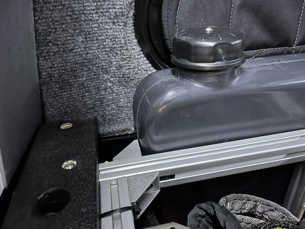

    Bed disassembled, water tank in place. Every time I unload our bed I'm absolutely amazed by how much we can carry!
    Cabinets modified and back installed
    The cabinets hold the tank fore and aft, and I added some side brackets to retain it laterally. A tie down strap secured to the bed floor secures it vertically.

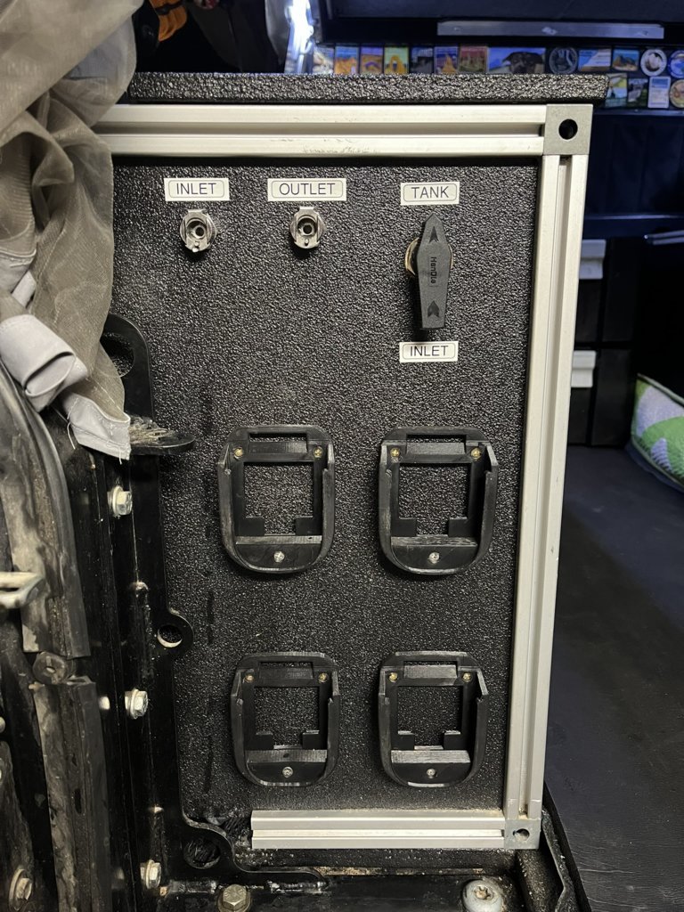

    And here's the selector valve mounted to the rear panel. This way we can use the tank or the inlet at the rear as a water source.
    Just need to finish modifying the cabinet tops, then it'll be wrapped up.

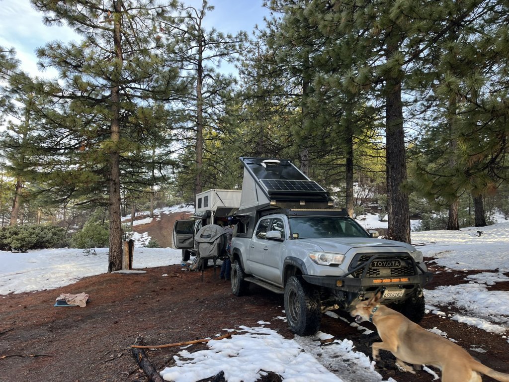

    Some small updates. We squeezed in one final trip in 2024 to Clear Creek (Laguna Mountain) for Christmas to get our 100th and 101st nights in the truck for the year. The new water setup worked great, minus a leaking connector due to a bad o-ring. Fortunately we discovered in on the morning after the first night, so only had about a gallon of water that had leaked under the bed platform! :rofl: Luckily (?) I carry spare o-rings for the connectors, so a quick swap on that and all is well.

    I also finally wrapped up a few loose ends in the camper.
    I finished the carpeting on the bed platform and raptor lined the platform supports, and FINALLY raptor lined the drawer faces (1.5 years later)
    With the water tank mounted at the head of the bed and having to shorten the cabinet lid, that gave me room to mount the fire extinguisher in a much more accessible location. So I removed the panel, and a couple rivnuts later, had a much better solution.
    Lastly, with the permanently mounted water tank I wanted to have an easier way to access water, both at camp and when traveling. Previously we would just syphon water out of the jerry can on the road, and also have just used a hose and sprayer at camp. I wanted something that was easy to access through the side hatch, could be used inside and outside of the camper, and could also be more of a sink faucet. So I teed in a quick connect on the top rail of the driver side cabinet, and am using that with a flexible coolant nozzle. It is easy to set up, and very modular since the coolant nozzle has a magnetic base. The only downside is the nozzle is not perfectly water tight so there are some more drips. But overall it's pretty handy.
    That's it for now

    Got to do a not so fun project. Ever since I did my gears the rear diff has seeped pretty consistently, and occasionally dripped. When we did the gears, we didn't read the gasket maker label very closely because it clearly gives directions on how to get a good seal, including allowing it to cure for 24 hours before putting back in service. I think we let it cure for 30 minutes before driving 3-4 hours north to go camp. So unfortunately the leak got worse, and it was clear I needed to address it. So out with the old, in with the old. Kind of a pain in the butt project without any real satisfaction at the end, but we got it done and seem to have a much better seal this time. Thankfully I had a few extra sets of hands to help me wrangle it in and out. I opted to follow a right up from TW on pulling it out without disconnecting the brake lines and just stretching them out. TBH, I think it was more of a hassle than to just disconnect the brakes and re-bleed. So hopefully I never have to do this project again, but in case I do here's my reminder to myself to just detach the brake lines.
    While the truck was up and the wheels were off, I decided to go ahead and get the shocks rebuilt. They have about 50,000 miles on them so they're maybe a bit overdue. Fortunately Rock n Road isn't too far away from us and these guys really seem to know there stuff. Unfortunately they found more damage than expected, so the rebuild is a bit more extensive than just a routine service. The good news is that since I got my coilovers, ADS has improved their top out limiter so they're going to upgrade them to that new configuration. Hopefully that damps the kind of violent top out I've always just dealt with. And if I still don't like it, maybe I'll finally put on some limit straps this time.
    And of course while I'm in there, I discovered my driver side upper ball joint is bad, and one of the sway end links was shot. So everything is getting a little love right now.
    The shocks should be done next week hopefully, but for now it's just sitting on jack stands in the carport.
    And I need to trim a bit more fender to clear my tires.

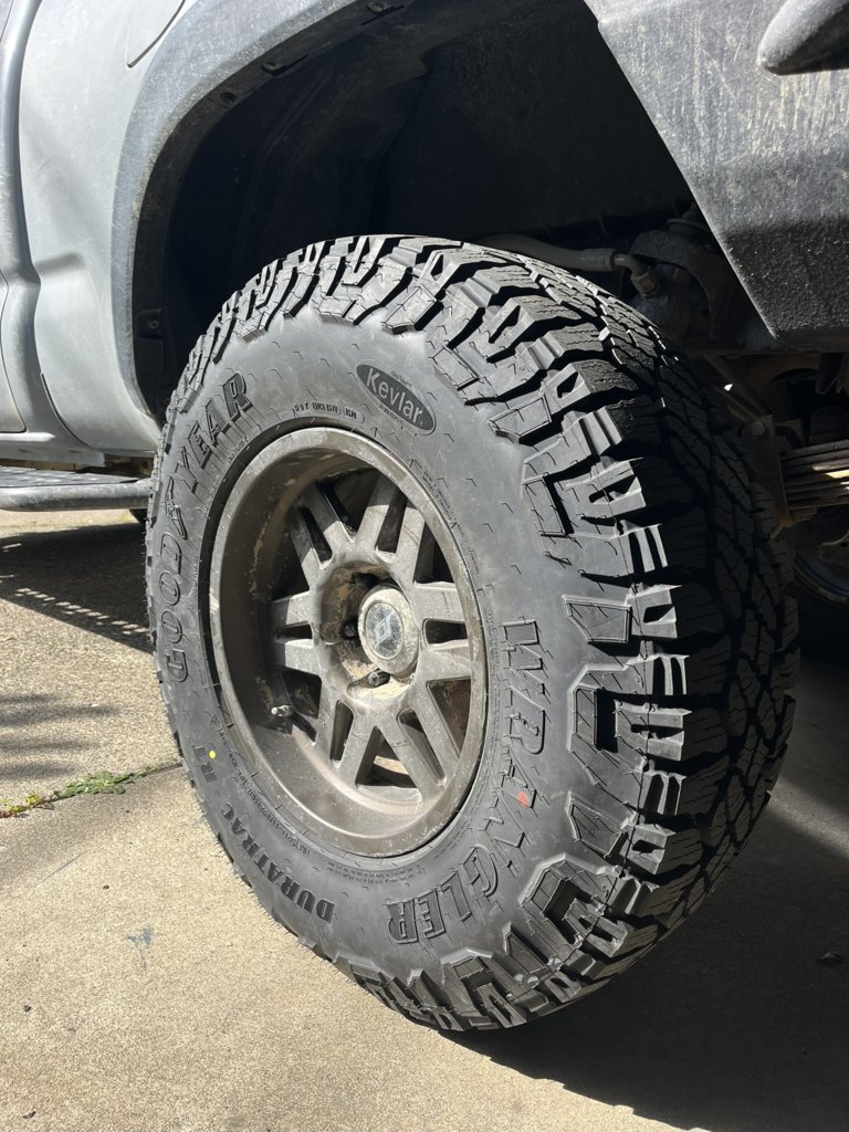

    Oh shit! I forgot to update this with my new tires!
    I opted to stay with the same size tire, 285/75r17 which I know is super uncool these days. 34" is so 2018. But I just like that size. It doesn't take a lot of work to fit them, you don't need to do any fender trimming or snorkels or anything like that, they suit the truck well, and I haven't had any need for a bigger tire. There's also a lot more options these days for that size, though all of them are way more expensive than they used to be (what isn't?). I decided to go a little bit of a different route this time and got the Goodyear Wrangler Duratrac R/T's. There's not a ton of reviews on this tire, but everything I did find on it was really positive. What drew me to it was: 1) It's a true 34" tire (34.1" vs 33.8 of the BFG's); 2) it's relatively light weight (63lbs vs 67lbs for Falkens); 3) It's 3 peak rated. I don't do a lot of snow driving, but enough that I want something that's pretty good. And everything I read about the Falken A/T4's is they are terrible in the snow. Plus they are an R/T tire, so they're more aggressive than all the others. In fact it's the only 3 peak R/T I found in that size.
    The downside is they're about $40-$50 more per tire than the Falkens, but that's not terrible in the big scheme of things, plus I wanted to try something a bit different from the rest.
    And I'm glad I did. I really like these tires so far. They look great, they drive really nicely, they are definitely quieter than my end of life BFG's, they've been fantastic in the snow, and done great with the mild off roading we've done so far. I'm definitely excited to see how these perform this summer!
