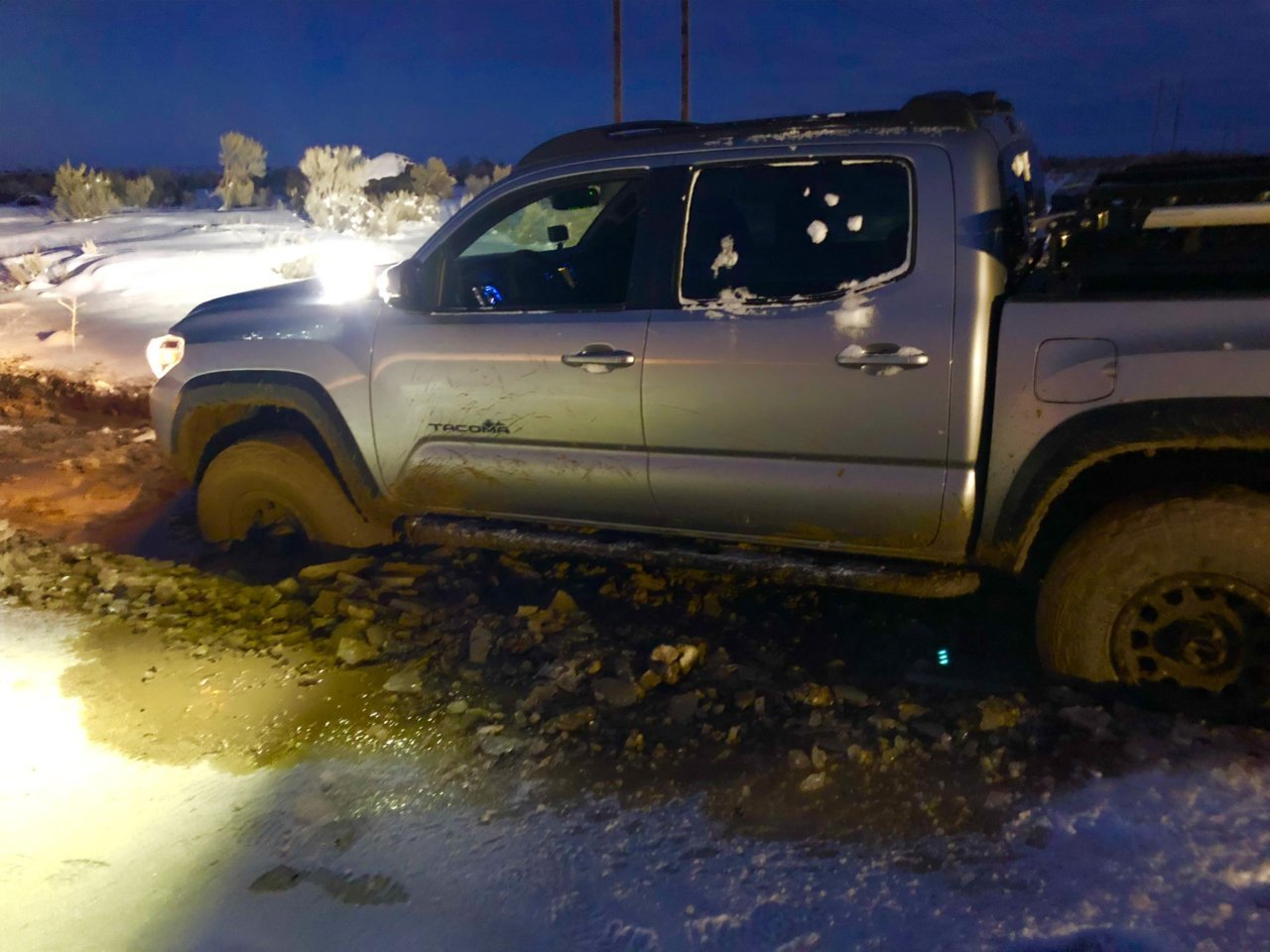

    Just a little word of advice. I have the same traction boards. The one time that I used them I was stuck in a giant puddle melt off of snow. So there was a layer of snow then ice, under the ice the ground wasn’t frozen so it was nasty mud. Broke through the ice layer and it was over. Pulled the traction boards out and stuffed them under the tires. Both of them disappeared when I backed out of mud the mud. Found one and if it wasn’t for my buddies perseverance I would of left the other behind. Tie a bright colored rope to them for easier retrieval

    Yeah I’ve heard of people losing them in sand and whatnot. I think the maxtrax come with leashes.
