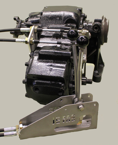

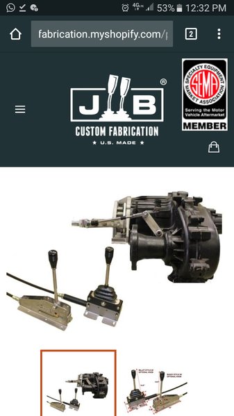

    https://jb-custom-fabrication.mysho...-shifter-single-np241-billet-style-p-n-np241c
    https://jb-custom-fabrication.mysho...-shifter-single-np241-billet-style-p-n-np241cScreenshot_20170216-123233.jpg
    Just have to figure out a plate an case to align cable and rode and avoid water into transfer case.
