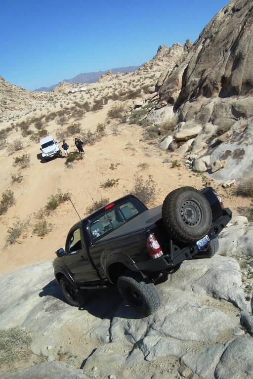

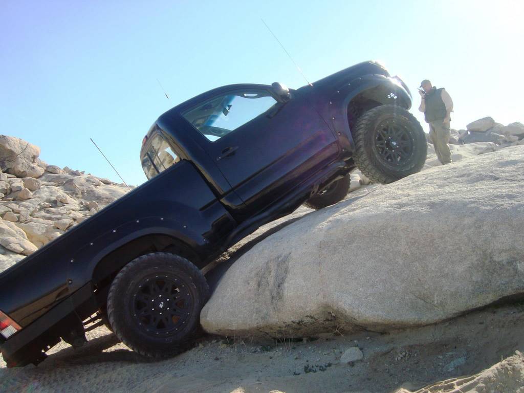

    Out in the sticks of Joshua Tree national monument:
    (OK "Fins" isn't isolated. sue me.)

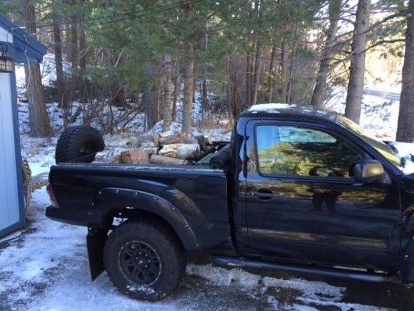

    A bed full of firewood rounds:

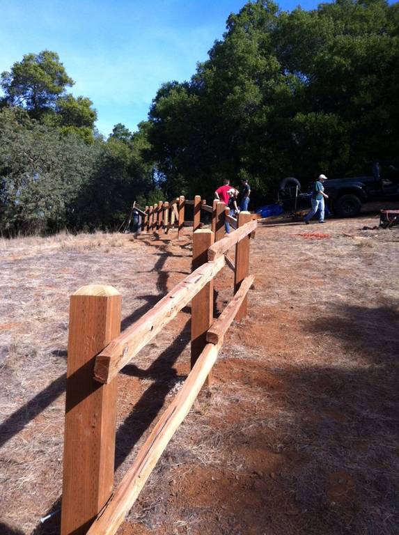

    You can barely see the truck - but everything to build my son's eagle scout project fence below rode in my truck over a county park 4x4 trail

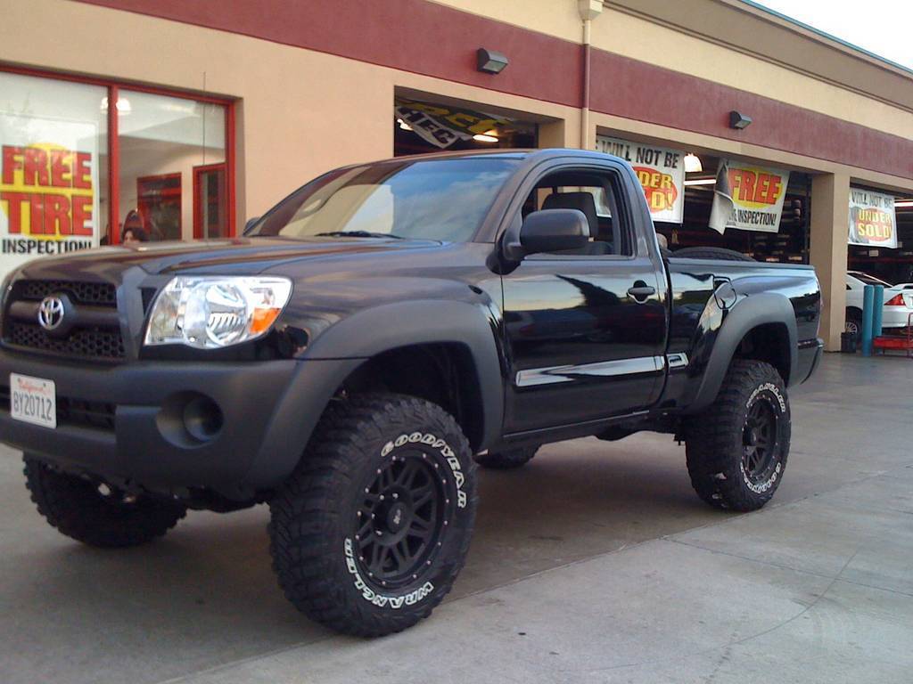

    Some folks would buy a daily driver and then buy a dedicated trail rig for "wheeling". But I'm not into "extreme" wheeling where damage is a given and I wanted a fairly new and bulletproof reliable rig for off-roading. I don't want to risk avoidable breakdowns. Nor do I want to use an extra parking space, pay extra insurance, etc... in order to have two vehicles.
    Pretty much as soon as I bought it and got underneath on a creeper, I realized that it had less ground clearance than the 1994 F150 it replaced. Yes, ON PAPER it has more. But the F150 measures under the front pumpkin, and can drive over a bigger rock than that anywhere on the front axle. The Tacoma measures that under the front splash pan, and that's ALL the clearance you get. :mad:
    So I pretty much decided right away to lift it, and put on oversized tires. I invested WAY to much thought in that decision. I decided to install OME, and wrote an install thread that was ultimately "stickied" in the suspension section:

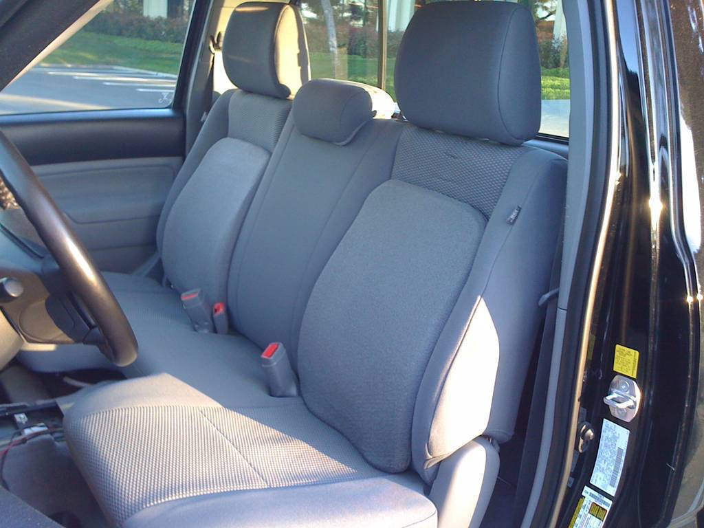

    Pretty quickly discovered the stock bench seat sucks:
    http://www.tacomaworld.com/forum/2n...sks-why-damn-bench-seat-so-uncomfortable.html
    and ripped the circulation-cutting steel rods out of the bench and installed permanent lumbar support

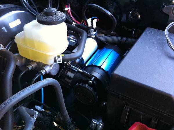

    Very first wheeling trip discovered that lifted tacomas don't articulate for shit and need a locker as a traction aid:
    http://www.tacomaworld.com/forum/2nd-gen-tacomas/128301-arb-air-compressor.html

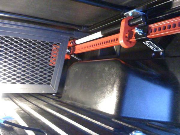

    ARB HO Compressor mounted to driver side fender:
    Truxedo Lo-Pro, Hi lift jack, gas cans...
    http://www.tacomaworld.com/forum/2nd-gen-tacomas/143973-bjmoose-mounts-nato-jerry-gas-cans.html
    http://www.tacomaworld.com/forum/2n...ed-factory-bed-divider-hi-lift-jack-pics.html

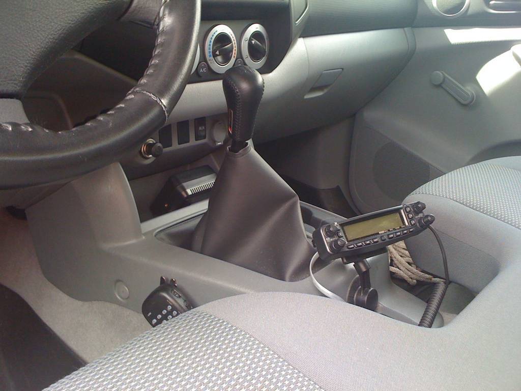

    Installed a HAM Radio and CB radio for communications. HAM is better, if you're wondering. But it won't help you if everyone you're travelling with with only has CB.
    http://www.tacomaworld.com/forum/au...ose-installs-ham-radio-nmo-antenna-mount.html
    http://www.tacomaworld.com/forum/2nd-gen-tacomas/150095-bjmoose-installs-cb-cobra-75-a.html
    In addition to showing the HAM radio, this pic also shows my "wheelskins" wheel cover and leather TRD shift knob minor mods consistent with the truck's "daily driver first" philosophy.

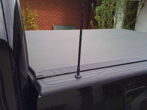

    I'm particularly proud of how clean the CB antenna mount came out:

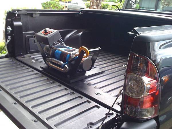

    Originally a receiver mount winch -
    http://www.tacomaworld.com/forum/2nd-gen-tacomas/144184-bjmoose-installs-receiver-winch.html

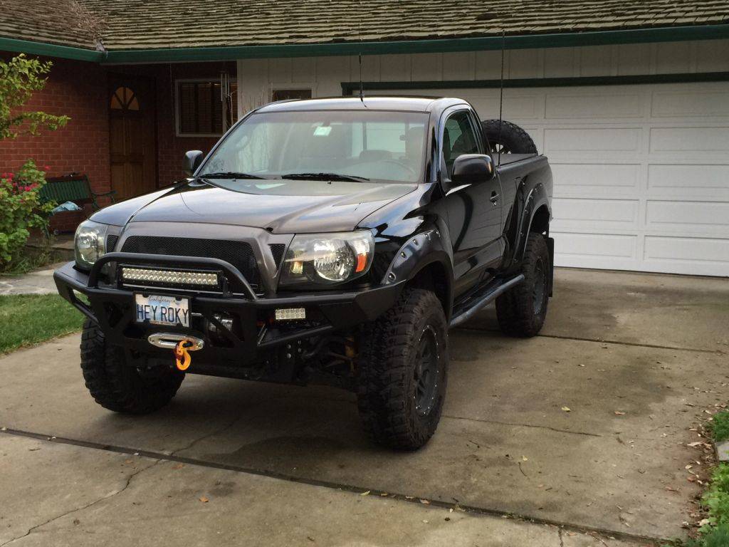

    Grillcraft grill with BAMF light mount and 7"HIDs behind the grill

    You'll notice I've done a hell of a lot with my truck while keeping stock front bumper. I liked the versatility of the receiver mount winch, but ultimately the inconvenience taxed on me. I got tired of pulling it out when I wanted to use it, and having to remove it from the bed when I wanted to use the entire bed for transport. So I decided on the new CBI "Dakar" front hybrid bumper.

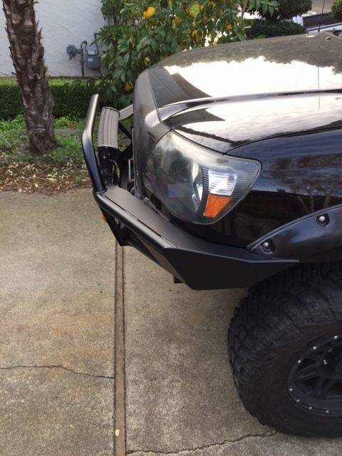

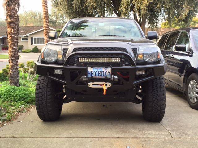

    Any frontal pics of the bumper? i find CBI's website pics kinda weird with the shaded and non shaded sections..
  17. Jan 4, 2015 at 8:27 PM
    #17
    bjmoose
    bjmoose [OP] Bullwinkle J. Moose
    Aug 31, 2010
    #42529
    6,009
    Steve
    San Jose CA
    '11 Std Cab 4x4 5sp
    OME suspension, ARB Air Lockers, CBI/Relentless/Pelfrey armor, HAM radio

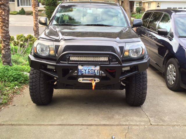

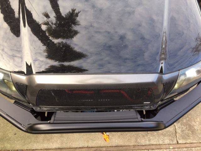

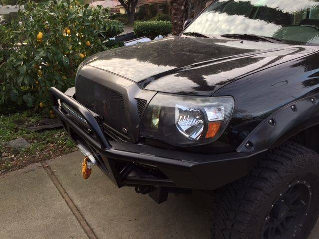

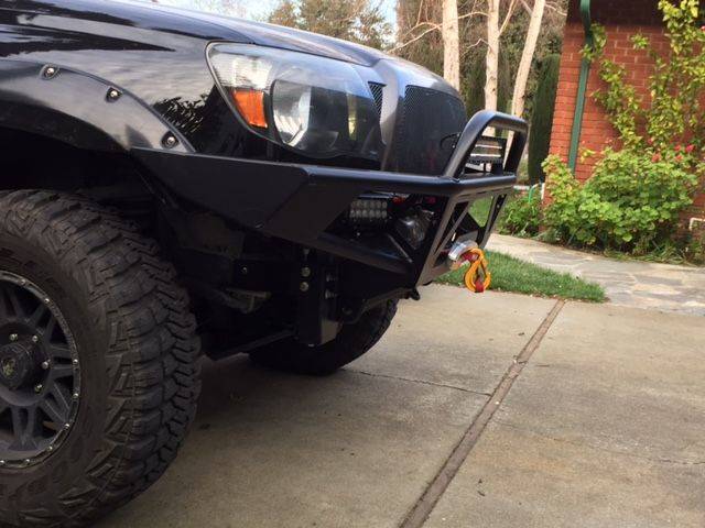

    Here you go. I finished installing the winch and the lights in the bumper today. It's a black bumper - so bumper and shaded holes ARE hard to contrast.
    Modding the old solenoid bracket so it holds the bolt that will hold it in position:
    In position:
    With "redneck engineering" rain/splash guard in place and cable shielding covering the unfused battery cable:
    All buttoned up, from various angles:
    These next two pics really show the gap between the bumper and the front grille
    All in all you can really see that it's optimized for approach angle and for allowing lots of access to the winch. It's not like some other bumpers that may look a little more "finished" but it's harder (or impossible) to reach in and flip the manual clutch lever or pry a stuck line off the spool...
    Also, it's a really modern/recent design - the design is set up with the expectation that you'll be mounting LED light bars on it, rather than "old school" round lights.
    It's a good visual match to a high clearance rear bumper.
