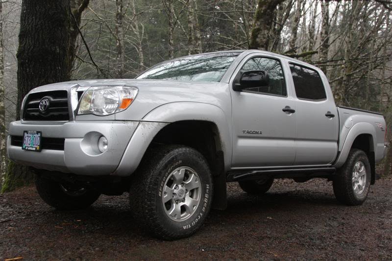

    I've been putting this off for a really long time!
    If you have any questions on how I did something, I'll try my best. Some of the mods I did quite some time ago, so I may not have a pic. There's some things I want to not tear into again, so some of the older stuff is going to be missing some photos.

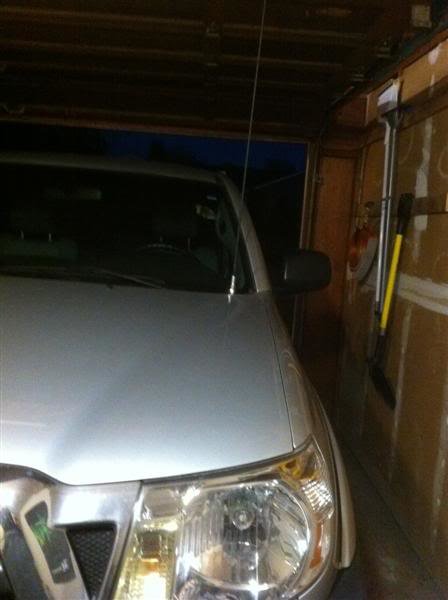

    Midland 75-822 CB with with Wilson 4 foot flex antenna Install (radio removed)

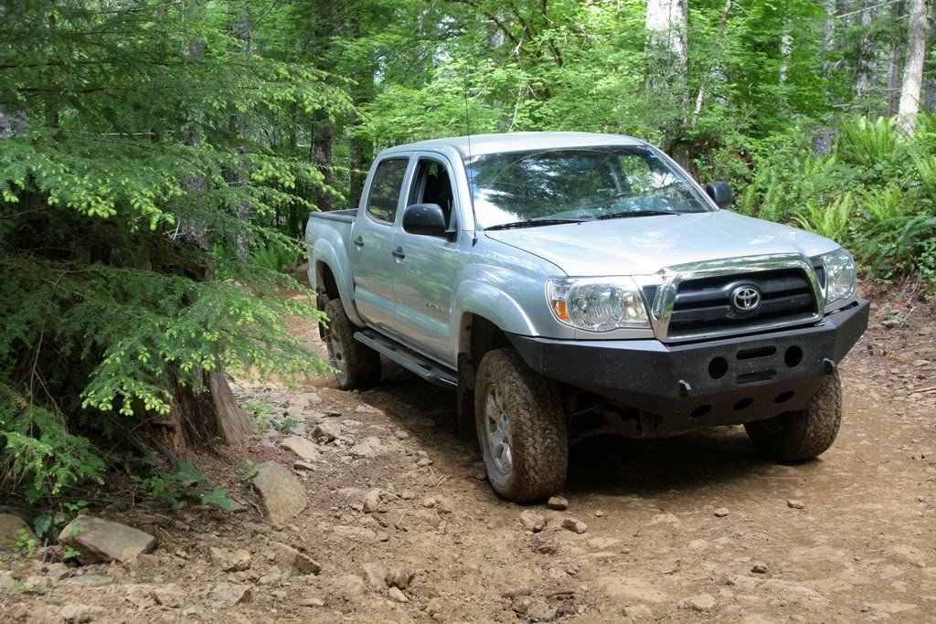

    Relentless Armored! Too many others to list.
    Its about time Mike!!

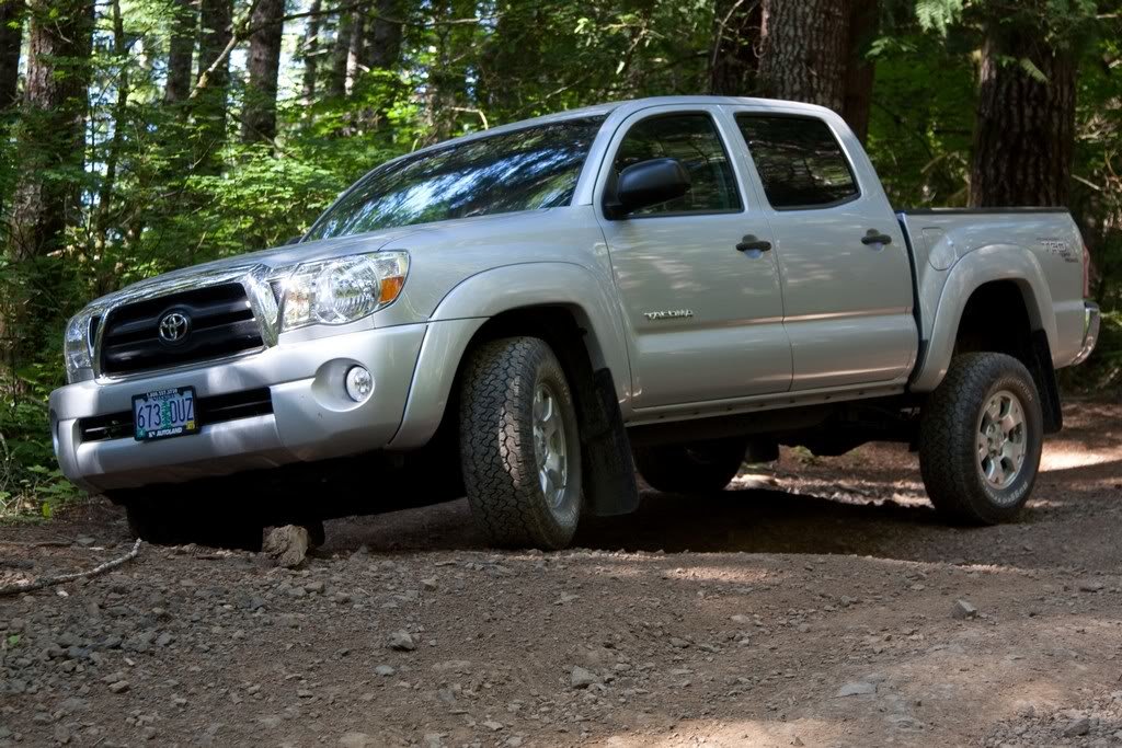

    I snapped this pic and kinda like it.... first day of wheelin with the new bumper:)

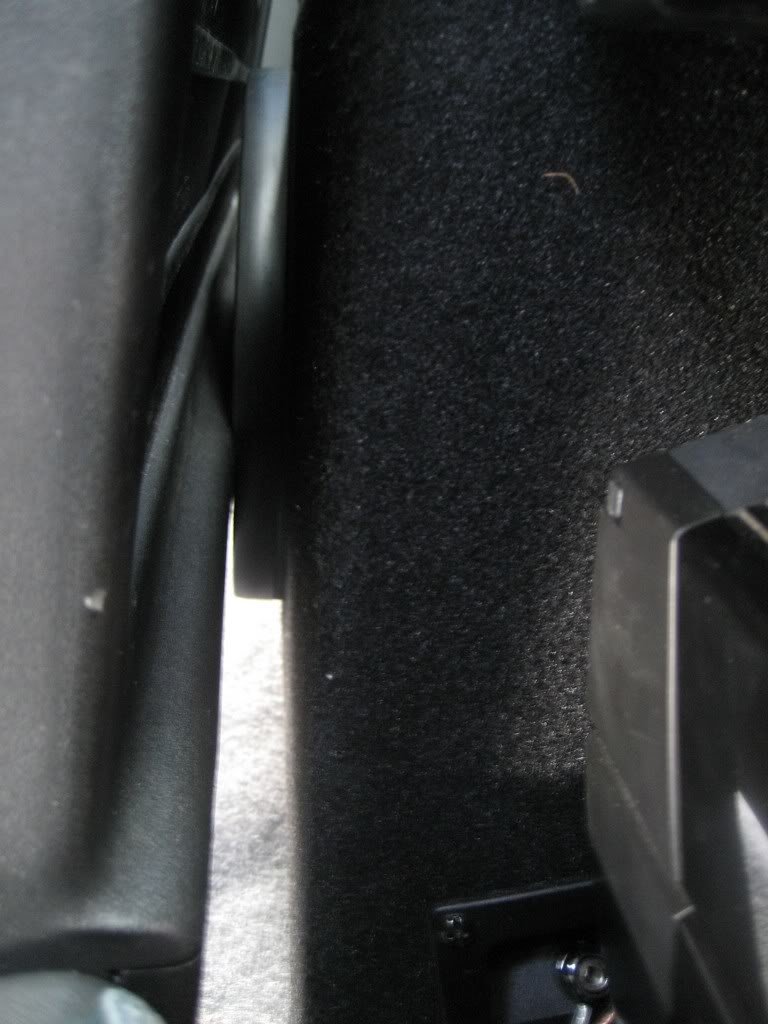

    Audio Install
    I used to have an '86 Accord from high school all the way through graduating college... and then some! I tried modifying stuff, but there's only so much you can do with a limited budget and the car I had. I had a carbed engine and didn't want to do an engine swap, so I dove into audio instead... and I haven't been able to listen to a stock radio since.
    After the head unit, I tried re-using most of my gear, which was a pain... but when you sink enough money into a decent set of gear, it's hard to start over.
    I had a Memphis Audio 12" in an oversize sealed box. There was no way that was fitting, so I knew I was going to have to get at least a truck box... but I've been through enough really trashy gear that I didn't want to settle. I was going to have to pony up on this one.
    I also had the following amps:
    Memphis 16-MCA3004 (75 watts x 4 chan. @ 4 ohms, 115 watts x 4 chan. @ 2 ohms)
    Memphis 16-MCD1000 (300 watts x 1 chan. @ 4 ohms, 600 watts x 1 chan. @ 2 ohms, 1100 watts x 1 chan. @ 1 ohm)
    These things are ridiculously big. The 4 channel measures 18.5" L x 7.6" W x 2.4" H, and the monoblock is not much smaller.

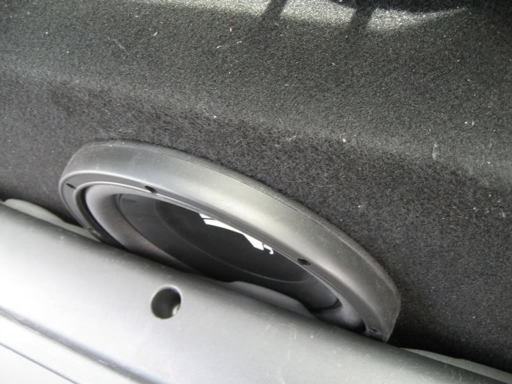

    I went with JL 10w3v2-D4 for the sub because it fit the enclosure I was having made, and more importantly, it was shallow enough to squeeze in.

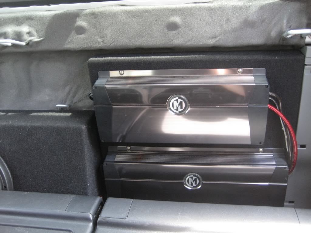

    This was going to take a ton of work trying to mash this behind the seats (thank god I opted for the doublecab).
    Through a LOT of help from Mr. Marv, I made it all work. I've probably cut some years off of his life with all the headaches I gave him.
    I meant to have a big writeup on this, but never got to it, so I'll try to give some commentary over the pics I have lying around.
    I don't have any pics of them, but I hopped on the group buy for the Hybrid Audio Clarus 6.5, and I put them in the front doors. I did a lot of research and talking with Marv, and decided that rear speakers were unnecessary. So far he's been right :)

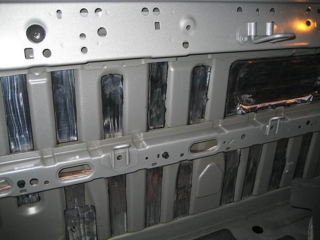

    I managed to talk myself into getting sound deadener, and was recommended RAAMmat. It's a pretty good product and I think it went on easier than the I've seen Dynamat done. Dynamat is also smelly and seems to get tar everywhere, even after having it on for years.
    I did the front doors and rear wall, also did ensolite, and I have leftovers. I will do the rear doors someday :rolleyes:
    Here's a shot of the RAAMmat going up on the rear wall. The box and amp rack Marv made for me fit so tightly that I couldn't simply stick on one big roll, I could only hit the crevasses. I put ensolite over the top

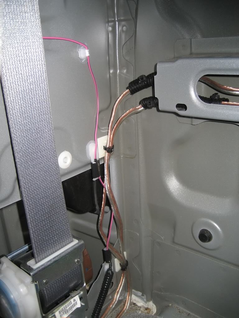

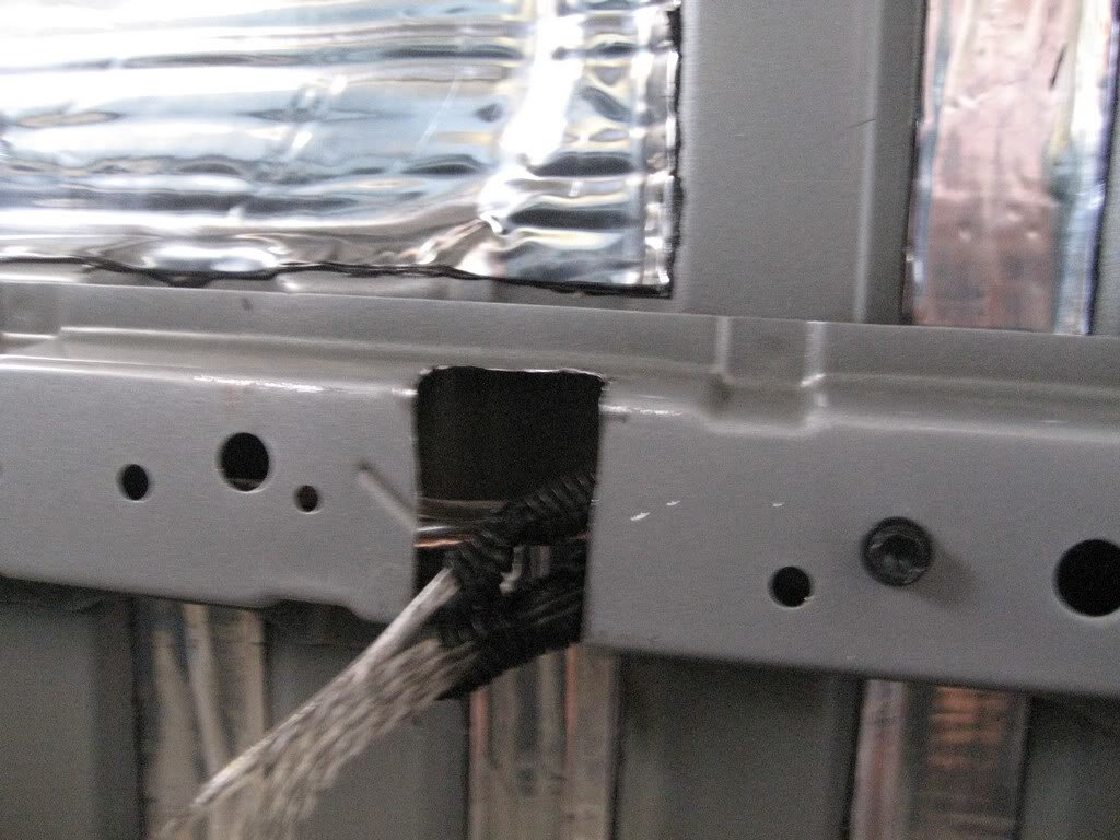

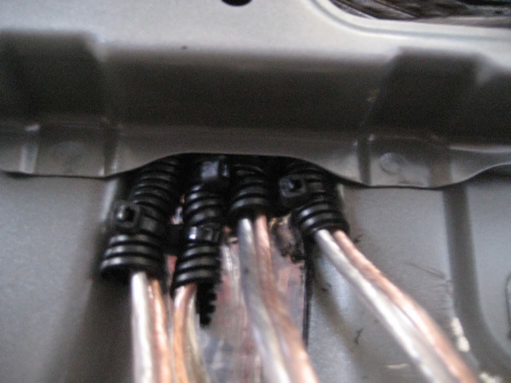

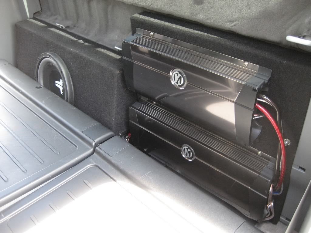

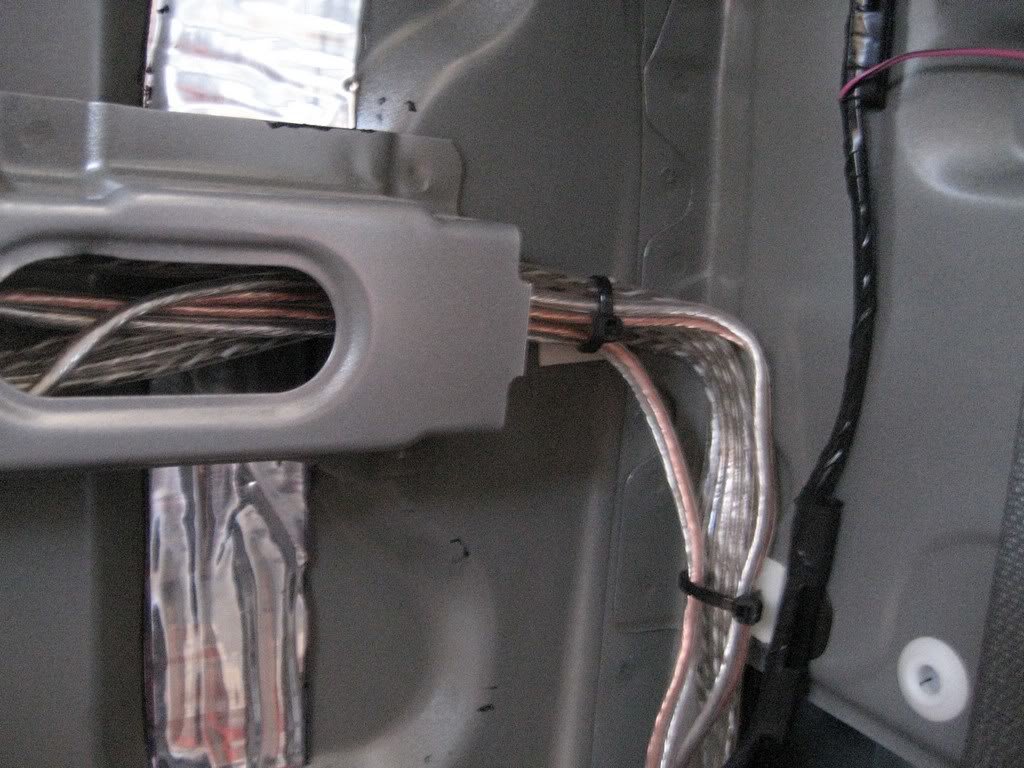

    Wiring was a pretty big undertaking. I ran new wire from the amps to the doors. Below is briefly how I did it, passenger side to driver side. Note that the driver side is where the amp rack is.
    I used the center 'brace' on the back wall as a track, and I cut out holes where it was necessary for stuff like power wires.
    I carpeted the box and amp rack. For a first time job I did OK, but if you look close you can probably tell that yeah... it's a first time job. :eek:

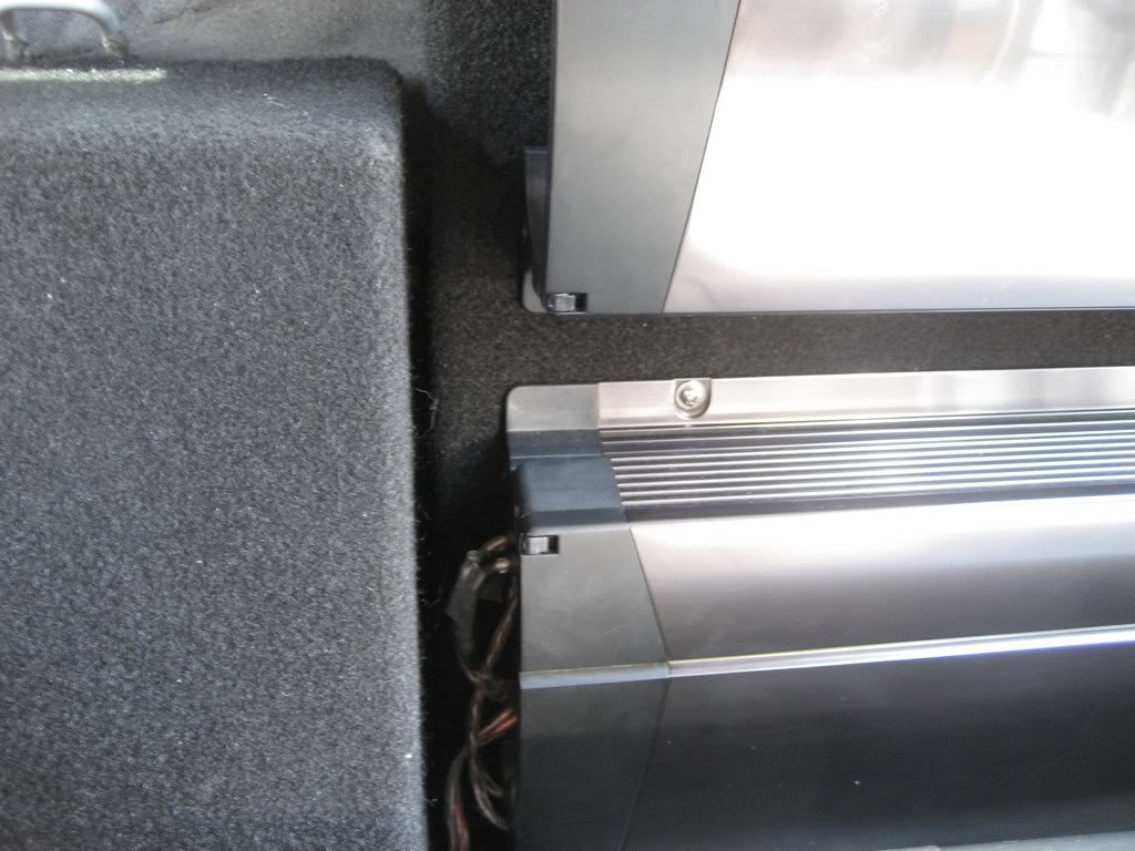

    You may notice that the sub box is a half-height. I had this plan that I could make a tool tray above the box so I could still have some behind-the-seat storage, but after getting things in I know there's simply no room!!
    Mr. Marv's dimensions are VERY exact. The boxes are practically poured into place.
    Things are so tight that I can't get a speaker grille on to save my life! I eventually removed the plastic off the back of the seat.
    The clarity and balance in my system is the best I've had, but as I had mentioned, I'm really lacking some of the 'jump' that a 4.0V deck could provide, so no real rap competitions just yet :rolleyes: I'll stick with Van Halen for now.

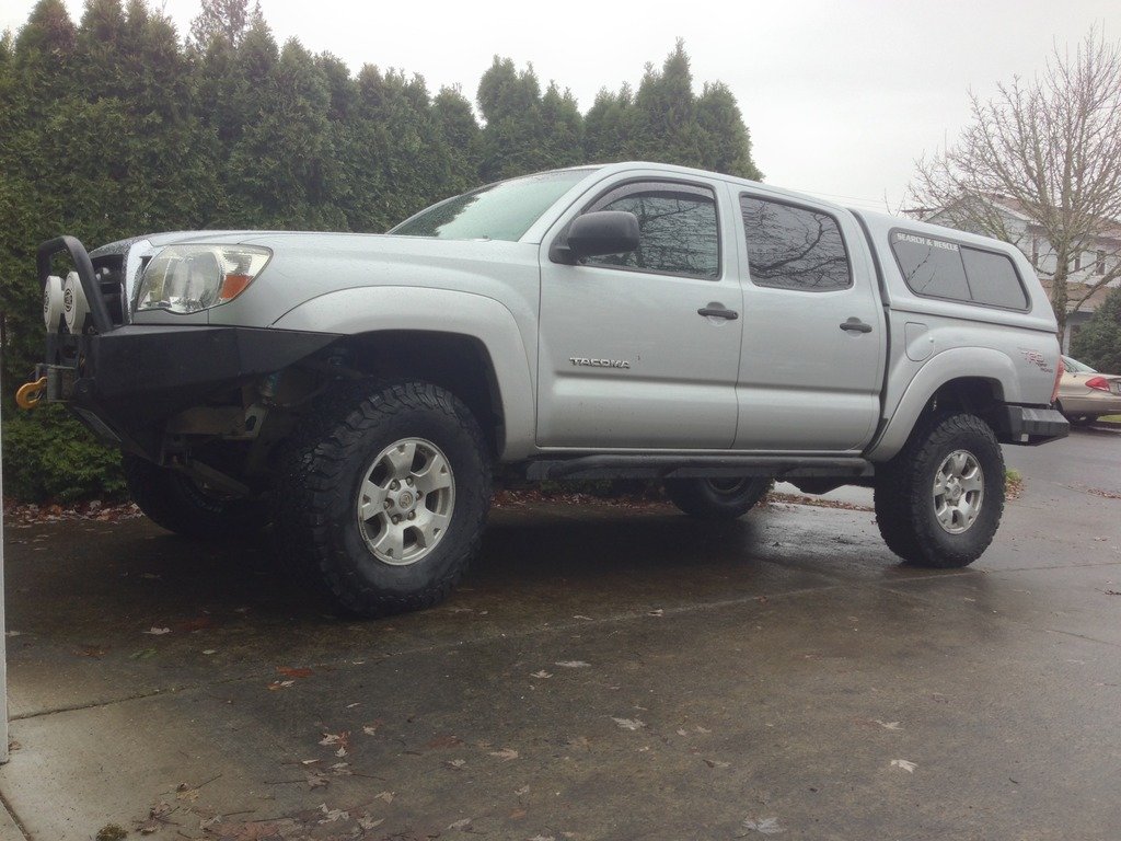

    A-TRUCK, Fat Kid in the Bed, Custom Pinstriping, Ported and Polished Muffler Bearing, Hi-Performance Bed Mat
    Just looking at the pic, and it may be the angle, but your front bumper appears to be mounted offset side to side...looks like a lot more gap on the driver side.

    Its level. The truck is flexed out a bit and the frame twists making it appear that way. :cool:

    Just because it would haunt me in the middle of the night, I went out to measure. I might be 1/32" off. I think I can live with that ;)

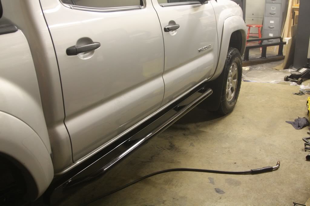

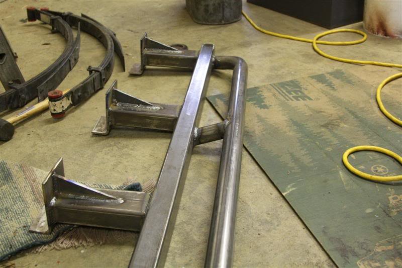

    All the normal TW BS

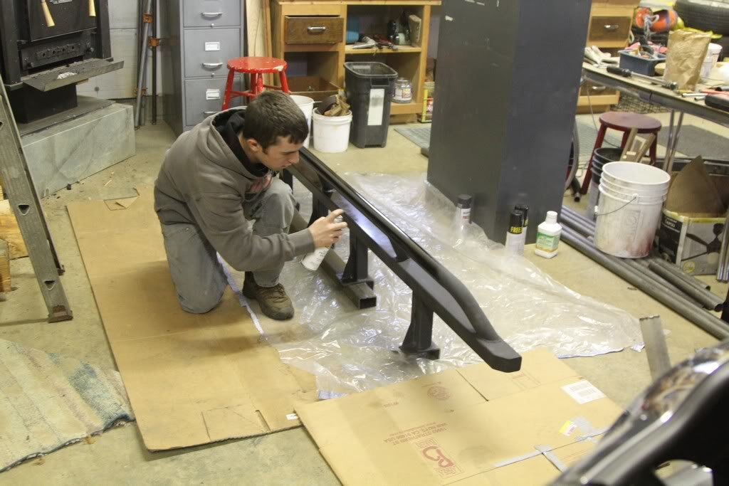

    Lift & Sliders

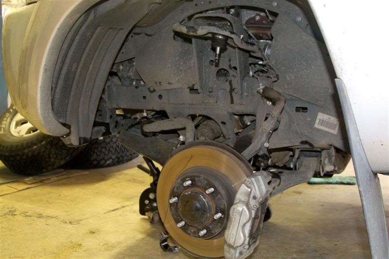

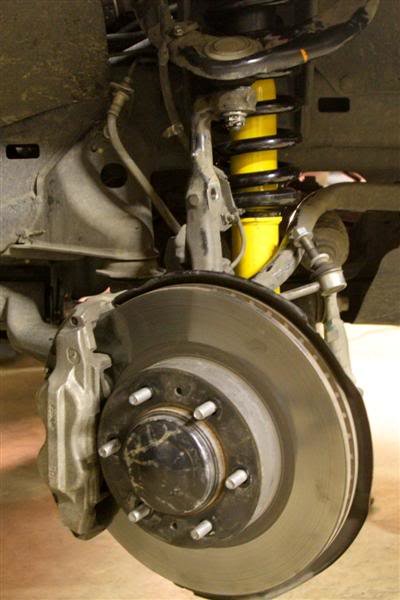

    In September '09 I joined an offroad club and went on my first official wheeling trip. I arrived at TSF with my bone stock rig and parked next to the rest of the group - about 4 FJ Cruisers that were built to the hilt: Budbuilt skids, Metaltech and ARB armor, racks full of recovery gear, and tires no smaller than a 285. What did I just get into?
    The guys did a fantastic job of putting up with me, teaching me, and protecting me through routes such as Cedar Tree and University Firepower. For the harder trails they were kind enough to tell me the alternate access route (which was fine by me!).
    I had some hairy moments with some stumps, and it was quickly apparent that I needed to mod something if I wanted to keep doing this and retain sanity.
    I must have changed my mind a zillion times. Revenge Fab, Metaltech, Demello, or something else for sliders? SAW, ICON, Toytec, or OME lifts?
    After enough research, I determined an OME kit from Wheeler's offroad was exactly what I needed: Affordable and can withstand more than I'll be throwing at it.
    Sliders were harder to figure out. I got to the point where I was emailing Metaltech and RelentlessTaco back and forth. Long story short, Metaltech had only built for FJC's and would need a significant amount of build time. About that same day I got an email from RelentlessTaco that he could meet me in Tillamook in 2 weeks to install sliders AND the lift, we'd be done in one day, AND we'd go wheeling the next day!!!
    I'm not sure if Timicha knew he was going to be helping, or if he knew that we were going to use his dad's shop :eek:, but I showed up on a Saturday and we got crackin'. I don't think any of us realized that we wouldn't be done until about midnight!
    We installed:
    OME N140S front shocks with 885 springs (UPDATE: I switched to 886 springs after installing the winch)
    Steel Spacers for the top of the front shocks (made by RelentlessTaco)
    OME N182 rear shocks
    extra Wheeler's ACH22 1.5" leaf in the rear (I already had the rear TSB spring in)
    the sliders
    We worked pretty quick, but most of the time was spent waiting for paint to dry
    Test fitting
    Welds complete
    Painting. I accidentally picked a really glossy black, but it actually came out really nice... up until I hit the trails. Now you can't really tell so much since the trail dust, etc. has faded them :) They look great either way.
    Mounted
    Nekkid wheel wells. It wasn't until we got this far along that I thought about taking pics.
    Just about done!
    Beauty shot at the staging area. I'm still on stock tires in this pic - I had tread left and felt that I should try to let the bank recover a bit.
    On the trail. I don't have better pics because it started raining like mad. It's too bad, because we found an area where I put the sliders to use to pivot on a rock. As I told Eric, it's really great when a product pays for itself in under 24 hours :woot:
    If I had the chance, I'd make the exact same choices again. the OME lift is treating me well so far, and nothing compares to these sliders.

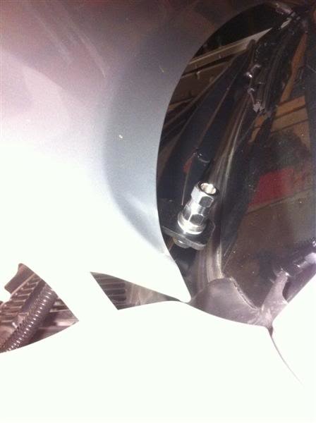

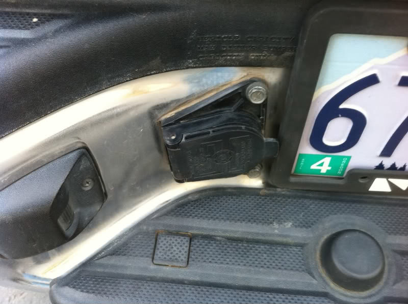

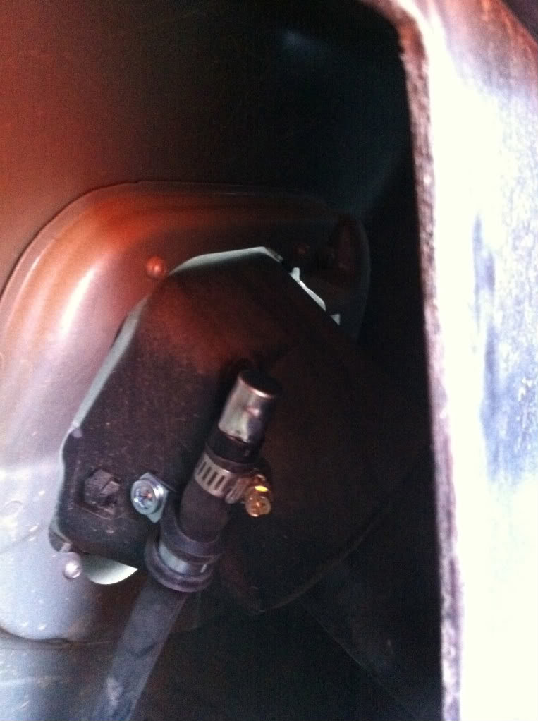

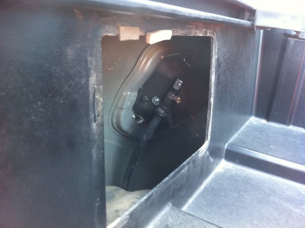

    Trailer Plug Relocation

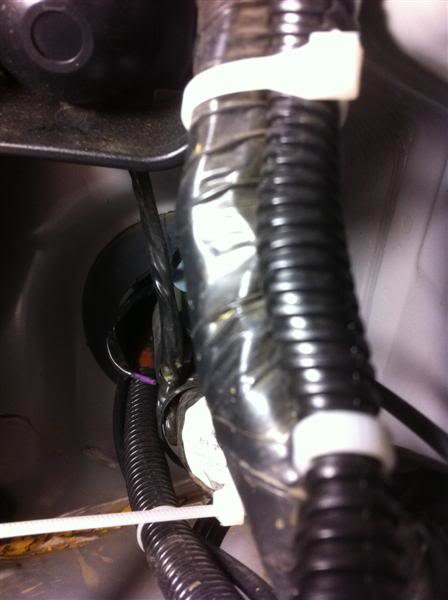

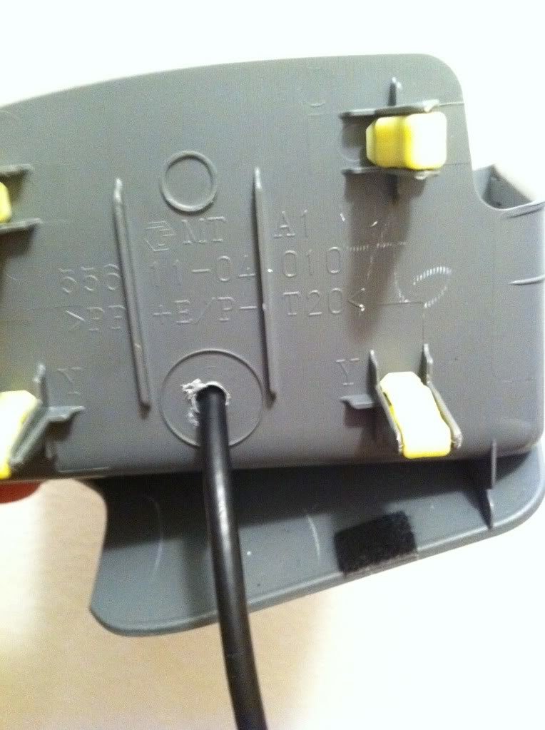

    I saw this mod and thought I should do it sooner than later. I didn't want to remove the light, so I drilled my own hole (that's what she said). I found that it sat more flush if I installed it at an angle, so I went with that and used Permatex black RTV silicone to make a seal. In the pic, the silicone is a bit brown from dust.

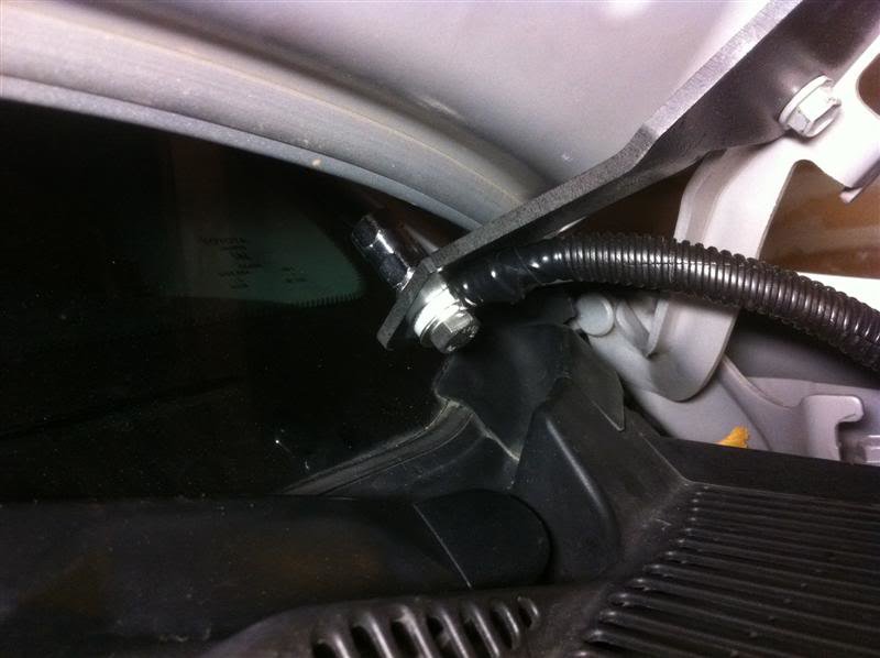

    The first time I saw this, I knew that I must have one. It was so incredibly in-your-face and intimidating that it blew my mind every time RelentlessTaco posted a pic.
    I managed to snag the perfect moment. Eric had finished fabbing up his second prototype bumper in readiness for the Group Buy currently going on, and was selling it to the first person who had $550 - already painted, with an offer of help on mounting.
    I made it mine in less than 2 hours from his post. I think there was 5 minutes when I thought "I should check my bank account", but I think I already was pressing 'send'. :cool:
    If you look at the thread here, you can see us working on the install.
    Eric calls it a 'prototype', but I have no idea how you could tell. I know it sounds like I'm gushing, but the guy really is a master at what he does. This model is significantly improved, as you can see in the overall finish and how the bumper has been redesigned for a better approach angle. It's probably lighter, too.

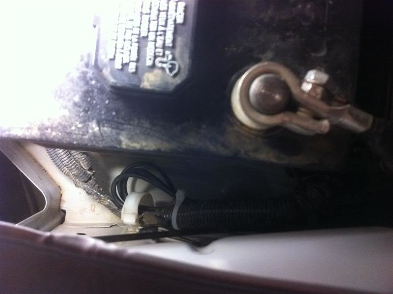

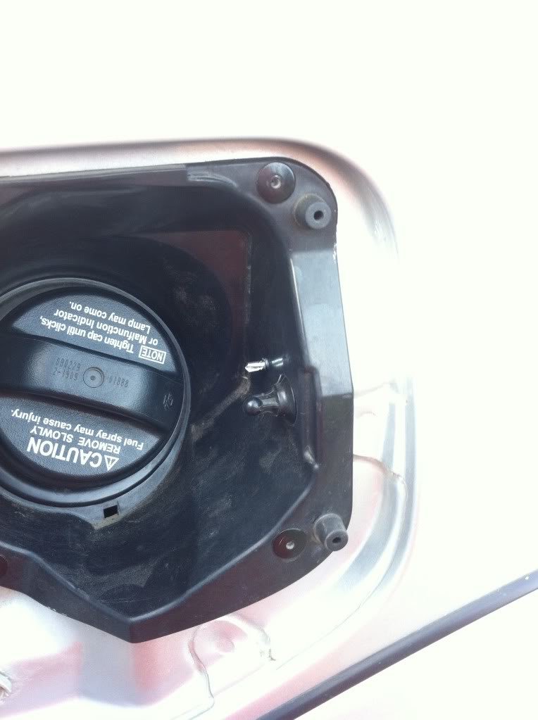

    Rear Differential Breather Relocation
    I've been meaning to do this for awhile, just because it's a good idea. I found time yesterday and got to work.
    I got the idea and instructions here.
    If you read through the posts, one guy had an alternate place to mount the breather, and I thought it was a great idea.
    In this pic, I'm sitting in the bed looking at the driver side cubby. through the hole you see the back end of the fuel filler. I liked this location because it keeps the breather away from accidental smacks, fuel contamination, and overzealous sprays with the garden hose.
    Here's a bit closer pic. The metal hook can be found at Home Depot in the electrical aisle. I didn't really need a rubber insulated one, but that's all they had. I used a self tapping screw to secure it.
    Here's what you see when you go to fill up... or what the gas attendant sees because you live in a state where they think a guy with a bachelor's degree is too stupid to pump his own gas :mad:
    Anyway, I like how it leaves a nice clean look.

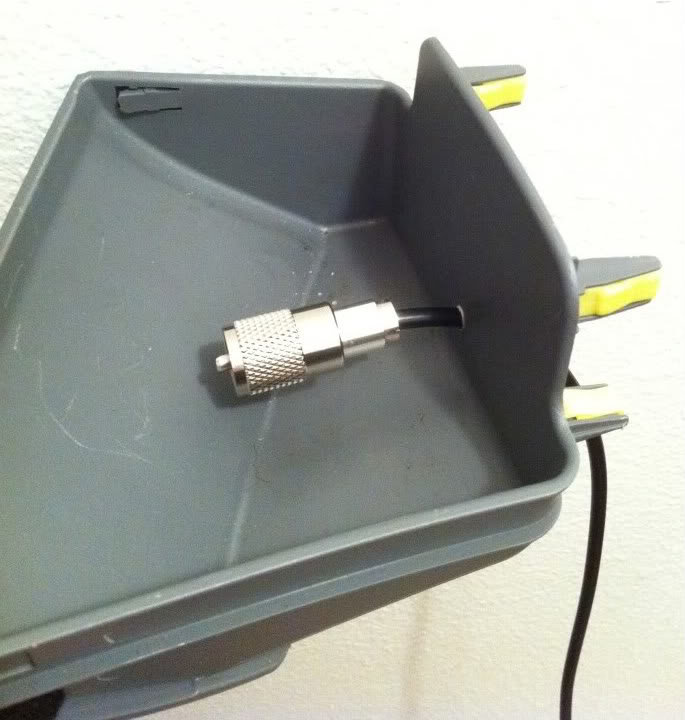

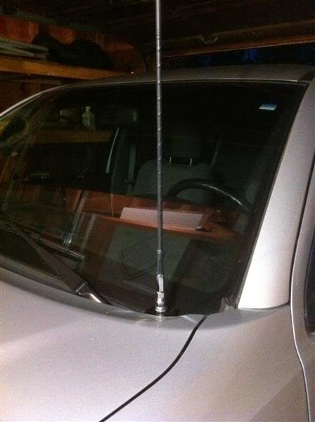

    CB Install
    I thought I was going to be all smart and save myself having to do a mod on this one. No such luck :p
    I got a Midland 75-822 for Christmas last year. the great part about it is that you can use it either as a handheld or quickly plug it in your vehicle via the cig lighter and a standard CB antenna.
    I thought I could get away with using the handheld antenna and not have to install anything. Yeah... that doesn't work. I get dead silence on the freeway, and on the trail I've got an effective range of about 5 feet. :boink:
    Since this is yet another adventure down the road called, "Stuff I know nothing about", I went down to D&R Communications in Clackamas.
    The guy there really knows his business, and gave me all the gear to get an antenna installed. Once I'm done, I can go back and get tuned for free. Sounds good.
    First up, I need a place to mount my in-cab connection. I had to make sure that when I pulled on the radio, I wasn't pulling the cable out. I chose the right side coin pouch because the cord gets tension from the cig lighter plug before the coax. If you have this radio, you'll see what I'm talking about. If you don't, then you probably aren't doing anything like this.
    I used a 7/16" bit if I remember right. Ignore the dirt, I haven't cleaned it up yet.
    Toyota was nice enough to give me a target
    I sent the rest of the cable through the factory hole near the steering column, just above the driver wheel well.

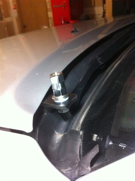

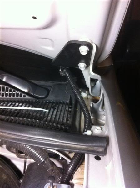

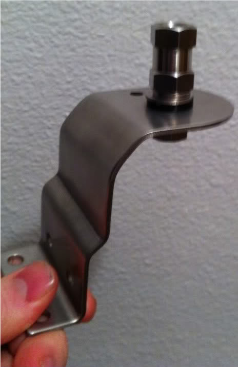

    I originally wanted to go with a custom mount off the rear corner of the tailgate area, but learned that is a big no-no: It turns your antenna into a directional antenna and you get totally crap signal from anything in front of you.
    As a a result, I went with a hood mount. However, the one I bought is designed for a T100, and is completely incompatible with the 2nd gen Tacomas without serious modification :mad:
    I was completely out of options, so I turned to TW for help. I found a guy who had a interesting design... wasn't what I really wanted at first, but I was desperate. It involved a piece of plate metal mounted to the hood screws and bent so the antenna stud sat near the base of the driver's wiper. Since I was already headed down to RelentlessTaco's place for other work, I thought I'd work with him on this, too. For a prototype, I think we came out with a success!
    I unfortunately don't have a pic of the piece off of the truck because I was in a rush to get it mounted, but you can see well enough in the pictures to follow. It's a piece of scrap steel that Eric had cut and CNC bent, and I hit it with a layer of primer and two layers of gloss black. I used a heat gun to speed up drying. Note that I scraped some paint off near the antenna stud and one of the bolt holes for grounding, and scraped some paint off the bolt hole on the hood.
    First, I took care of my cable management. With CB wire, you can't cut it to length, and you can't spool it up (UPDATE: I was wrong, read here. Correct length is whatever gets to the stud and back to your radio, no need for this 18' increments BS). You should run it the length of the engine bay back and forth. I routed my cable so that it would go to this area near the battery, back to the firewall, and back again. I ziptied the bundle against the factory wires.
    Next, I attached the custom bracket, wrapped a bit of the cable in plastic shroud with zipties, and attached the cable to the antenna stud. To help protect the wire, I routed under the rubber strip before attaching to the stud. Notice that the mount attaches to the hood's factory bolts. DO NOT TAKE BOTH OUT AT THE SAME TIME. Take out one bolt, attach bracket with that bolt, take out other bolt, swing bracket into place and tighten up both bolts.
    When I put the hood down, I noticed the wire gets squeezed between the mount and the plastic sill. It's not a big deal, as the sill flexes a bit, the wire is protected, and the bracket isn't going to budge. It's hard to tell in the pic, but the bracket isn't touching the hood, there's clearance between the two pieces.
    Antenna mounted finally!!! It's a Wilson 4' Flex with a tunable tip.
    Yes, the antenna is canted a bit forward and passenger, but remember it's a prototype and there's some really odd, tight angles to watch for. I think Eric did an OK job - install was cake, part is sturdy, and it worked great on the trail last week. You do notice the antenna being there, but it isn't enough to get in the way of driving.
    Out on the trails, the setup did great. Driving the highway, I can get plenty of chatter. I will say the Midland is hard to use in the dark. It has a momentary light for the LCD screen, but it would be nice to have something always lit and bigger. There's also too many buttons... not that you need to use them, but if I had to do it over I would try getting something like a Cobra 19 DX IV or a 25 LTD and see about mounting it under the stereo...
