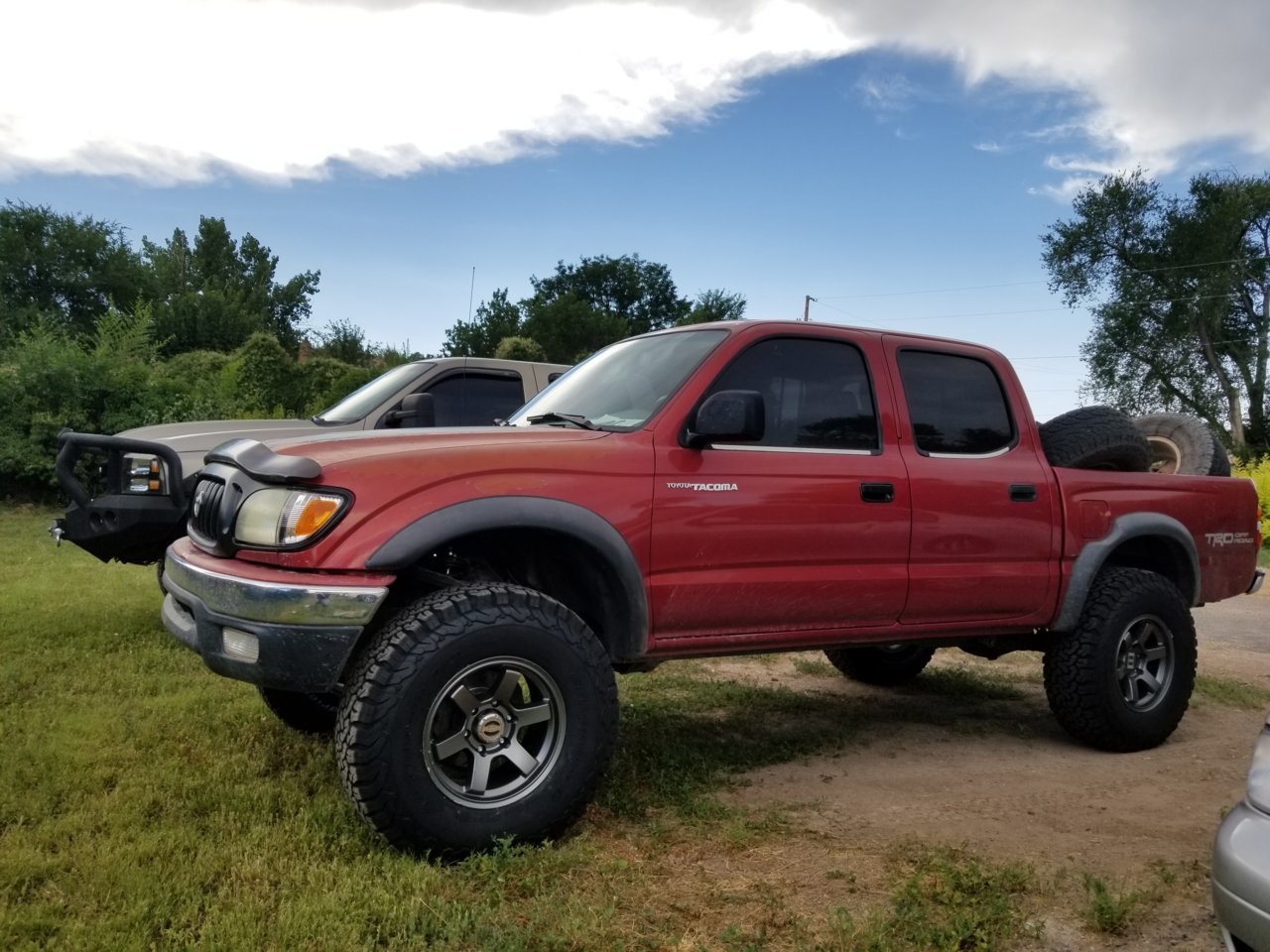

    So, I'm getting ready to do a 4x4 conversion on my 2002 Prerunner Doublecab 6 cyl Auto. Most everyone who has done this, knows this begins with a months long process of gathering parts and asking annoying questions of anyone who has done it before. I figured I would start a thread where I can try to gather the info for my swap. I realize others have made there own threads, and I plan on linking them here to this one to try and centralize the info for myself.
    Any input in this is greatly appreciated... and also another reason I'm starting this thread.

    Also... Updated pic of the rig

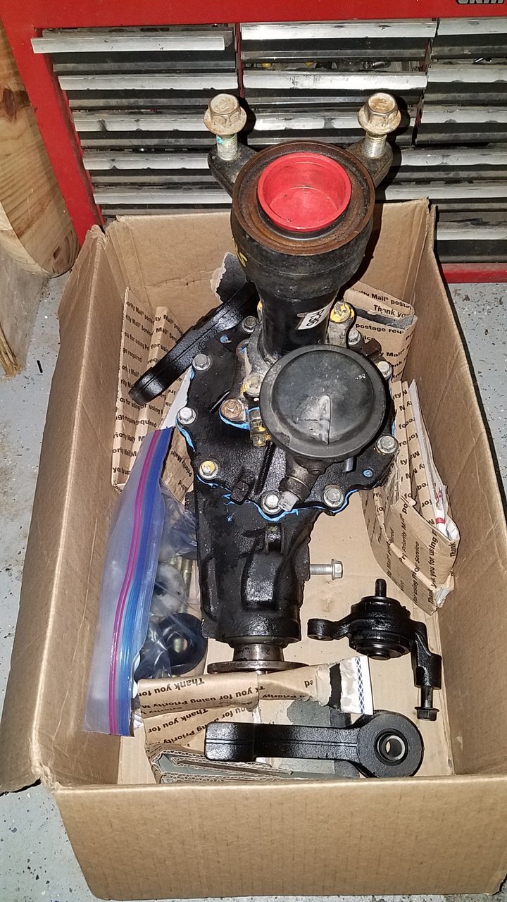

    So I started off the accumulation of parts by picking up a front differential from @BartMaster1234... a yard had sold it to him, telling him it was 4:30, when he opened it up, it wound up being 4:10. Was happy to take it off his hands because that's the ratio I happen to have.
    This particular diff was ADD, so I started looking for a manual jackshaft. I didn't want to mess with the connections involved with going ADD. And I didn't want to do the whole hose clamp in the differential thing either.
    Eventually, I found the manual jackshaft and someone willing to part with it. (found on Craigslist)

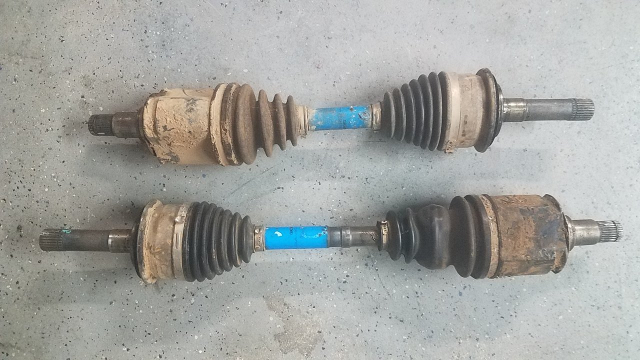

    Aaaand I was also able to get a set of OEM CVs from @Tour991 as well.
    (Side note) @Tour991 deals quite a bit in parting out trucks. I want to tell you, he is a solid dude. If you see he's selling something you need, don't even hesitate to deal with him... he is 100% legit.
    I will be cleaning these up and rebooting them with long travel outers from Lowrange and high articulation inners from Offroadsolutions... when time allows.
    TrentonTDG and Tour991 like this.
