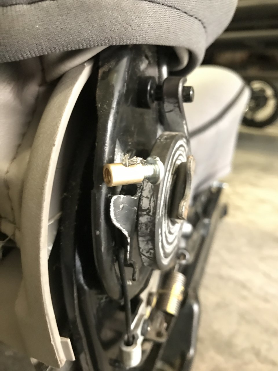

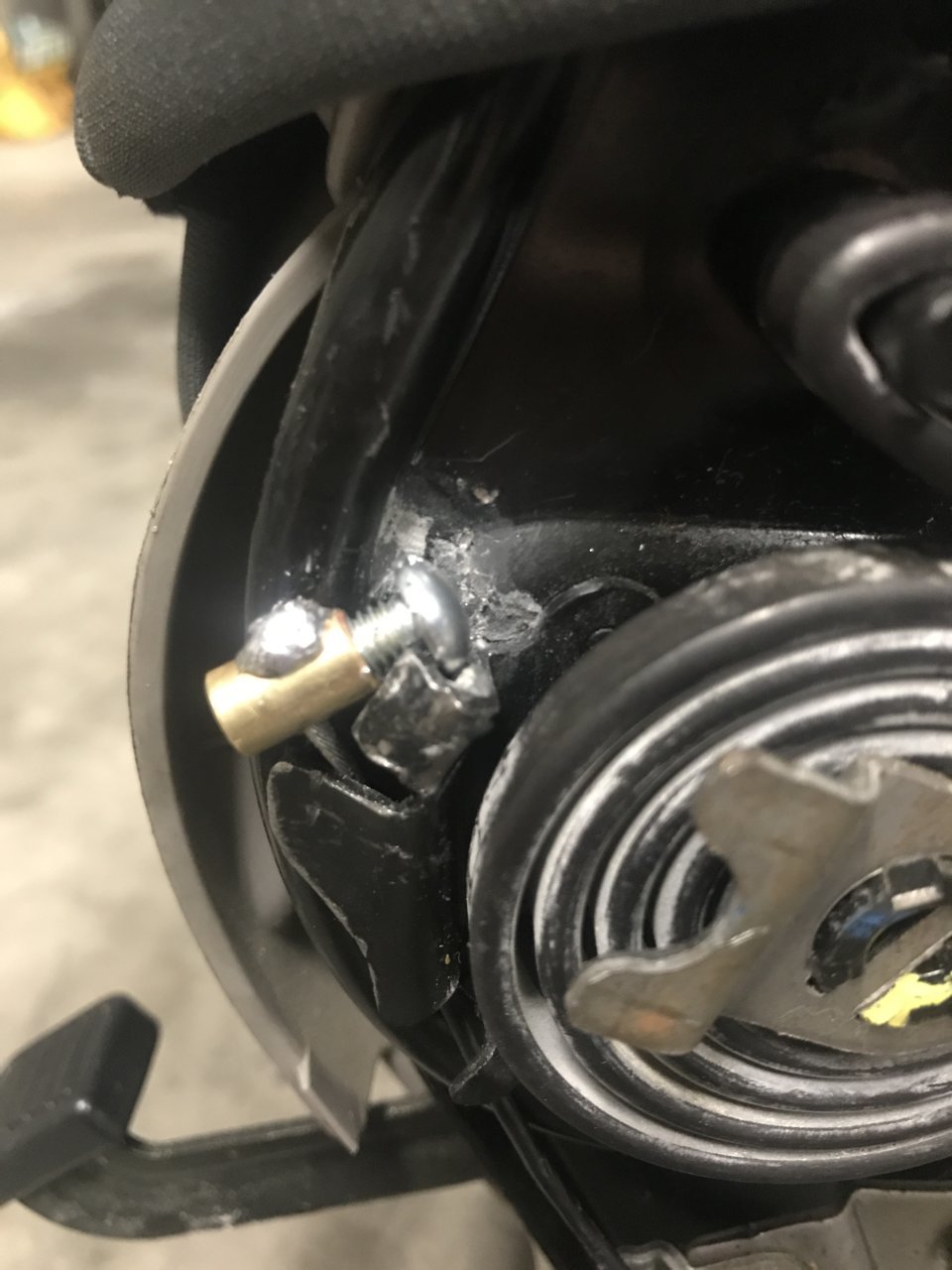

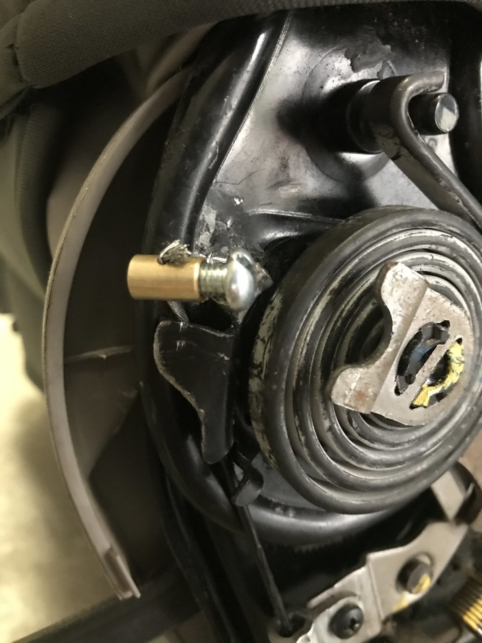

    Ghetto fix of the month. Seat moves forward again when I use the lever.

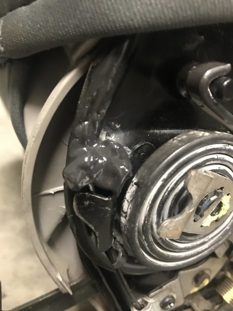

    Decided to solder the end and the slather it all with JB kwik.
    Got everything put back together and teated a few time and it works. Hopefully it holds.

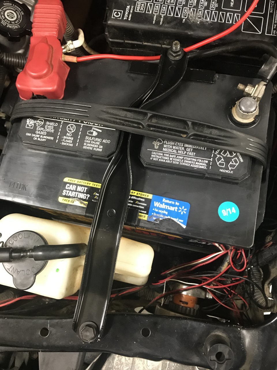

    New battery hold down. I know, riveting stuff on this build thread.

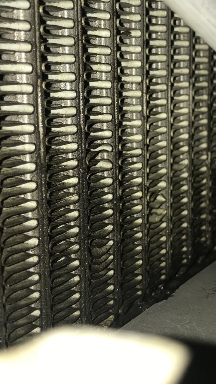

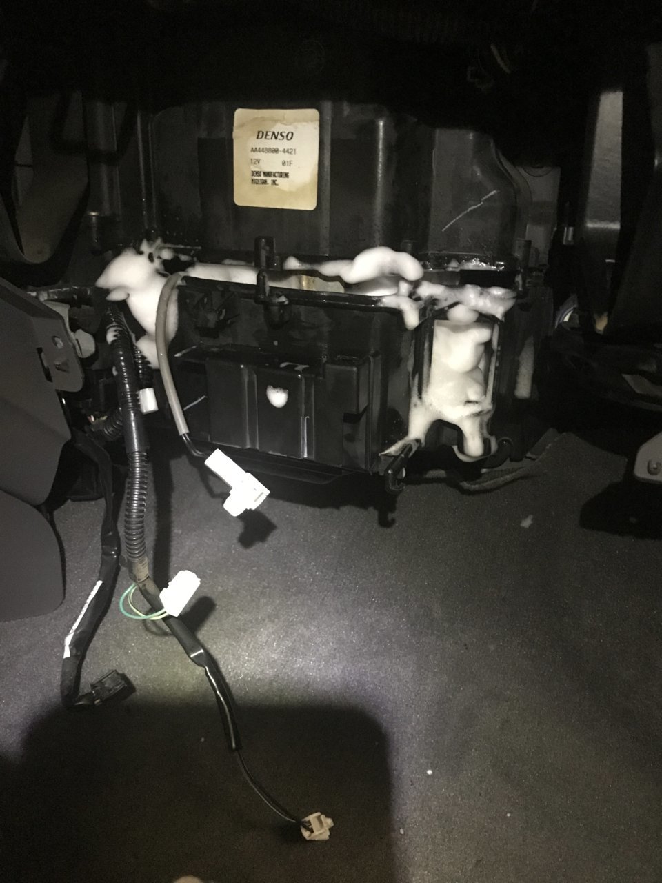

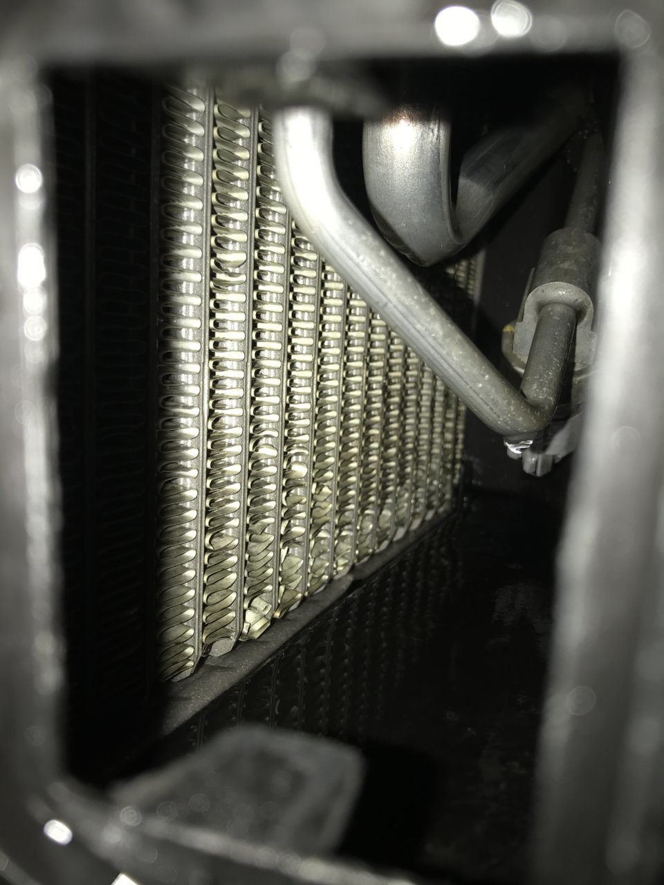

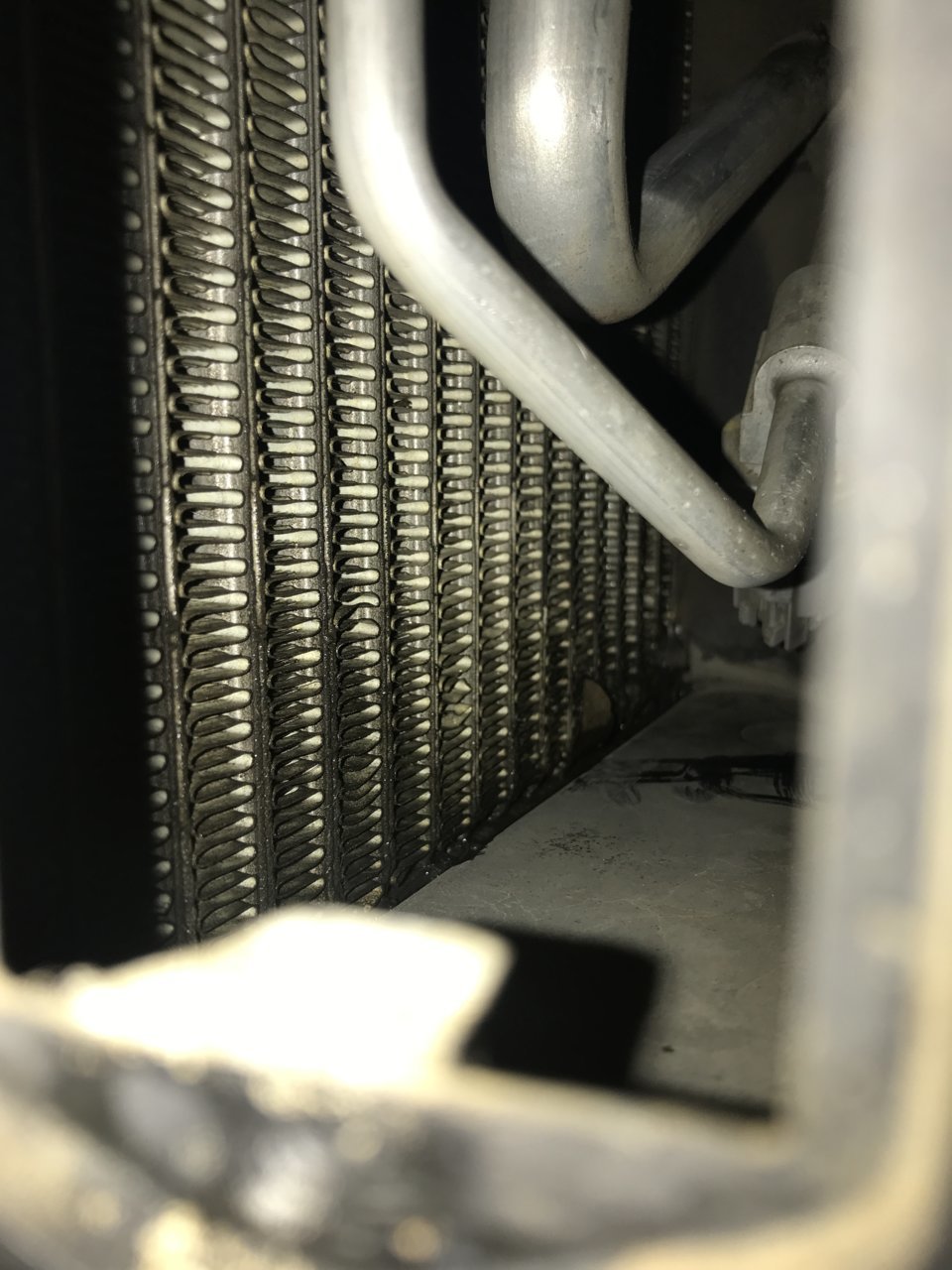

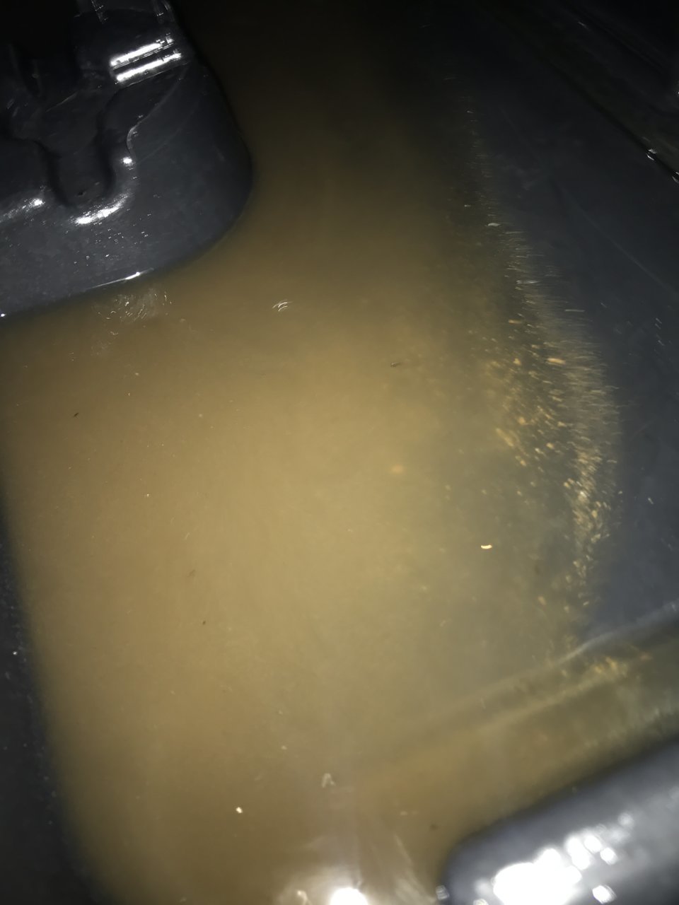

    I'm cleaning my evap coils tonight and vacuuming up what I can.
    Here's what I caught in the pan.
    More discussion here:
    https://www.tacomaworld.com/threads/vacuuming-evap-housing-to-remove-debris-possible.554506/
    Hoping whatever the hell was rustling around is out of the evap casing. It's been driving me nuts for about 4 years now, if not longer.
    https://www.tacomaworld.com/threads/weird-and-extremely-annoying-rattle.342855/
    https://www.tacomaworld.com/threads/please-someone-help-me-with-this-rattle.376774/
    https://www.tacomaworld.com/threads/truck-smells-like-rancid-gym-sock-after-rain.387269/
