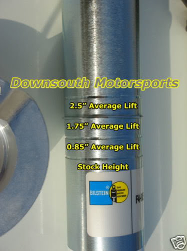

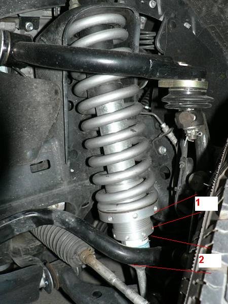

    The shock should be on the lowest setting (0 is closest to the Bilstein label on the shock) not the highest (2.5). The only way to adjust the shock's clip is to remove them from the coil. The adjustable collar (that you use to adjust the coil height) rests on the clip so there is no way to adjust the shock's clip with the coil on. You'd need a spring compressor to take the coil off first. Be careful with a spring compressor. Those things can be dangerous. You might just take the whole coilover out and take it to a shop that has one and let them do it for you.
    Here's a shot of my Toytec Coilovers. I don't have a measuring tape with me so I'm just using my fingers. The distance of #1 (the thread under) is about 2 fingers (~1"). The distance of #2 (from the bottom of adjust collar to the bottom of the shock's main body before it curves) is about 3 fingers.
    I believe that Toytec changed the assembly and how it sits on the clip after I received mine (I bought mine when they first came out).
    If you received the entire assembly from Toytec (ultimate kit), it's likely that your setup is already correct.
    How high is your setup? Mine measures 22.75 from the middle of the hub to the fenderwell (I measure from the hub because it takes tiresize out of the equation).

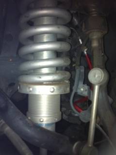

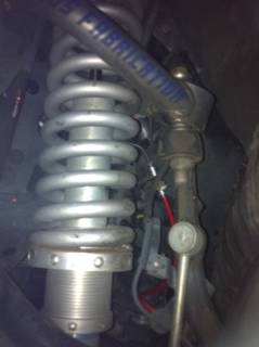

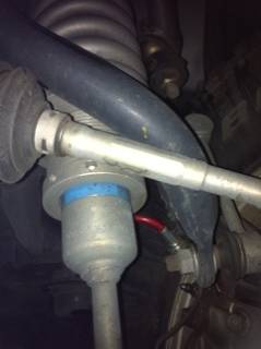

    Here's my current setup. harsh ride. comments?? looks like springs are overtighten huh?? Thats how i got my lift. so you think i should adjust my shock clips now??

    How much lift do you have? That looks pretty high up the collar. If you have a tape measure, measure from the middle of your hub to the fenderwell (straight up).

    I think your coils are way too high. You need to drop them down quite a bit. Based on your measurements, you're about 1 3/4" higher than mine are set. I would drop them down to 23" max. Mine are set at 22.75". I think your clips are fine.
    http://www.tacomaworld.com/forum/2nd-gen-tacomas/59473-post-your-lifted-height-measurements.html
    The instructions for the Toytec Coilover state that the bottom of the coilover adjustment should only have about 1" of thread showing for a 3" lift. You've got to be sitting about 4" or more. That's probably why you're riding rough.
