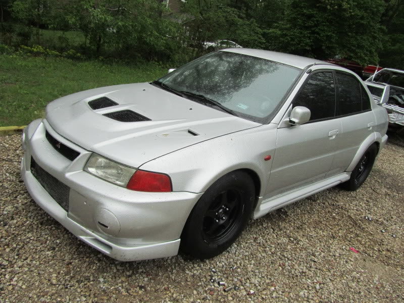

    I customize in Mitsubishi Lancer Evolution 8/9/10s. I made a business out of them and at 21 years old its been great. I learned the Trade and started the business on my own.
    This is my personal Car
    698 Whp
    th_FRONTANGLE_964e09c2d50b8a2280776d5643bac773769e3e1b.jpgAnd My 1999 JDM Evolution 6 (Imported from Poland)
