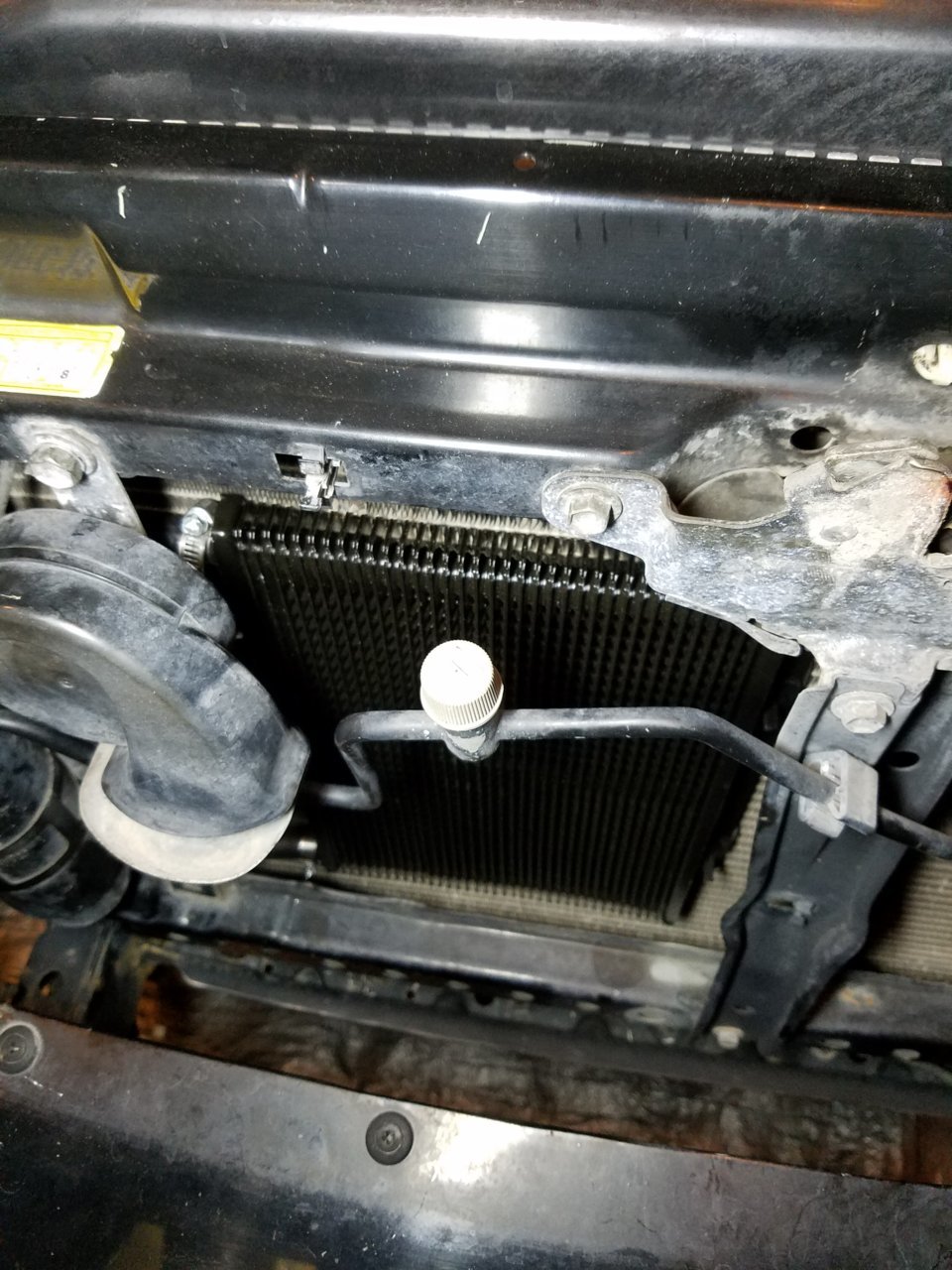

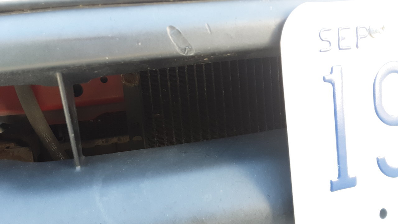

    I just installed a B&M 70268 cooler on my 3rd gen 4runner. I assume it would fit the 1st gen tacoma as well.

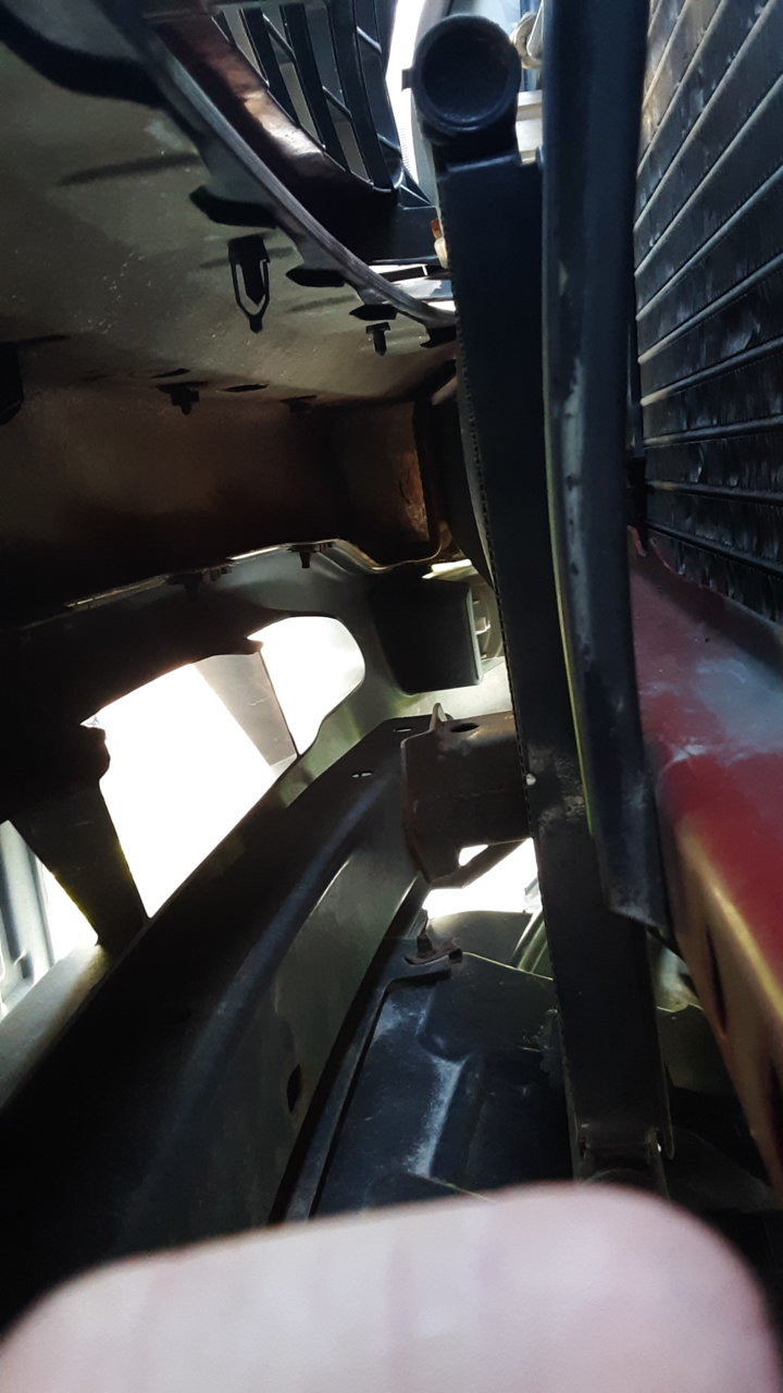

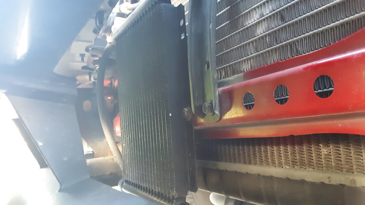

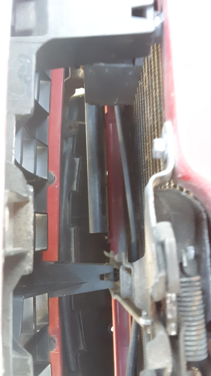

    Haha it was a struggle. If you take the bumper off it would be easy, but I was able to shimmy it back there without damaging anything. I think I used a thin piece of plastic behind it to keep it from stabbing the AC condenser.
    I also flipped one of the AC line mounts (the rusty looking one) to push the tube out further.
