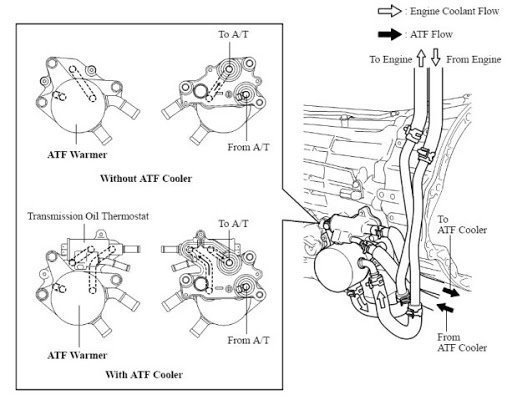

    Here is Toyotas fluid flow guide ...Look at page 8 on this PDF http://www.toyotatundraforum.com/pdf/A750E.pdf

    A HUGE COST SAVING FOR TOYOTA .
    Apparently your brand new truck with the tow package no longer needs a transmission cooler o_Oo_Oo_Oo_Oo_Oo_Oo_Oo_Oo_Oo_Oo_Oo_Oo_Oo_Oo_O?????????? . READ BELOW
    One thing I absolutely hate about the third generation design . You guys have a transmission fluid pre-heater that is mechanically controlled . The pre heater is designed to warm up the transmission quicker in the mornings on initial start up .
    When the pre-heater is active , transmission fluid dumps out of the torque converter and reverts directly back to the transmission pan instead of flowing through the transmission cooler .
    You guys are relying on 1 mechanical valve to always function properly . What would happen if that valve failed and you continued to drive your truck ?

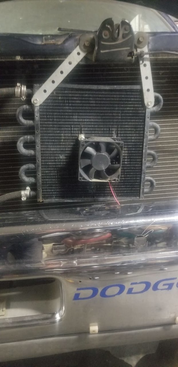

    towing a light trailer with a vehicle not designed for towing, even an empty trailer causes the TCC to stay unlocked when driving on a slight incline. I have seen this happen more than once. The converter turns blue and the fluid turns clear. The customer brings the car in because the check trans light is on. $$$$$
    The picture below shows a cooler with a fan . Horrible lol

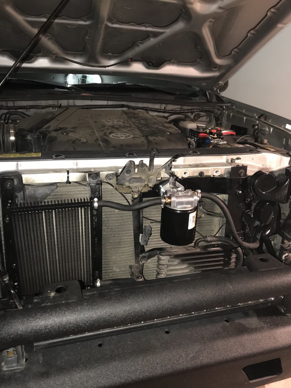

    I am running an external filter and a larger-than-stock external cooler.
