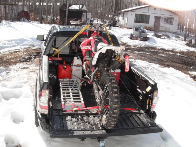

    Picture of my setup

    is your front tire against the front of the bed ?

    Yes.
