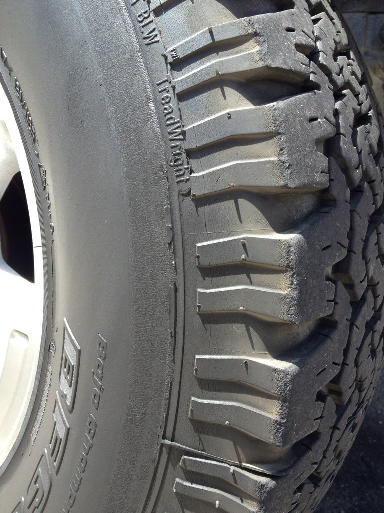

  12. Apr 20, 2012 at 2:51 PM
    #152
    Relik
    Relik Well-Known Member
    Nov 8, 2010
    #45891
    602
    Eddy
    Thousand Oaks, CA
    '11 TRD Sport PreRunner-Auto-Magnetic Gray
    Bilstein 5100s (Front & ext. Rear), Eibach coils @ 0, MaxTrac 4" Spindles, Light Racing UCAs, 1/4" lean spacer, All-Pro 3" Standard leafs, u-bolt flip kit, SpiderTrax 1.25" wheel spacers, 33" (285/70/17) TreadWright Warden A/T tires, extended lines
    I got these but in 285/70/17s. If you order them just be sure to mention you want all BFG All terrain cores, just incase so you dont get a matched set. They are fine with special orders. They try to match them, but if in a rush they might send one or two different from what I've seen online. My set looks just like the BFGs, but you can tell they are retreads if you looks closer. It is half the price for the set tho compared to the real ones.
    One of mine started to get a crack on the side, but doesn't seem to be an issue. I can't post a pic cause photobucket's acting funny. I'll post it later...You'll be able to see how the tire looks from side

  14. Apr 20, 2012 at 3:33 PM
    #154
    Relik
    Nov 8, 2010
    #45891
    602
    Eddy
    Thousand Oaks, CA
    Here's a recent shot, you can see the BFG core and the retread that says Treadwright.

  16. Apr 20, 2012 at 3:40 PM
    #156
    Relik
    Nov 8, 2010
    #45891
    602
    Eddy
    Thousand Oaks, CA
    Here's more pics of the cut/crack I recently noticed on one tire. The second one is of other tire. I can't confirm if its been cut, or if it cracked with the recent heat....
