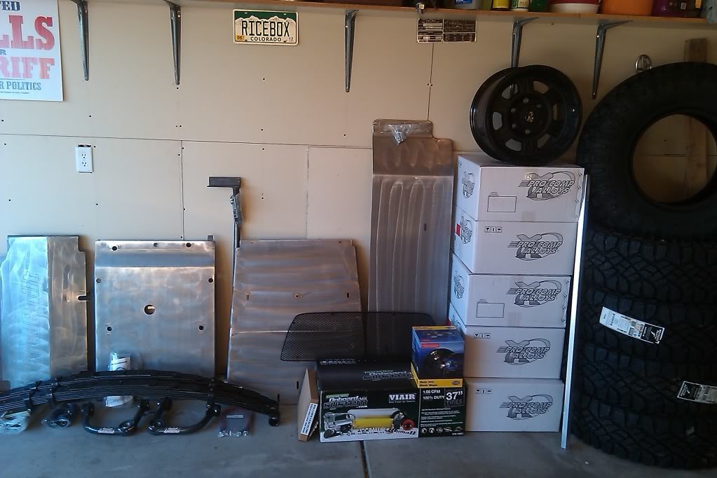

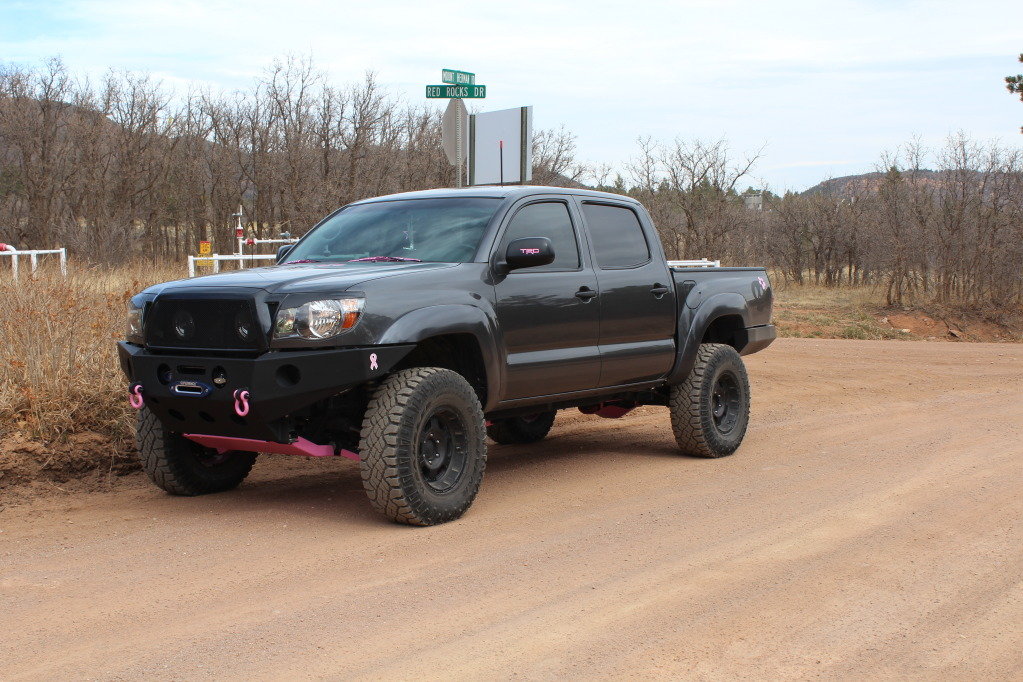

    We traded my wife's Scion Tc in for her Tacoma in January of 2010. Our plans were to put a cheap lift and 285's and call it done. After taking it on a couple wheeling/camping trips we decided that we liked it a bit better for that purpose more than my Jeep. With a 14 year old and capming gear the Tacoma just makes more sense. I sold my Jeep since we really don't need 2 trail ready vehicles. Now the Tacoma must be built to be a go anywhere do anything truck. So after tons of research, saving and planning here goes the build.

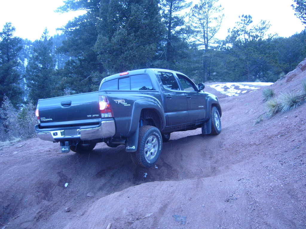

    Here it is a weekend or two after we bought it.
    After that little trip we found out the mudflaps had to go. Started researching and found this site and all of the free mods. So we took the mud the mud flaps off, de-badged it, relocated the 7 pin, and tinted the windows. Soon after we planed a trip over Medano pass. It crosses a river 9 times so I knew this was in order http://www.tacomaworld.com/forum/2nd-gen-tacomas/15686-diff-breather-mod-dummies-pics.html

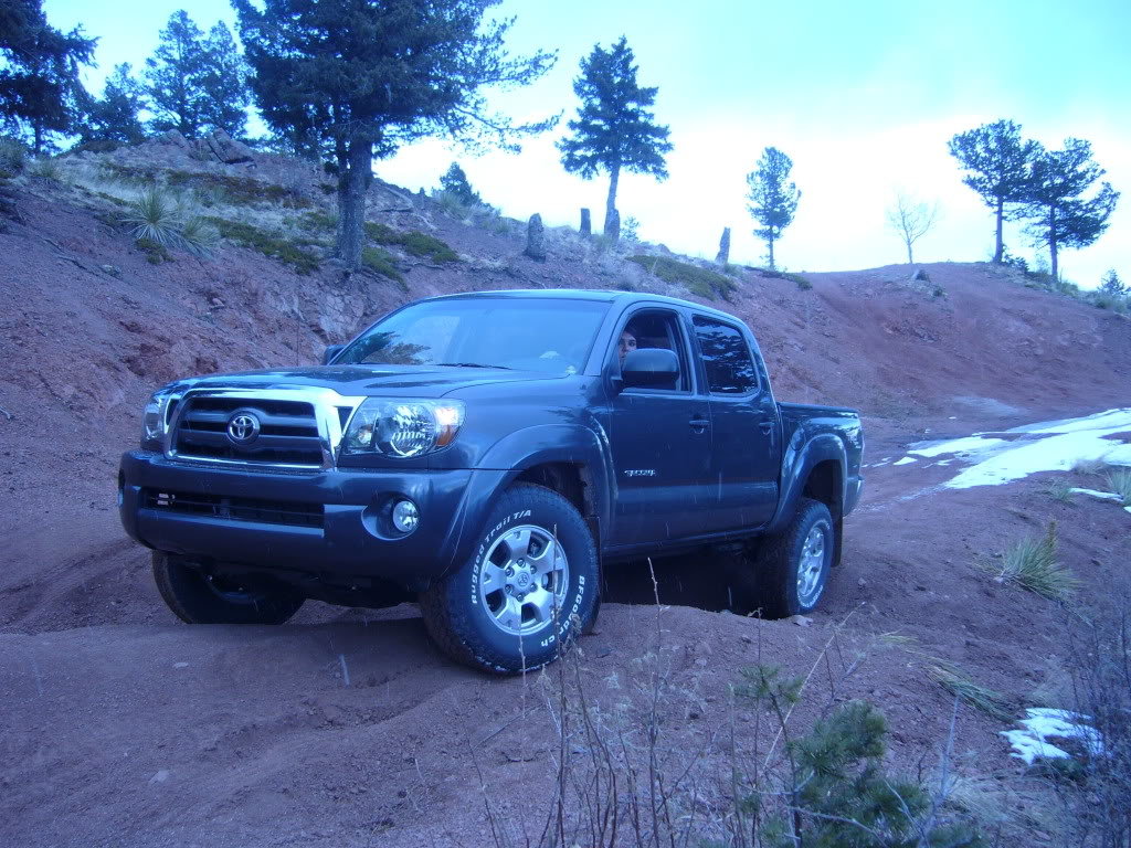

    Pics from that trip
    We took advantage of the Wicked Flow group buy and did the y-pipe mod for when we got skid plates.

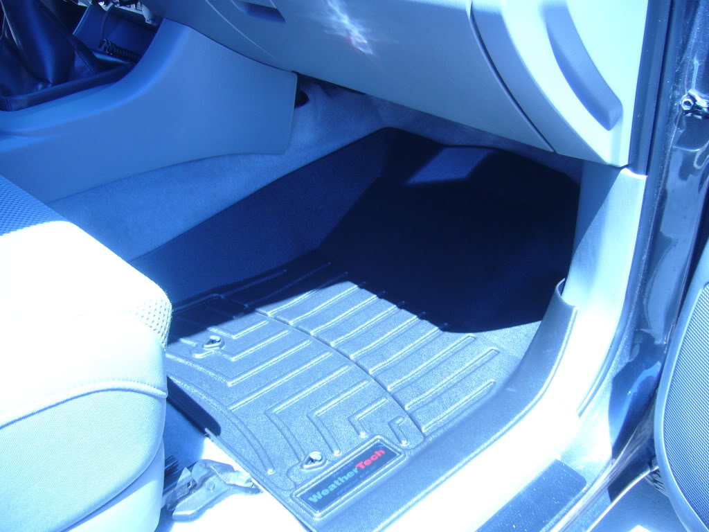

    We also got on the Weathertech group buy too, gotta love the discounts!
    And thats how she was till today!;)

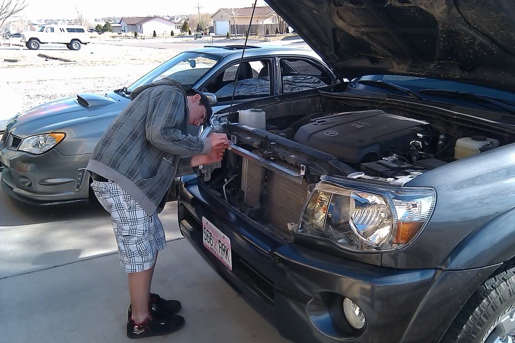

    Today my son and I took the grill off and used these great write ups,
    http://www.tacomaworld.com/forum/li...nversion-mount-behind-satoshi-how-w-pics.html
    Just the light install not the HID conversion.
    And this one too.
    http://www.tacomaworld.com/forum/2n...atoshi-grill-horn-relocation-w-lots-pics.html
    Both are great write ups! thanks guys!

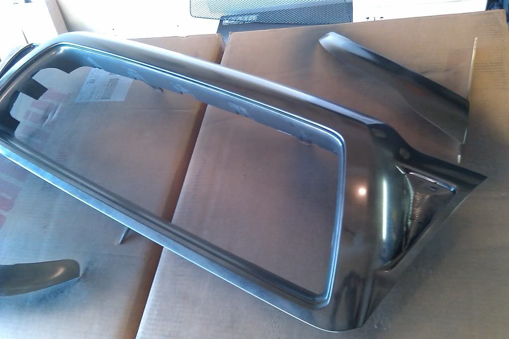

    We also started cutting the grill apart for the Grillcraft (sorry no pics) more on that tomorrow after we help some family members move, awe the joys of truck ownership!

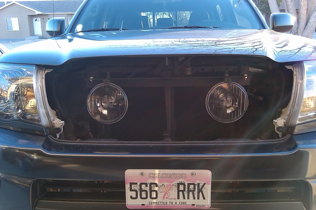

    Today we painted the radiator black and mounted the Hella 500's. Haven't wired it em' up yet, still waiting on an auxiliary fuse box to come in.
    We also finished cutting up the grill and prepped it for paint. Painted the grill surround and eyebrows base coat and will spray the clear tomorrow.

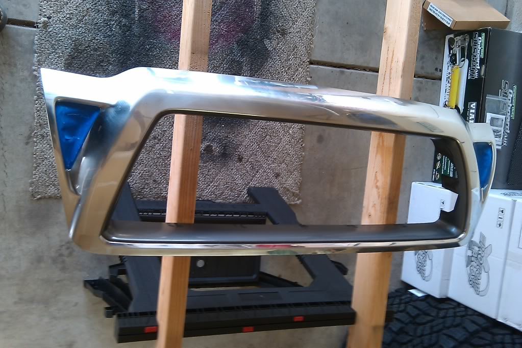

    Yesterday all I did was spray the grill surround and eyelids in clear, nothing worth taking pics of!. Today we put in the Grillcraft and reinstalled the grill. We put the eyelids on too. Turned out ok, the color is a bit to dark though. We got this paint from auotmotivetouchup.com. I was hoping it would have matched better. If it bugs me to much I'll just get a pint mixed up at the paint store and re-spray it. They said there was 11 different mixes for mixing the paint so it must be pretty hard to match.

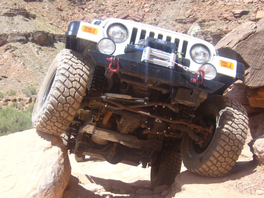

    I drive a 07 STi limited. Sold my 06 rubicon last November and picked it up. Still stock except for a couple cosmetic mods I'm working on. I miss the Jeep when I look at some pics of it, but it all goes away when I get behind the wheel of the STi!
    A couple pics of them.

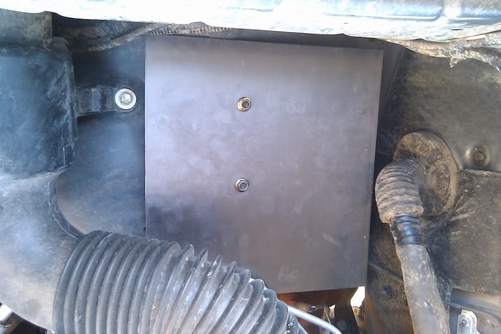

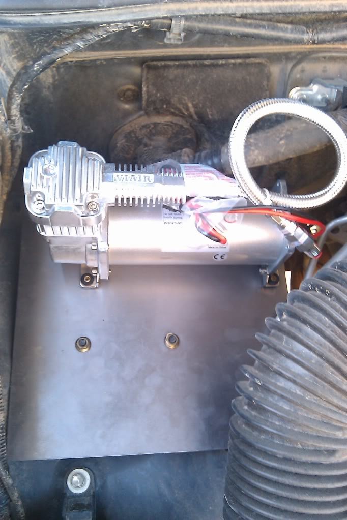

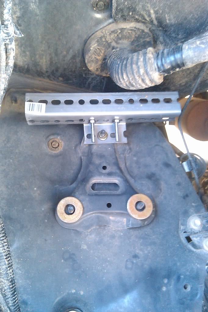

    Today I started to build a platform to mount the compressor and auxiliary fuse box. I decided to use the space over the passenger wheel well. I used a 12"x18" piece of 16 gauge (cut to 12"x11") and a 12"x1 1/4" 14 gauge slotted angle and some washers for spacers. I will finish it up when I get the auxiliary fuse box in. Yea I know i need to wash the engine bay! :D

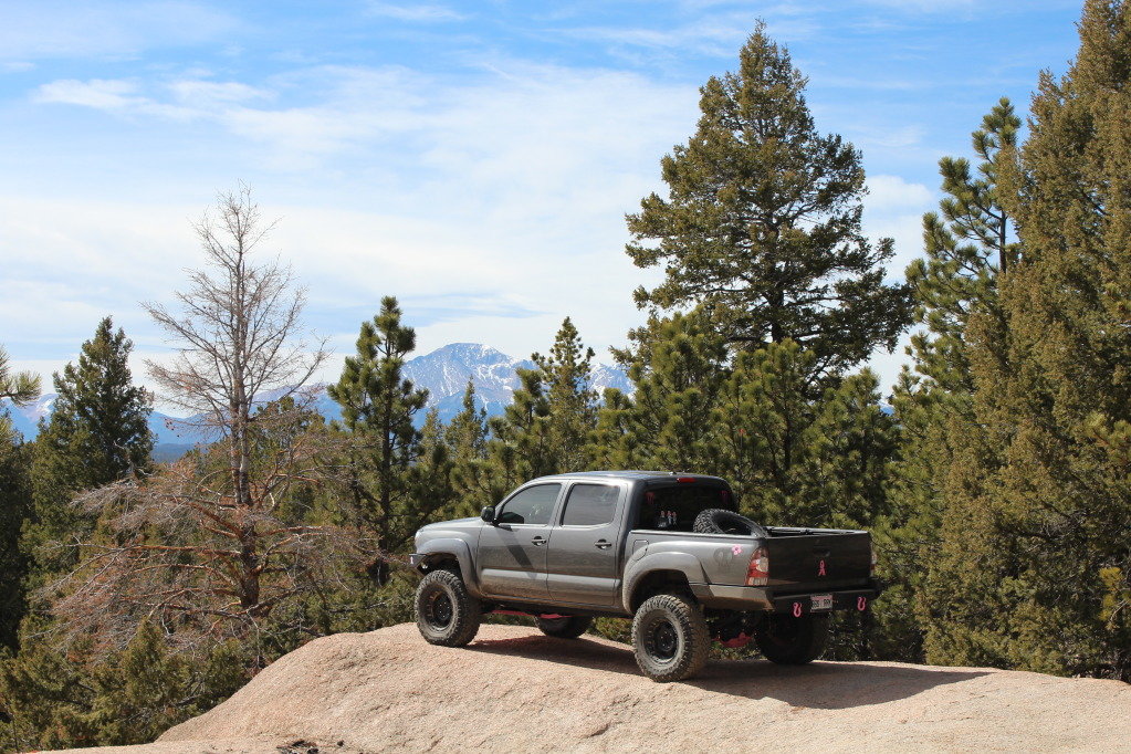

    Where did those skid plates come from?
