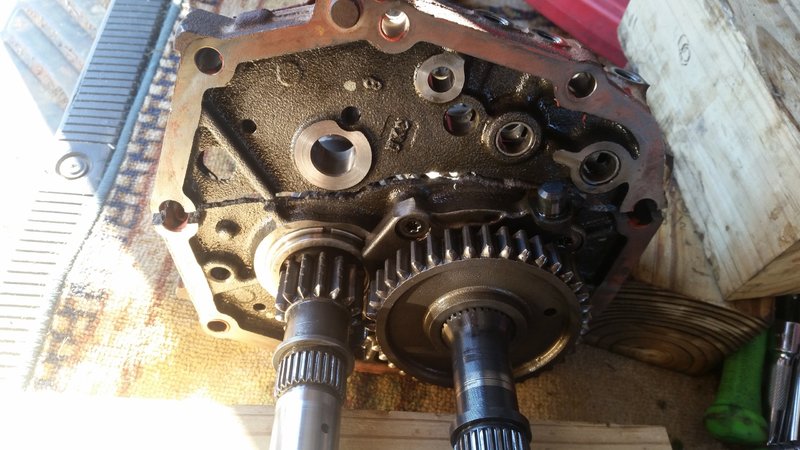

    Well I got 5th gear off :anonymous: so does anyone know or have a intermediate plate for sell?? Where could I get 1 without buying the whole sub assembly?

    Damn that sucks. Happened while pulling the gears?

    5th gear didn't want to come off but when it did it came out with the blaze of glory!!!(which I did get the gear off unharmed) I have found some housings for about $600 but i think id rather pay $1100 with a $250 core for a reman with warranty, instead of paying $600 for just the housing plus the $250 for bearings and seals!

    Sorry about the late reply . I . have repaired many of these transmissions . Have you called around to trans shops in your area ? Those intermediate plates should be a dime a dozen by now . Jeeps used the same trans if that helps . May want to talk to the jeep guys as well

    That helps a lot!!! I cant find just the plate have to buy the whole housing which is costly!! If I cant find then I will just buy reman!
