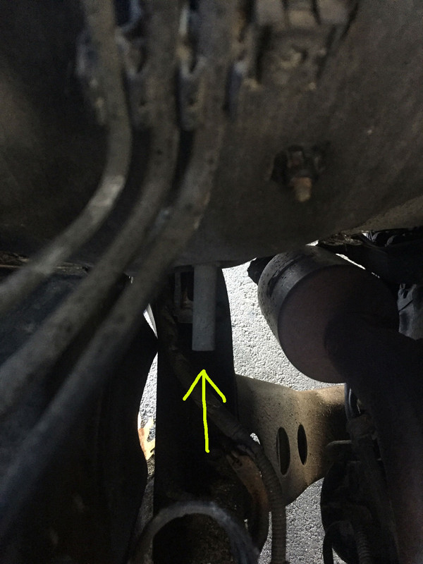

    ...and if anyone can confirm- I'm assuming that this is the A/C drain? This is the passenger side firewall-

    Sounds like one of your passengers pee peed

    photoguy[QUOTED][OP] likes this.

    Think Id better go wash my hands :eek:
