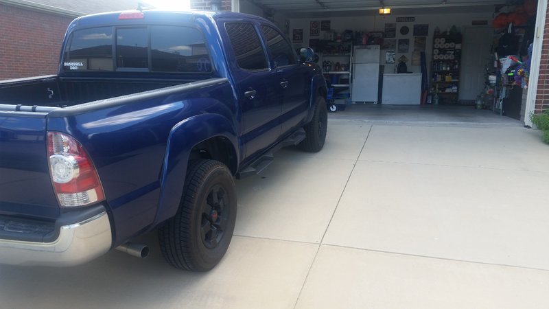

    Went from this:
    To This:

    Hypothetical yes they will fit no rub. Might want to check the hub bore since out trucks are hub centric and before you mount or buy anything, make sure they clear the brake calipers.

    But I should be good if its 4.5 right?

    Typically yes. All wheels are shaped a little different. Are you buying online or something?

    For example if it has a big outside lip which would make the "spokes" for lack of a better term, flat they would rub. If they don't have a huge outer lip then you should be good

    Should be no issues with stock 265/70-16 (31") tire size. Will probably rub the fender flare plastic with 265/75-16 (32") tire size at full lock. 265/75-16 normally clears stock wheels (5.25 BS) with no rubbing.

    They'll both fit. I would have gotten 4" bs instead of 4.5" if I could do it over again. I guess I could do it over again just have better things to blow my money on right now :)

    OMG...love the look of these. Totally changes the truck. I can notice the slight difference in offset too.
    Also for those who are curious....wheels/tires are 16" Toyota FJ Trail Team with Toyo Open Country AT2 - 265/75/16 LRC - No rubbing whatsoever.

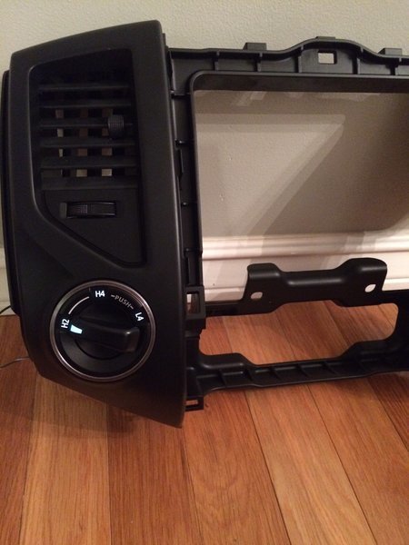

    If you've been thinking about doing the Hilux lighted 4x4 switch now is the time! Click Here to get the machined ring that allows it to fit properly into the bezel

    Is there a writeup thread on this somewhere? I haven't seen anything about the Hilux switch...

    Ya ill see if i can find it. Its basically a blacked out 4x4 switch that light up
    From @nazlax10 build
    Terminal connectors- P/N 82998-12420. It comes with two connectors with wires so you only need one order of them.
    Then follow this thread step 11 to the end for wiring.
