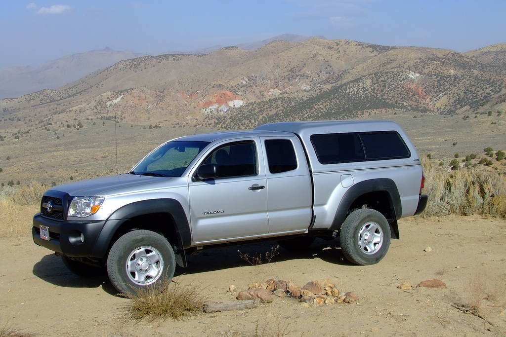

    And yes stock tires will look funny on a lifted Taco. 265/75/16s will look good on a stock to 3" lift.
    Stock tires with 3" lift

    My top pic shows stock tires & the MGM pic shows the 1" larger.
    I thought mine looked funny with the stock tires, but ran them when I was commuting 280 to 350 hilly miles/week with my 4Banger.
    Same Taco & tires now with 3" lift, bumpers & winch, sliders & skids and he's in the process of cutting it up to fit 35" tires.
