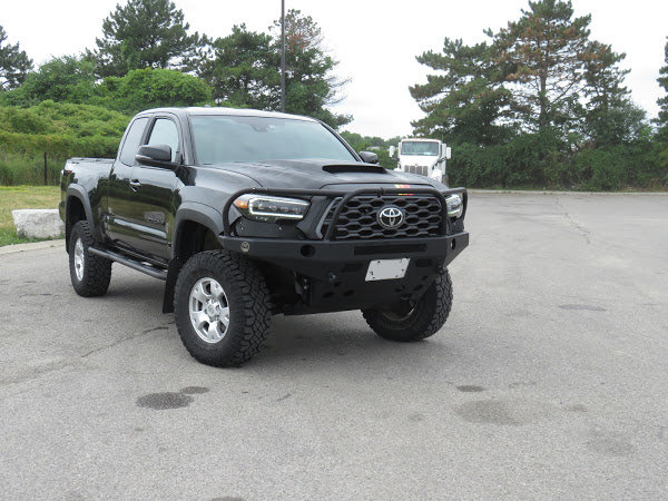

    Pelfreybilt 2nd gen bumper
    2.7" suspension lift + 32" tires + 2020 grille swap means radar is 3.6" higher than stock. TSS works with no errors.

    4rlgfaVs703M-4CZKo3Fw-1e3MooqKbhudvLBCrd_f774cc2f7807b59ed371b783b09020d8d5dcc29c.jpg

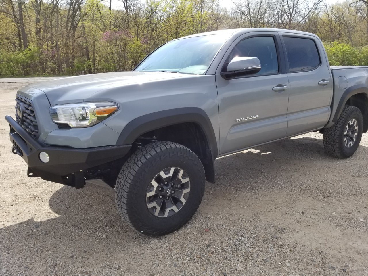

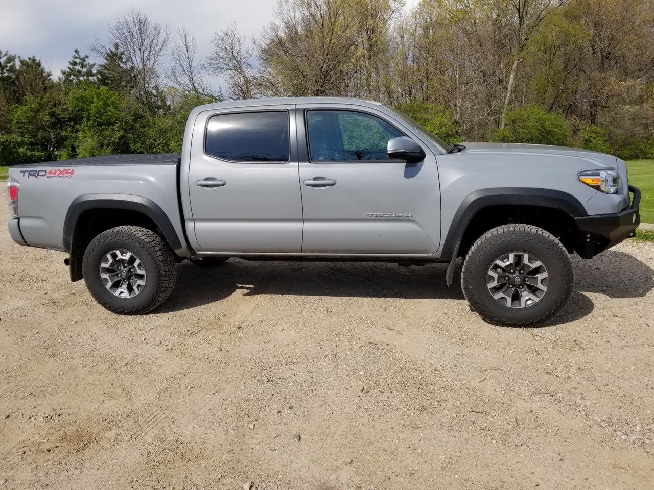

    CBI T3 mid hoop (baja) still working fine with TSS. So far no issues at all after ~3 months and 2k miles. I redid the zero pt cal for VSC recently, basically just because I got TS working.
    I would say go for it, lifting front without something like rear aal is probably more likely to piss off the sensor due to zero pt. The bumper is fine on stock OR grill TSS.
    I cut but recently saw some replacement bumper caps that basically fill in that little section of bumper you normally keep, something to consider. Would still have to cut the fender flare.
    https://www.tacomaworld.com/threads...ements-where-do-you-cut.726392/#post-25878795
    and overdue pics
