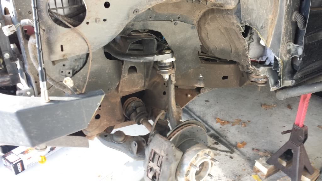

    This thread is to help 1st gen owners on any questions that they may have on fitting 35's on a 3 inch suspension lift. I've recently did this and know that it would help others. Here are a few builds that I am aware of. Please post any other builds to the thread and I'll update the original.
    I'm sure if you send any of us questions we would be more than happy to help
    This link really helped me out.
    http://www.trailslesstraveled.com/article/clearance-for-35inch-tires-on-a-tacoma-at-any-lift-height/

    Keep in mind unless it's a body lift, you're going to have the same fitment problems you'd have at stock height if you ever turn and/or compress your suspension. :)

    so with a 3 inch lift, i also need a body lift? Im doing research over in the lift FAQ thread

    No, you do not need a body lift. You just have to tub your inner fender well.

    I have a lot more pictures to folks of the tubbing if anyone needs! Just post up and I can try and help out as much as possible!!

    If you dont have the means to cut and weld, I used a sledgehammer to tub mine and sealed it back up after I was done.
    Works fine. Dont hit the soft part hard, I put a hole in mine and it was a bitch sealing it back up.
    I also have a 1'' body lift.
